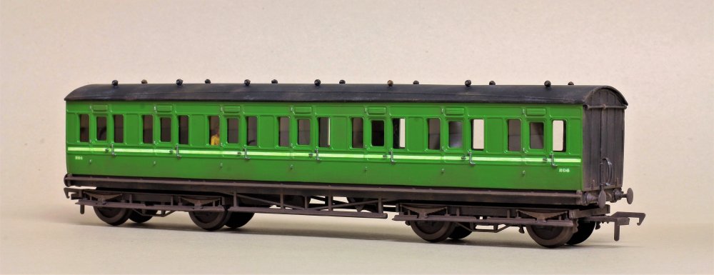

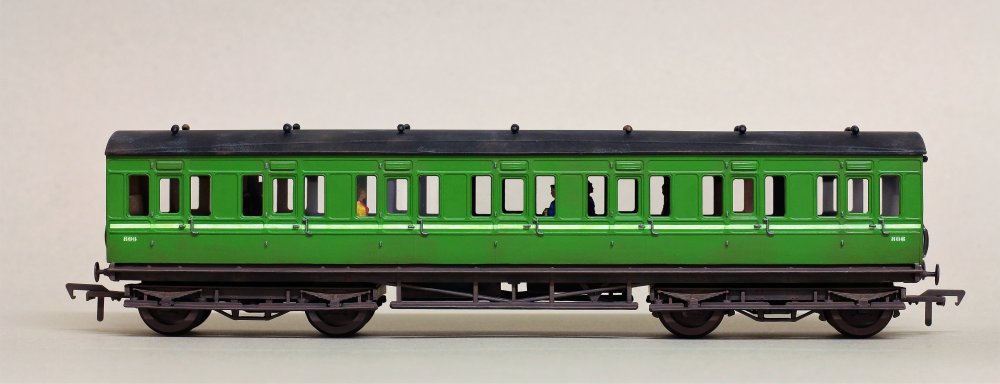

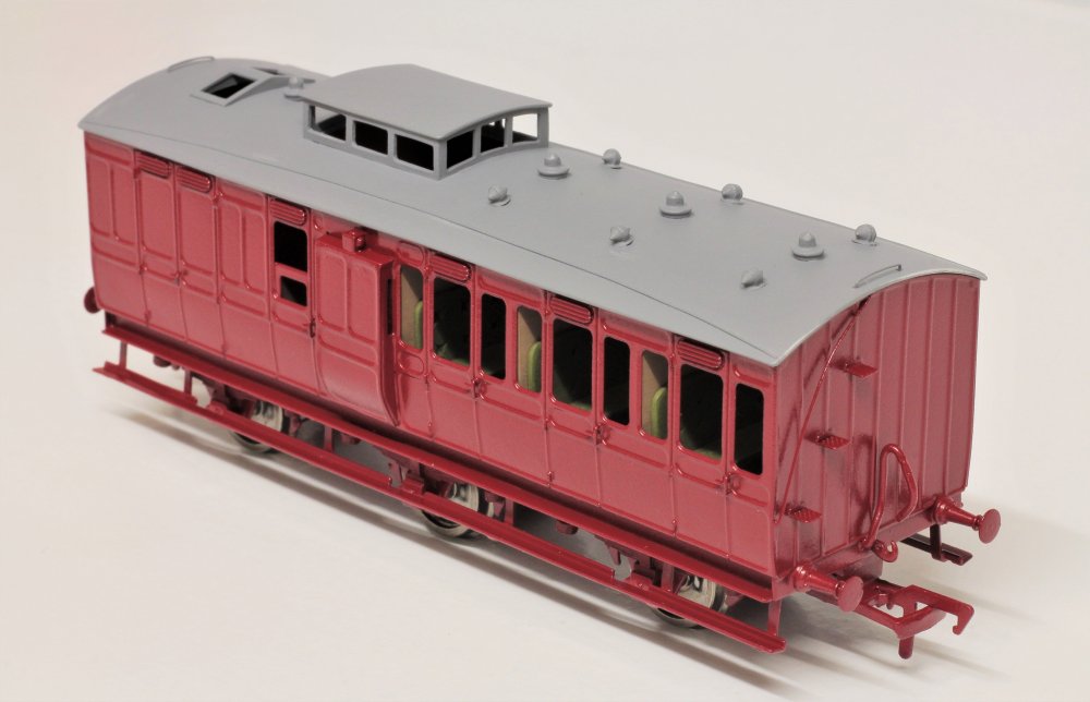

Popeye, believe it or not you've done exactly the job I was thinking about! (Great minds think alike?)..
Now, I am doing it for certain, and hoping it turns out half as good as yours! This era is currently very neglected despite being arguably the mos interesting and varied in Irish railway history.
If you take the bow-ended style, used commonly in Britain but ONLY by the WLWR here, and look at Ratio kits, if you take their brake third, keep the curved end, and splice on two compartments from a full passenger coach, you've a very nice WLWR brake third which lasted until - I think - about 1955.
Somebody here joined two Hornby "Thomas" coaches a while back to make a vaguely GSWR vehicle. It looked amazing - I was thinking of that too.
I have a list somewhere of potentially Irish conversions of British wooden bodies stock - must look it up. But congratulations on that one - it looks amazing!
Final thought - given the window profile and panelling, with a slightly higher arc roof, you'd get a very good DSER coach. There were few, however, in traffic after 1950.

Looks pretty darned good to me. I have limited prototype knowledge of these coaches, but they certainly look the part. Ratio kits must hold the record for being converted into something else and it just goes to show what can be achieved, with a bit of care and skill.
 Lovely job

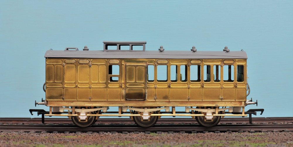

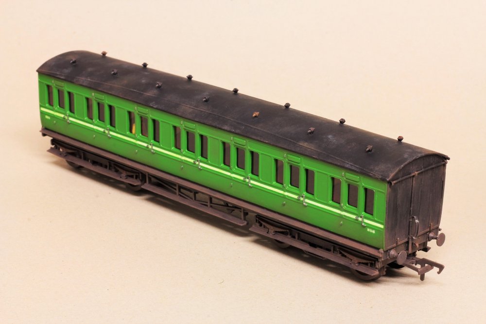

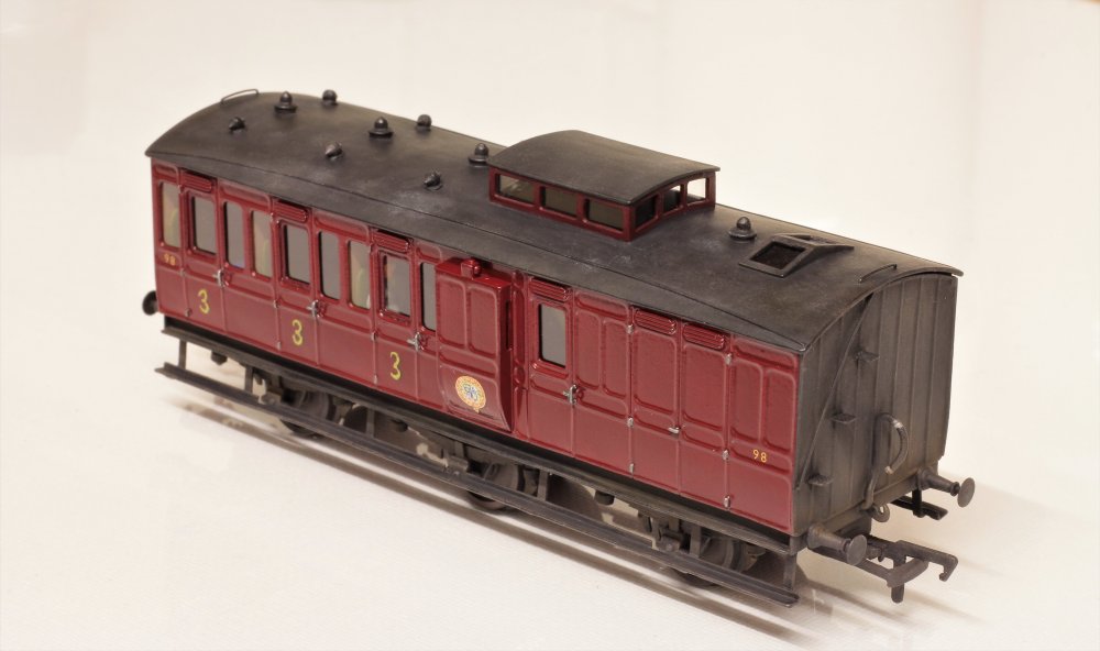

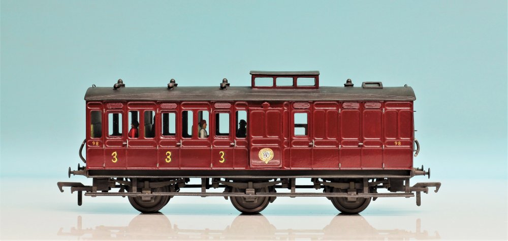

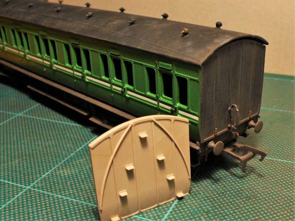

On 05/01/2018 at 10:25 PM, popeye said:
RATIO 48FT COACH.
This coach was built to be a GSWR look a like.
The ends were rounded at the bottom so this was cut off and a new piece added in.
Lovely work as always Popeye.
