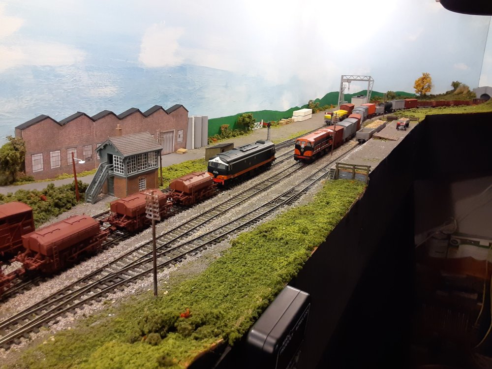

patrick Posted June 22, 2022 Author Posted June 22, 2022 Empty magnesite train on the South Waterford Line. 13 1 4
murphaph Posted June 22, 2022 Posted June 22, 2022 I was looking forward to these pics . Home turf! 2 1

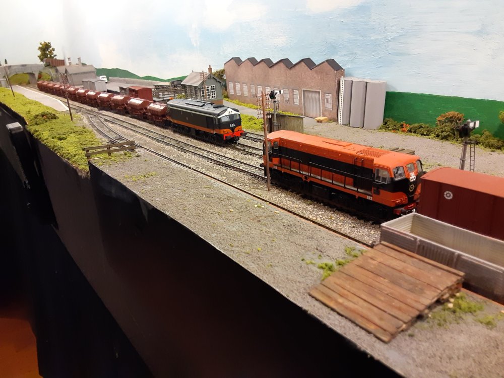

patrick Posted June 23, 2022 Author Posted June 23, 2022 An empty magnesite waits on the main while a Cork bound goods enters the loop at Glen More October 1974. 20220623_104256.mp4 11 4
