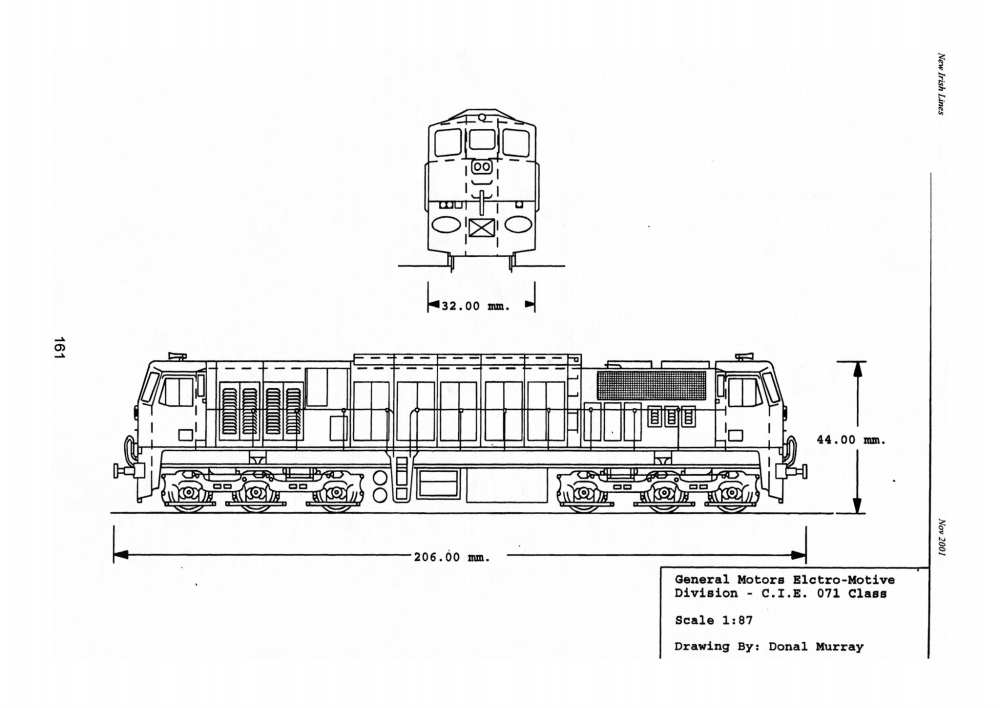

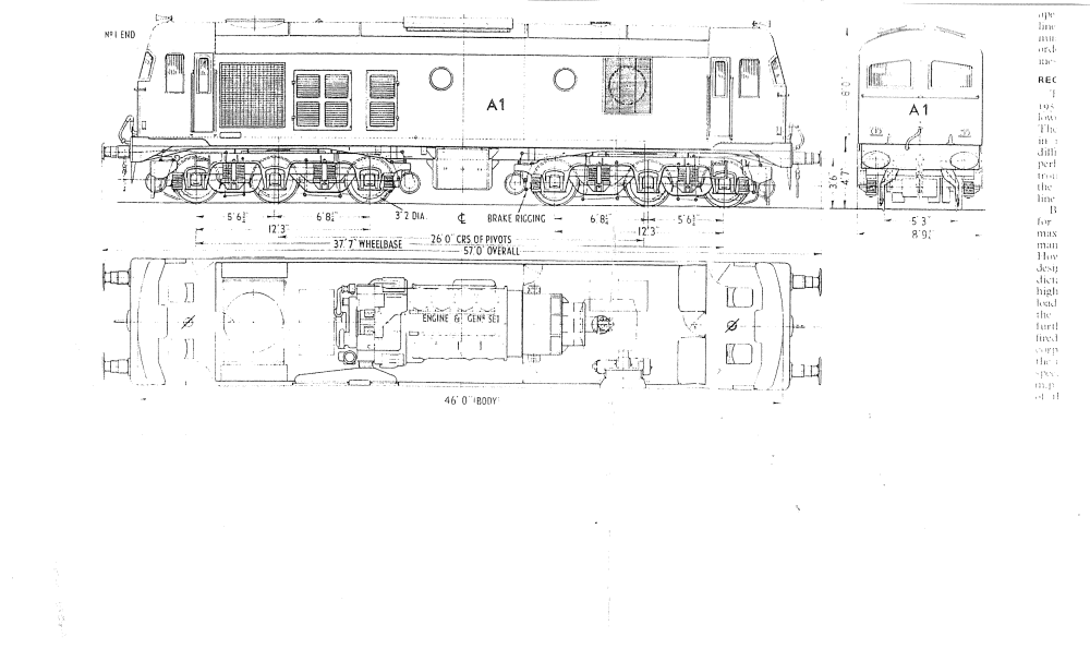

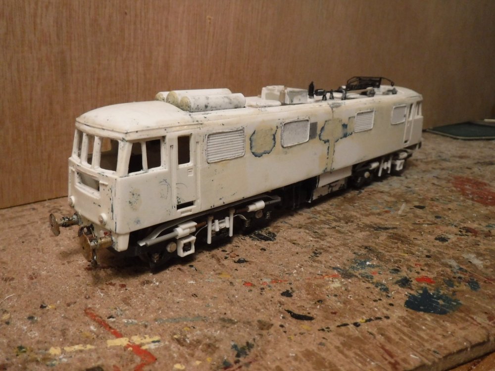

LNERW1 Posted July 7, 2024 Posted July 7, 2024 @gibbo675 giving us some brilliant examples of British to Irish conversions, has inspired me to try follow up on the 071 from a 58. Read somewhere else that Hornby considered this, but I’m not quite sure on that. I’ll look for a cheap 58 first, then a 3D-printed end. Edit: will be starting a workbench topic for this and other things, also side-profile photos of 071s would be nice, thanks.

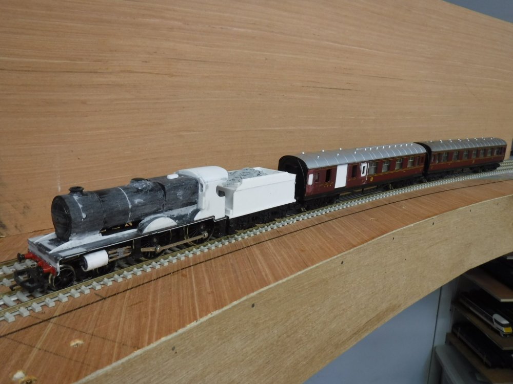

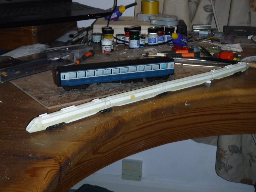

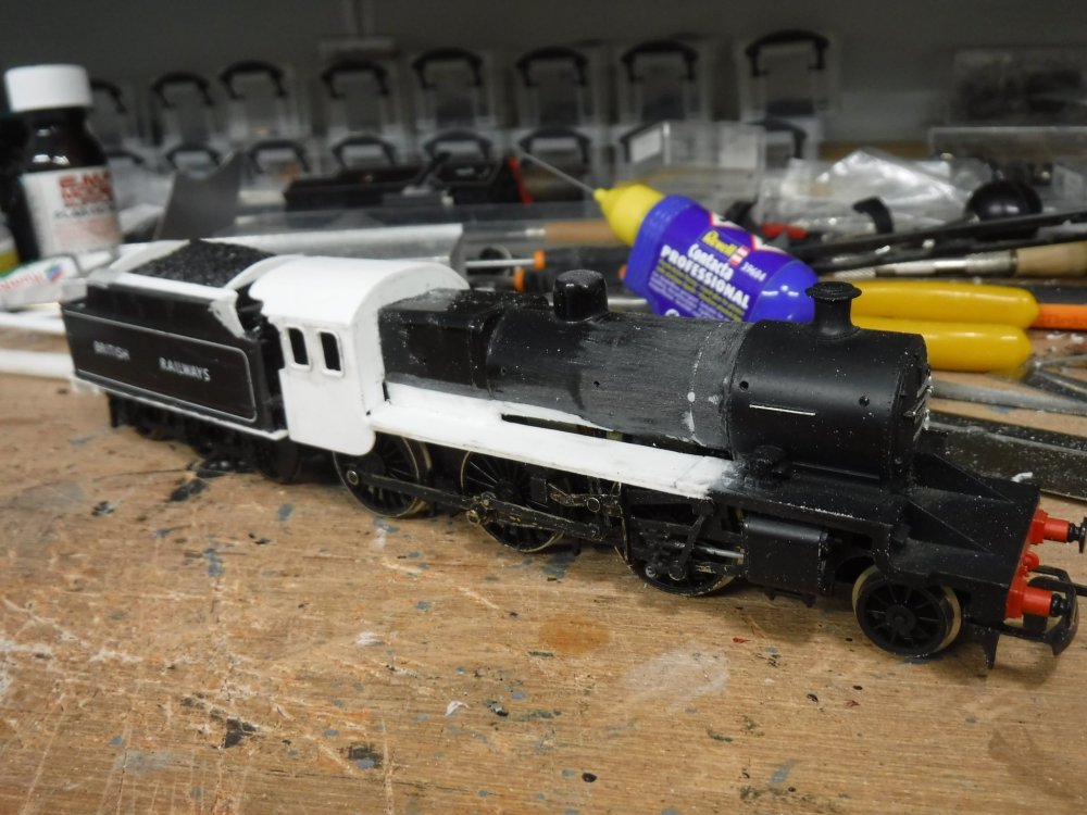

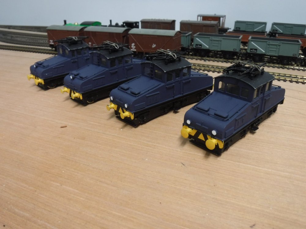

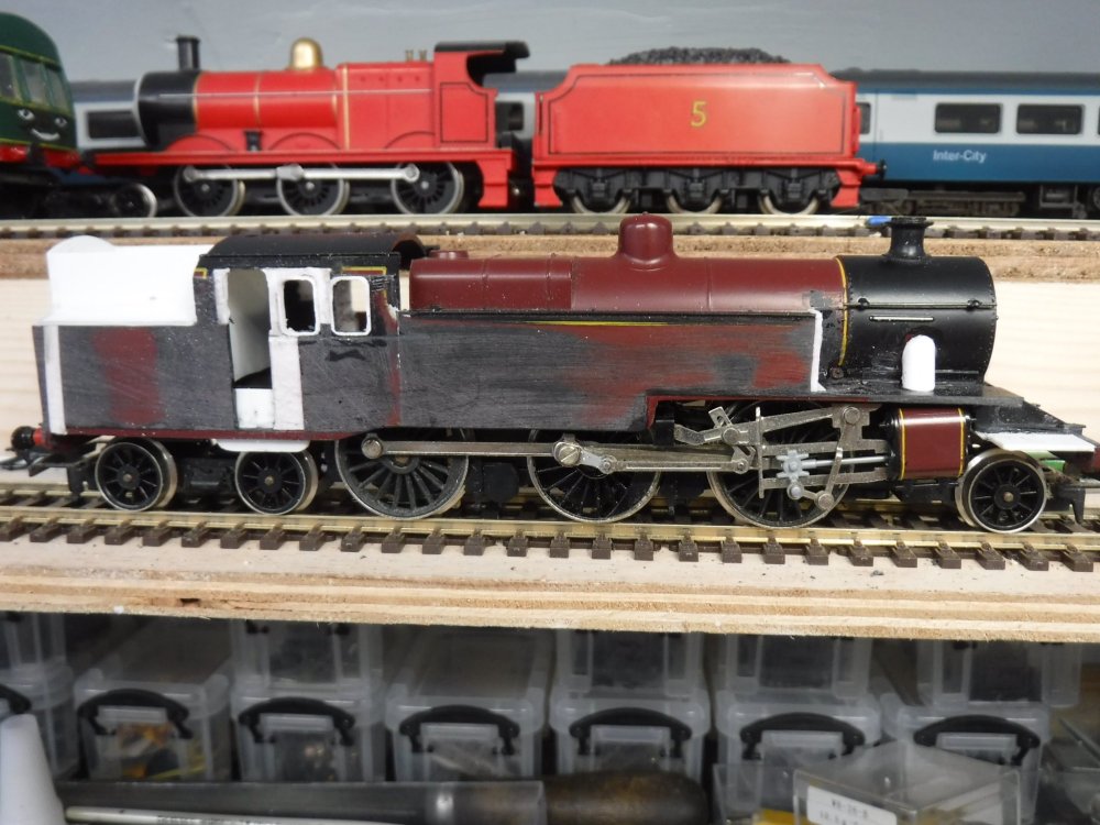

gibbo675 Posted July 7, 2024 Posted July 7, 2024 Hi Folks, As LNERW1 has quoted me here some photographs of what I've been cutting and shutting so far, none of it finished let alone painted as yet. Full descriptions in my threads which can be found by looking up my content. GNRI V class with a GNRI brake first and a composite. The locomotive is a converted Hornby LMS compound with the boiler from a Hornby 5XP Patriot and an altered tender chassis with a scratch built tender tank. The coaches are Hornby LMS Stanier coaches, the composite is slightly modified and the brake is a cut and shut from a brake third and a composite. NCC W class from a Hornby Fowler class 4 tank with a Bachmann Fowler tender chassis and the tender tank from a Hornby LMS class 4 Compound. NCC WT class from a Hornby Fowler class 4 tank. Any questions ask away either here on the appropriate thread. Gibbo. 3

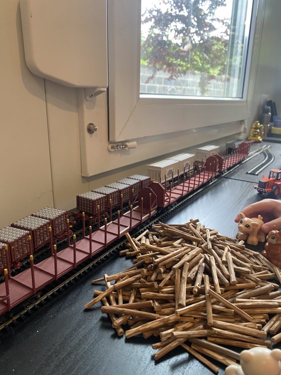

MOGUL Posted July 7, 2024 Posted July 7, 2024 (edited) Hornby Freightliner wagons can be kit bashed into 62ft 9in timber wagons by fitting ends and stanchions as pictured.. With floors only they could also pass for 62ft 9 flat wagons in PWd service. Ignore the little hand and Lego, trying to keep a toddler occupied! Edited July 7, 2024 by MOGUL 1
spudfan Posted July 7, 2024 Posted July 7, 2024 (edited) 2 hours ago, LNERW1 said: @gibbo675 giving us some brilliant examples of British to Irish conversions, has inspired me to try follow up on the 071 from a 58. Read somewhere else that Hornby considered this, but I’m not quite sure on that. I’ll look for a cheap 58 first, then a 3D-printed end. Edit: will be starting a workbench topic for this and other things, also side-profile photos of 071s would be nice, thanks. I put up a post elsewhere regarding this. It was not Hornby's idea. They were approached with the idea. Sorry, messed up with the link, but it is in the topic on Mark's Models Jinty Edited July 7, 2024 by spudfan
DJ Dangerous Posted July 7, 2024 Posted July 7, 2024 21 minutes ago, gibbo675 said: NCC WT class from a Hornby Fowler class 4 tank. Would that be a Fowler4F? Not too common here on the forum lately. 8 minutes ago, MOGUL said: Ignore the little hand and Lego, trying to keep a toddler occupied! That's IRM, keeping fifty-plus-year-old toddlers occupied since 2018! 1

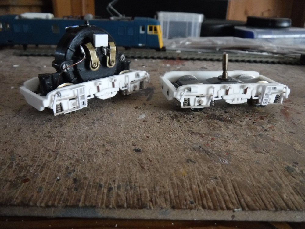

gibbo675 Posted July 7, 2024 Posted July 7, 2024 (edited) 3 hours ago, LNERW1 said: @gibbo675 giving us some brilliant examples of British to Irish conversions, has inspired me to try follow up on the 071 from a 58. Read somewhere else that Hornby considered this, but I’m not quite sure on that. I’ll look for a cheap 58 first, then a 3D-printed end. Edit: will be starting a workbench topic for this and other things, also side-profile photos of 071s would be nice, thanks. Hi Folks, Will these be of any use ? Scratch building bodies for diesels isn't anything like as difficult as you might think. Previously for OO gauge I've used .060" plasticard and around the cabs and roof lines layer up and reinforce corners and then file and sand back to shape. Radiator grilles can be made by scribing plasticard with variously, hack saw, junior hack saw or razor saw blades depending upon sizes required, different TPI's are suitable. If I were to build a 071 I think from having a quick look then a class 58 body shell is a good start and I would look to see if there was an American HO chassis to get as near to correct bogies as possible although you could make plasticard overlays and stick them on with cyanacrylate glue to the Hornby bogies. I have scratch built and kit bashed all sorts of unavailable British stuff for myself, in some cases built stuff that is available because its more fun. Here are some of my cut and shut specials, all British but the concept is the same. Scratch built bogies for NBL class 84. My second class 84 catching up the first one I built, the body shells are Trix class 81 mouldings. Part built RSH DC electric shunters built for Kearsley Power station near Manchester next to an N gauge built for a friend of mine. All four of Kearsley's fleet N gauge APT-E, once again for my lucky friend with a Leyland bus bodied coach made from Hornby class 142 body shells and a Mk1 undeframe. The N gauge APT-E on my friends layout next his own prototype HST. Imagination fellas, the single most powerful force you all posses. Gibbo. English electric class 83 27 minutes ago, DJ Dangerous said: Would that be a Fowler4F? Not too common here on the forum lately. That's IRM, keeping fifty-plus-year-old toddlers occupied since 2018! Hi DJ, No, it is the LMS fowler class 4P 2-6-4 tank, LMS numbers series 2300-2424, (for BR add 40000). Gibbo. Edited July 7, 2024 by gibbo675 Missed a caption for photgraph 2 1
gibbo675 Posted July 7, 2024 Posted July 7, 2024 3 hours ago, LNERW1 said: @gibbo675 giving us some brilliant examples of British to Irish conversions, has inspired me to try follow up on the 071 from a 58. Read somewhere else that Hornby considered this, but I’m not quite sure on that. I’ll look for a cheap 58 first, then a 3D-printed end. Edit: will be starting a workbench topic for this and other things, also side-profile photos of 071s would be nice, thanks. Hi LNERW1, I've had a look at the drawings that I have posted below and both my own Hornby class 58 and the class 58 drawing in the book "British Rail Main Line Diesel Locomotives" and it seems that the 071's scales in at 18mm longer over buffers and 16mm longer over the bogie centres. The wheel base of the bogies is near enough not to notice. I would suggest that the underframe could be rebuilt with plasticard either completely or simply lengthened, the main part of the body would be mostly sanded down and new doors made using .010" plasticard overlaid, the cooling fans of the cooler group cut out and extended and scratch built cabs. If building a cab, build it solid and cut the windows secondarily, that way it will be easier to build to the correct shape and retain is strength better than trying to build the windows in initially. Gibbo.
LNERW1 Posted July 7, 2024 Posted July 7, 2024 Thanks. What I was planning on doing was entirely removing the cab, and sanding down the frame to the correct length. If I need to remove a central section of the body I can do that too. I plan on building the cab out of plasticard, not decided on bufferbeam details but I'm sure I can find suitable detailing somewhere. I will probably use an 80s or 90s tooling, and with a 60ft long diesel you can probably count on the length being underscale to work on trainset curves.

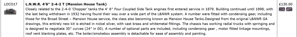

NorthWallDocker Posted July 8, 2024 Posted July 8, 2024 On 2/2/2022 at 5:29 PM, Killian Keane said: Aye, the DSER bought 6 of them in 1902, London Road Models make a kit of them (as well as, incidentally, the 'Special Tanks' of the same design as used on the Dundalk Newry and Greenore Rly) @Killian Keane, which London Road Models loco kit matches the "special tanks" on the Dundalk Newry and Greenore Railway? Or which British railway's loco design matched the DN & G - one of the L&NWR kits from London Road Models?
Killian Keane Posted July 8, 2024 Posted July 8, 2024 20 minutes ago, NorthWallDocker said: @Killian Keane, which London Road Models loco kit matches the "special tanks" on the Dundalk Newry and Greenore Railway? Or which British railway's loco design matched the DN & G - one of the L&NWR kits from London Road Models? The Crewe Special tanks and the 4' 6" mansion house tanks, but I have a feeling in the case of the Greenore saddle tanks the Irish locos had larger driving wheels than their English counterparts, don't know off the top of my head though 1
NorthWallDocker Posted July 8, 2024 Posted July 8, 2024 1 minute ago, Killian Keane said: The Crewe Special tanks and the 4' 6" mansion house tanks, but I have a feeling in the case of the Greenore saddle tanks the Irish locos had larger driving wheels than their English counterparts, don't know off the top of my head though Ah, thank you. That helps me focus on the little details, and how they compare. (Now where did I put my DN&G book....)
