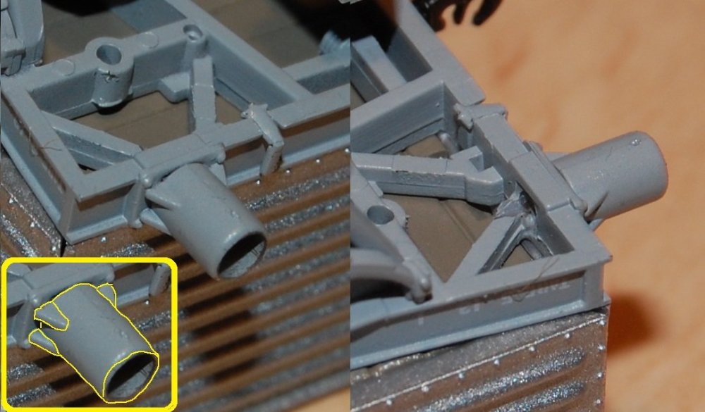

update:
I just took my magifier lenses to check the buffer mounting to the frame.
To me it seems that the the base plate of the buffer (rectangular with 4 bolts) is part of the frame molding.
The "tube" (highlighted in yellow below) with 4 fins seems to be glued to the frame. The buffer itself is a metal part (turned to shape) sitting with a small spring inside the "tube" and fixed by a snap (the little thicker end of turned part) fit via a narrow hole inside the "tube".  (sorry. I am fighting to use the correct words).
Replacing the buffer would need to toucht the base plate which could not be cut off easily as it sits in an I or C beam.
The idea of respacing just became far more difficult as desired.

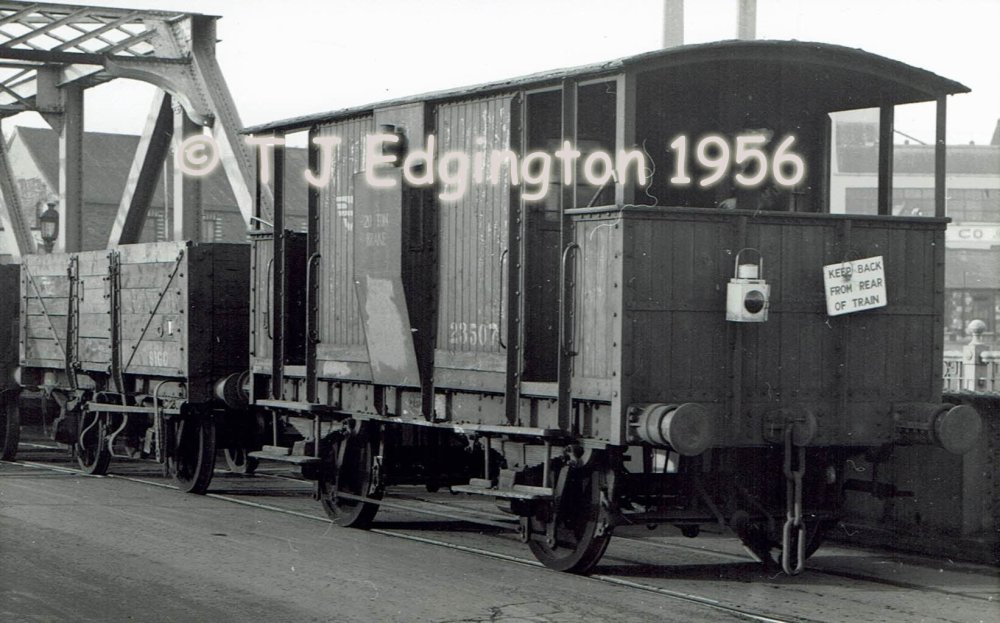

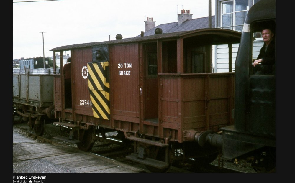

CIE locos/stock built/bought from the early 50s (post 53?) onwards tended to be fitted with larger buffers than earlier stock, but older stock often continued to run with their original buffers. Larger buffers heads may have been introduced to allow any item of stock to run anywhere on the system and reduce the risk of bufferlock during shunting.
All my wagons are based on photos and drawings of wagons built before 1953.
Photo of a van sandwiched between an A Class and a flat wagon makes a good comparison of the different diameters of buffer head and vehicle width, the  Brake Vans were narrower in width than most wagons.
The different in size/possiblly misalignment between the buffers on the open and Brake in the 1956 Cork photo is quite noticeable.

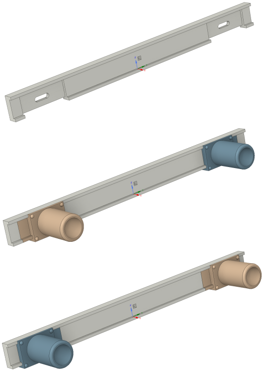

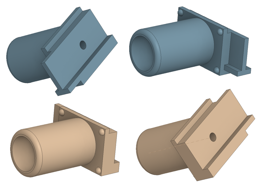

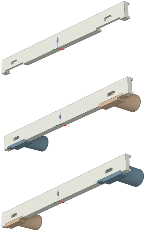

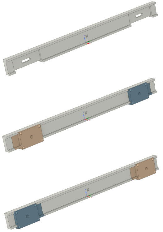

This is an idea I had how the models could have been made to fit both IR and BR buffer spacing.
I made a very rough 3D sketch to show the idea.
Some details will have to be improved and adjusted to make the idea feasible for molding and assembly.
I thought to have buffers as extra parts to be either applied by the customer (one item for all) or applied at the factory (which would make 2 different items for either IR or BR). My first idea was to have one buffer&baseplate with a 1.15mm but assymetrical extension on one side. The buffer beam (is this the right wording) has room to take the buffer mounted to the inside (BR spacing) or the outside (IR spacing).
Checking the Bulleids models I saw the buffer center are offset by 0.15mm (you can see it on my recent picture I posted last Thursday at 21:37). Therefore I had to make a left and a right buffer. You get IR spacing by placing the left buffer on the left and the right on the right - BR spacing by placing left to the right and right to the left. To show the design I decided to do it with the more simple buffer of the tank wagon which has no reinforcing ribs.
Maybe this idea might find its way into other new toolings (we all need brake vans 😉) or into a re-run of the bulleids somewhen in the future.
Edited by MAL
Brilliant stuff, @MAL!
This is what I was wondering about for future Bulleid runs, future loose-coupled stock and future brake-vans.
If the buffers were applied in the factory, but were friction-fit or NEM-pocket-style clipped in, rather than glued, and mounted on a reversible rectangular plate, IRM customers could then pop them off to swap them around as needed.
You want to run an IRM brake-van coupled to an A or a Park Royal?
Run it straight out of the box!
You want to run that same IRM brake-van with the Bulleids?
Ten seconds to swap the buffers around and you're sorted!
  • Agree 1
It would be great if we could pick the buffer widths ourselves like this on future product lines.
On a related note....If I may be so cheeky to get my own request in....would it be possible to include wider spaced holes under the chassis/bogies and include wider spaced brake gear that we can insert in those holes after snipping off the 16.5mm brake gear? (for those of us doing 21mm that is)
  • Agree 2
I first thought to include the doubled holes for all the brake rigging into my sketched design.
But then I decided to keep this for later. Mainly because I would have to draw the remaining frame instead of just the end beam.

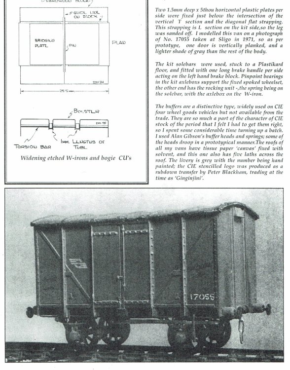

A number of British suppliers including Alan Gibson Works (AGW) http://www.alangibsonworkshop.com/and Dart Castings https://www.dartcastings.co.uk/ produce 4mm -1:76.2 scale buffers and detail parts.
There may be no direct British equivalent of the buffers fitted to the CIE H Vans and Bulleid wagons.
David Malone who published a number of articles on modelling Irish Railways to P4 Standards in the 80s and 90s turned his own buffer bodies (brass) and used Alan Gibson buffers heads and springs in models of the early version of the CIE H Van and the Corrugated Open Wagon.
The abstracts are from RailModel Digest which was published for a short period during the mid -late 90s
David notes that sagging buffer heads were often a feature of Bulleid wagons and H Vans!
If you consider correctly positioned buffers important enough, one option for re-producing these buffers may be to use Gibson or Dart (MJT) buffer heads in conjunction with a brass "lost wax" body reproduced from a 3D modelling file.
Some precious metal/jewellery suppliers have the capability to cast from a 3D modelling file. Some of the detail castings I use in locomotive kits are cast in brass from 3D prints or direct from a stl. file, eliminating the brittleness problem inherent in resin prints
