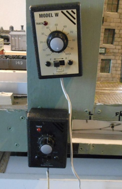

Colonel Posted July 6 Posted July 6 My new Model W arrived today and seems to have solved the problem, so guess that will be my 'go to' controller from now on - at least for Swillybegs. The feedback unit works well enough with my Northport Quay stock. The W is still needed for the mobile crane and as back up for the broad gauge of course. 1

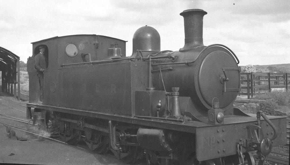

jhb171achill Posted July 15 Posted July 15 (edited) Swillyish pic of Senior's - no idea where, 1940. Edited July 15 by jhb171achill 10 1
airfixfan Posted July 15 Posted July 15 1 hour ago, Irishswissernie said: Letterkenny. The decrepit carriage shed is the tell tale sign 1

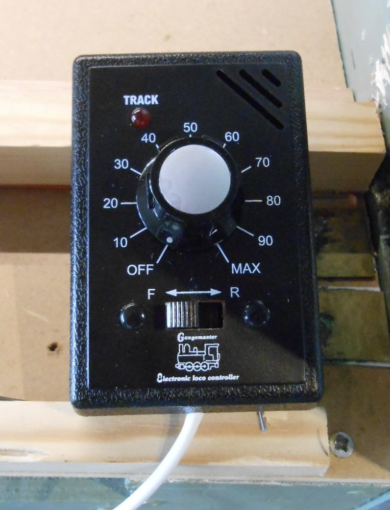

Colonel Posted July 17 Posted July 17 Can't quite believe I'm writing this, but when setting up Swillybegs at the Chatham Show today, found that all three of my controllers are now useless! The two Ws as previously reported, but now the Feedback unit has a problem with a loose wire, inside the casing, which I can't access. So, what to do? Then I remembered the Morely controller we use on the Club 0 gauge layout. So, cut the two 12v wires from the back of the Gaugemaster socket and joined them to the !2v output from the Morely. This unit has the provision for a handheld unit and this is what I'm now using over the weekend. It has no feedback feature, so works well with all motors. Fingers crossed. Wish me luck - there will be a bit of rewiring needed before the layout goes out again in August... 1 6

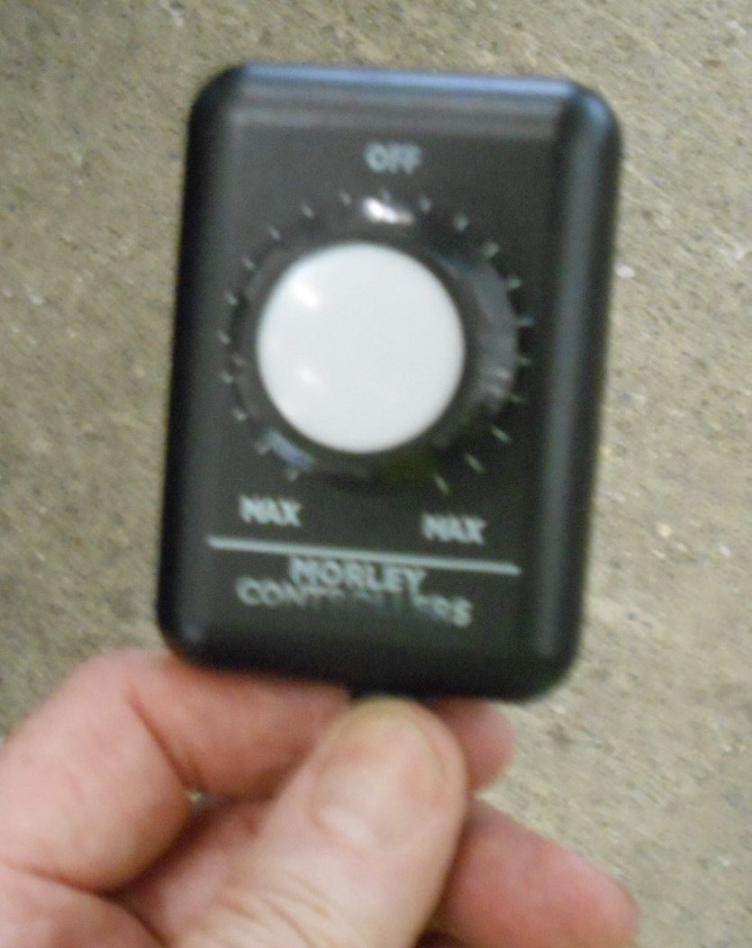

Colonel Posted July 18 Posted July 18 It gets worse, Alan. The Morely controller just isn't up to the fine control needed on a small layout. As a result, it was impossible to do any shunting because I couldn't run trains slowly enough to stop over the uncoupling magnets. So the two railcars had to do the bulk of the work, with the two Swilly tanks just about managing their trains, but having to run much too quickly for my liking. Spent the second half of the day trying to work out what combinations might work best for Sunday, while also had to bring home several wagons and coaches to repair the DG couplings. I've done well over 100 shows and today was by some distance the most challenging and disappointing I've ever experienced. :-( :-( :-[ 1 1
Mol_PMB Posted July 18 Posted July 18 Sorry to hear that. seems really odd that several controllers are all giving problems that you haven’t had before. Is it possible there’s a gremlin in the layout wiring - something other than the controllers? Maybe a connection has gone high resistance through corrosion? Have you got a loose piece of track you could test on to rule that out? 1

Colonel Posted July 19 Posted July 19 The feedback and W are both old and it is a loose wire inside the former that is the problem. Seems Ws are prone to the issue I have, but you don't expect it on a new one.. Another option possible for today, but if not I hope we can muddle through. 5
Colonel Posted July 20 Posted July 20 A fellow club member provided a third Gaugemaster W on Sunday, which worked without problems all day, so am hoping there are no hidden issues in the wiring. Perhaps the lurking of my 40 year old H&M Clipper as the the final option prevented further mischief!I Nevertheless, getting through five different controllers over a two day show is a worry and reflecting on the experience makes you realise that options are fairly limited for an analogue layout, especially if you want a handheld one. Gaugemaster do the two I've already got, while Morley do a hand held one to go with their cased units. However, there is just not enough fine control in the latter for a small shunting layout and though better, the W also lacks the finesse of the feedback unit. The much missed Pentroller is only available second hand and even then is rare, because it is probably the best and folk rightly hang on to them. The only alternatives seem to be DCC (been there, tried it, not for me) or maybe the latest analogue versions of that like the Gaugemaster Infinity. However, at over £360, not something to be taken lightly. Thoughts anyone? 1

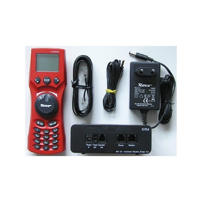

murrayec Posted July 20 Posted July 20 (edited) @Colonel I agree with irishthump, you would only need a starter DCC controller for your layout. There are plenty about for around 70 to 150 pounds second hand or new. I use the Roco Multimaus which would be fine for starting off, easy to use, then later as you get to grips with DCC you could upgrade.... Also, I recommend this book by Crowood Publishing, it is a great introduction to all aspects of DCC. It covers setting up the layout, discusses the types of controllers and chips, and gives plenty of examples of converting locos to DCC with loads of photos;- Eoin. Edited July 20 by murrayec 1 3

DSERetc Posted July 20 Posted July 20 Hello David, Regarding the Guagemaster controllers. I was using a Guagemaster DC controller for over twenty years to run an O gauge garden layout from a cabin (Shelter). Then I discovered it only delivering about 3v instead of 12v. Guagemaster in their advertising stated that their controllers had a 'Llfetime Guarantee', so I took a chance and sent them the defective controller. They repaired it free of charge and did not even charge postage. This was before Brexit. I wonder if cutting the wires would 'Void the Warranty;? DSERetc 1 1

Mike 84C Posted July 20 Posted July 20 Hi David, at risk of sounding like a smarty pants you have answered your problem. Feedback controllers and coreless motors are not a happy marriage. All I have read says do not use that combination. As you know Bantry was 4mm scale and the locos came from very varied sources, Hornby, Bachmann, 00 Works & Kitbuilt. All DCC fitted, some sound some not. Never had any problems fitting decoders in the body's just insulate them well. As an aside, i was in our local DCC specialist today to price up having Dcc and sound fitted fitted in a very small tank engine, it was deffo a HOW MUCH!! moment.Price had near doubled since I last had one done. So it will be diy and silent running in future! One more thing to consider is being able to switch point frog polarity and if you need to modify the points. If I sound like an expert I'm not, just info from experience. Regards Mick

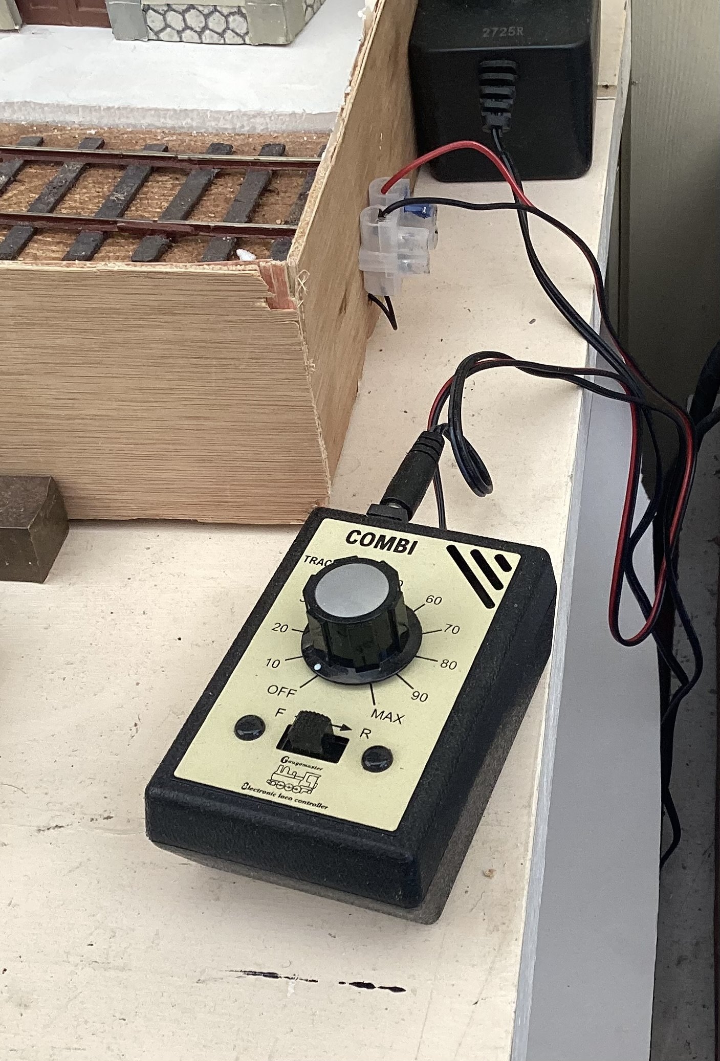

Colonel Posted July 26 Posted July 26 It will come as no surprise to anyone who exhibits regularly that after the horror show at Chatham, the layout is now running nicely again. However that only tells a fraction of the story, of which key components are: A new Gaugemaster HH controller: for Swillybegs, the difference is transformational. All the locos with open frame motors run sweetly again, likewise the turntable - which is quieter too, compared to with the W Railcar 10: was decidedly hesitant at times and even with the new HH all was not well. However, back on the workbench, I quickly traced to problem to not one, but two pickups not acting on their wheels. A bit of tweaking and with 8 wheel pickup, it now run beautifully again. West Donegal Tram: the red Sharp Stewart 0-4-2T was also unhappy and on the bench, this was also traced to pickup, also in this case it was TWO driving wheels had come loose on their axles. The coaches meanwhile, while still needing a bit more weight, run better after I discovered one of the tension lock couplings in the middle of the rake had become twisted - or maybe I just didn't fit it properly in the first place... Swilly 4-6-2T: this failed completely on Sunday morning. Soon traced it to a loose wire on the motor, but though I managed to re-attach it, the loco still wasn't & happy and guess what? Yes, pickups again on both rear drivers! It works so much better on six pick ups than four... Swilly 4-6-0T: actually came through the show relatively unscathed, but is certainly a lot happier with the HH. Donegal Goods: unused at the show, because shunting was pretty much impossible. With the HH, shunting is [almost!] a pleasure again because you can easily find the magnets and ease back to open the couplings. Which just leaves Phoenix. I didn't use it much, due to the shunting problem, but back home, it was derailing on the points! The cause was soon found to be a loose wheel - hence out of gauge. A Chinese curse is 'may you live in interesting times', so can only think I must have annoyed a far Eastern gentleman or lady & if so, I apologise! Overall though, you really can't make it up. One or two issues over a two day show [14 hours running in all], but not six out of seven. Add in a few broken couplings through needing to run at higher speed and it makes you wonder. However, the Chatham Show itself looks like it was a success, with over 2700 paying visitors, up 500 on last year, which is certainly good news for club finances and a tribute to all the hard work that went in by our organisers and helpers over the weekend. 11
