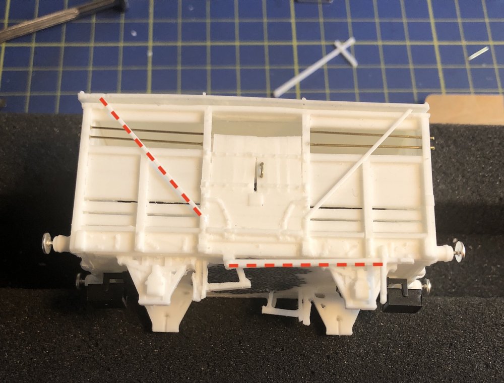

Noel Posted June 14, 2020 Author Posted June 14, 2020 Diagonal brace straps fitted along with brake gear handle. I'm using Rocket 10-20 second superglue but it's taking a long time to start setting with resin. I know poly glue is useless with resin, so for future resin kits I probably need to use an more suitable superglue. This kit goes together really sweetly. Got the Dapol NEM pockets mounted onto the chassis (ie for kadee's). Now how to get some grey paint inside the body, should have done that before fitting the roof but needed to fit it along with the sides to get a square snug fit while the glue cured. Always learning. 1 Quote
Georgeconna Posted June 14, 2020 Posted June 14, 2020 Get some Accelerator Noel. work wonders. https://www.amazon.co.uk/Blaster-Cyanoacrylate-Accelerator-DELUXE-MATERIALS/dp/B00TPTLDKS 1 1 Quote
David Holman Posted June 14, 2020 Posted June 14, 2020 Find that abrading the resin surface to give a key for the glue works well, Noel. A fibreglass stick or a bit of gentle filing is all you need, hopefully. 1 2 Quote
Noel Posted June 14, 2020 Author Posted June 14, 2020 1 hour ago, David Holman said: Find that abrading the resin surface to give a key for the glue works well, Noel. A fibreglass stick or a bit of gentle filing is all you need, hopefully. Thanks David, Yes I usually use a micro file to roughen the surfaces, and/or even a bit of grit paper. But the Rocket just doesn't set quickly with resin parts. It's near instant on plastic or other materials such as 3D WSF. Quote

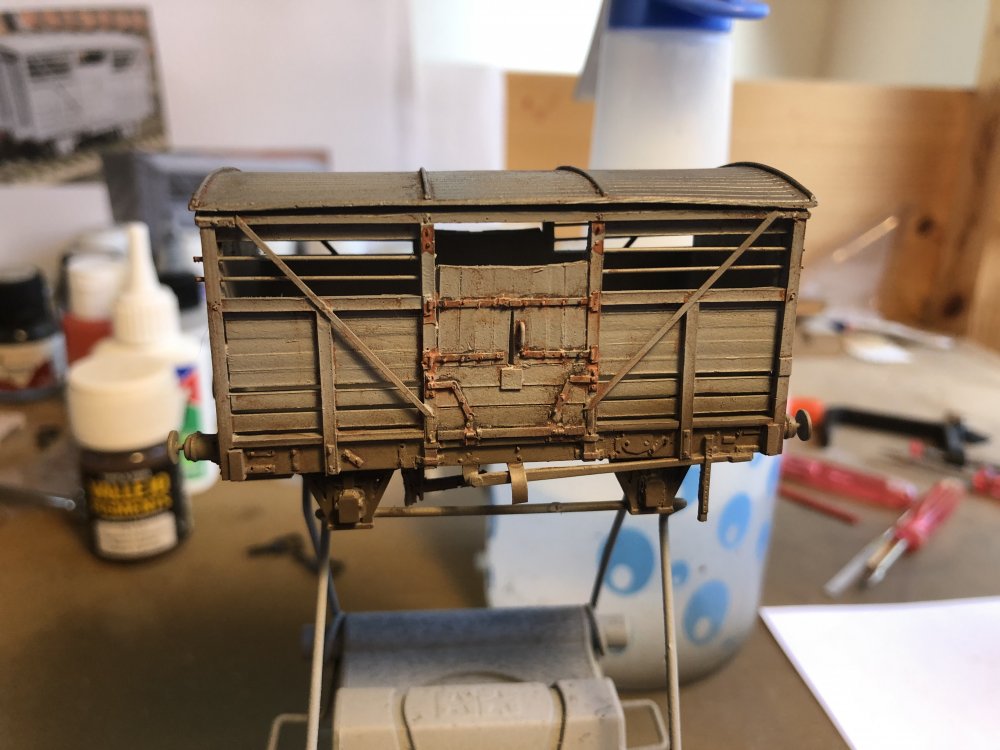

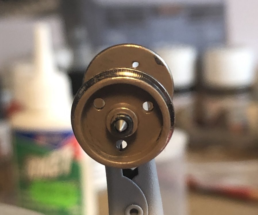

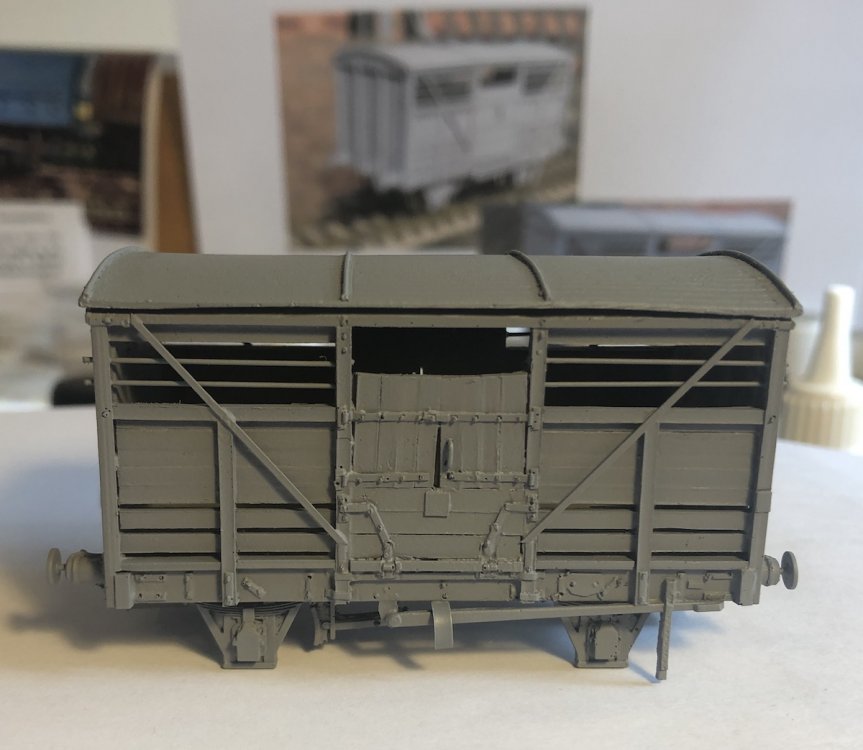

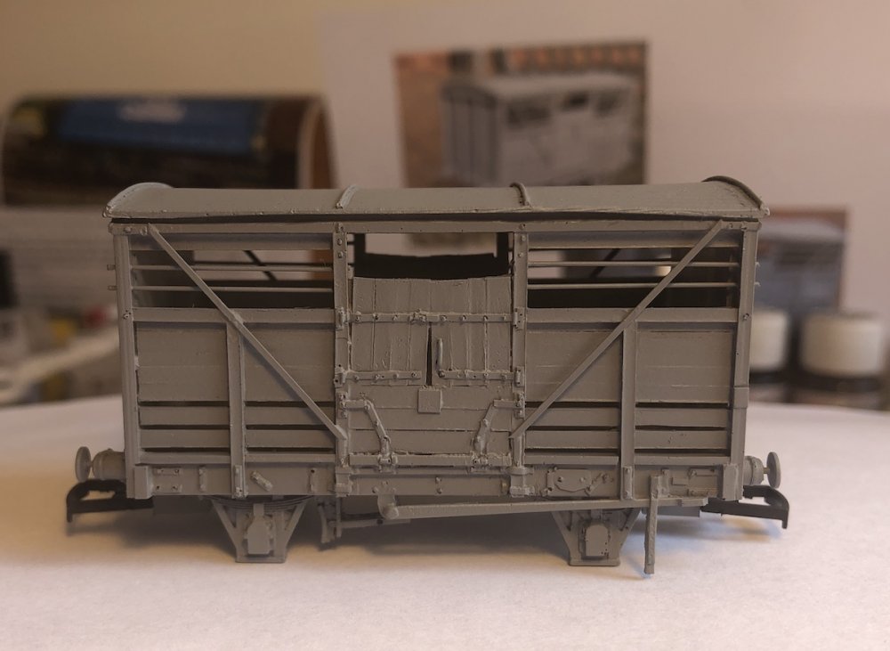

Noel Posted June 14, 2020 Author Posted June 14, 2020 First coat of primer on, now tidy up any issues if I can spot them (ie like fitting the brake lever protector that I forgot). As ever wheels get a coat of sleeper grime print by hand brush. No use having a gently weathered wagon from the 1950s with bright stainless steel shining through from under the solebar. Looking at the intricate door arrangement on this wagon, the ramps were quite short on the prototype, so the cattle dock platforms must have been perfect height and gap from the track. Top doors swing open, and lower ramp falls forward onto the platform at the dock. Half tempted to model one of these with the doors open and cattle being herded aboard. 4 Quote
murrayec Posted June 14, 2020 Posted June 14, 2020 @Noel I would recommend using epoxy glue for resin mouldings, the main structure done complete with epoxy, one could use Rocket 5-10 (it's stronger but does bloom if one uses to much) to assemble small parts and then apply epoxy to reinforce. Cyano does not suffer shock well and bits are liable to spring off.... The insides of these wagons would not have been painted so if thinking of painting a wood colour would be the one...... The doors were right down to the floor and the ramp closed up against them which locked them shut..... Eoin 3 Quote
patrick Posted June 14, 2020 Posted June 14, 2020 Due to my talent for sticking my fingers together or to kit parts or anything else that happens to be nearby when using superglue I too have used epoxy to good effect on Leslie's kits. Another advantage is having time to correctly align parts before the adhesive sets. 1 1 Quote

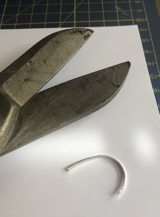

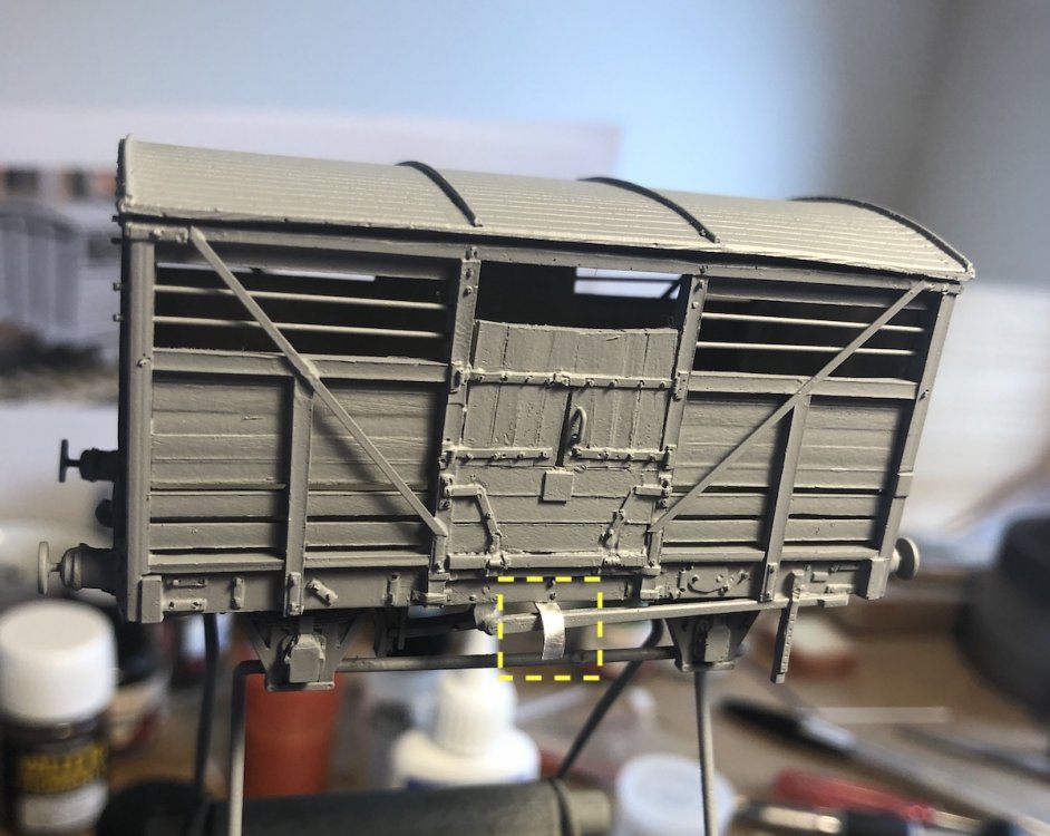

Noel Posted June 14, 2020 Author Posted June 14, 2020 (edited) Instead of using the supplied staples for the break gear protector, I cut a strip of thin aluminium and shaped it around a needle nose pliers. Super glued to underside of chassis Door brake gear protector in place after second coat of primer. I'll cut it a little thinner for the next batch of PW bulleid open beat wagons. Easier to work with than staples. Wheels look better rusted and grimed up. At least they won't glint from under the wagons. Edited June 14, 2020 by Noel 2 Quote

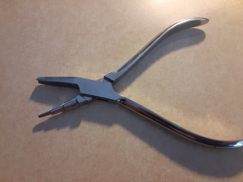

patrick Posted June 14, 2020 Posted June 14, 2020 This tool very useful for shaping brake protectors. It's from Kadee for adjusting the height of their coupler trip pins although I have seen similar tools from other suppliers. Several posts here have commented on the unsuitability of the staples in Leslies kits but I have never had an issue with them, and have built 12 Bulleid opens and 5 cattle wagons. 2 Quote
Noel Posted June 14, 2020 Author Posted June 14, 2020 9 minutes ago, patrick said: This tool very useful for shaping brake protectors. It's from Kadee for adjusting the height of their coupler trip pins although I have seen similar tools from other suppliers. Several posts here have commented on the unsuitability of the staples in Leslies kits but I have never had an issue with them, and have built 12 Bulleid opens and 5 cattle wagons. Hi Patrick. Yes I used that kadee tool to shape the staples on the bulleid open wagon for the door limiters. But the staples are a night mare, they keep separating so the next batch of wagons will have alluminum stips instead. Quote
patrick Posted June 14, 2020 Posted June 14, 2020 A few did separate for me also but making a new one was no problem. I happen to have several lifetimes supply of oo scale brake protector raw material in a drawer at home! 1 2 Quote

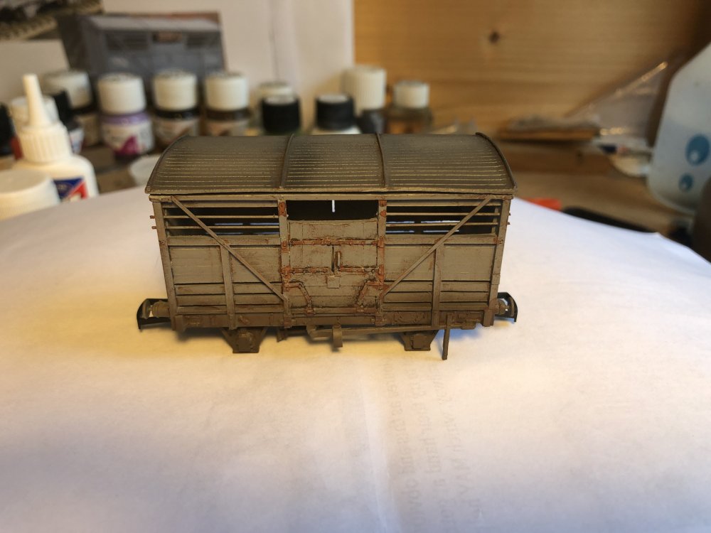

Noel Posted June 15, 2020 Author Posted June 15, 2020 (edited) Started decoration. Not entirely happy with a few weathering bits that will need attention tomorrow. Luckily decal fix solution can be reactivated with water. Edited June 15, 2020 by Noel 2 2 Quote

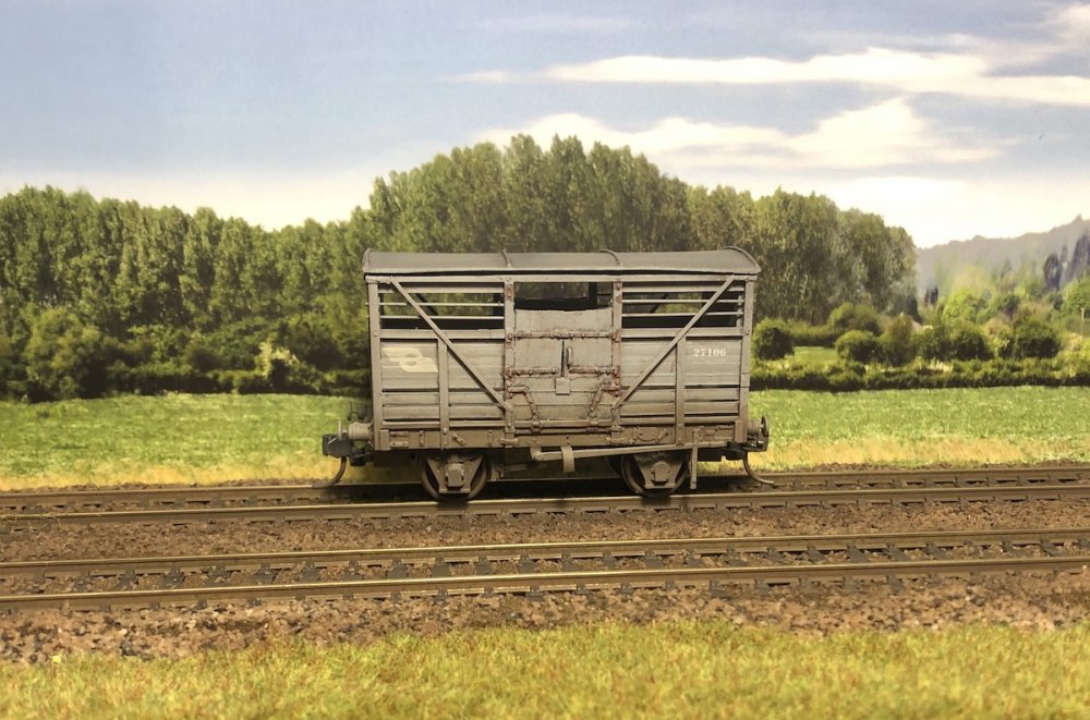

Noel Posted June 18, 2020 Author Posted June 18, 2020 1 done, 4 more to go. Provincial wagons cattle wagon kit. Enjoyed that. 6 1 Quote
