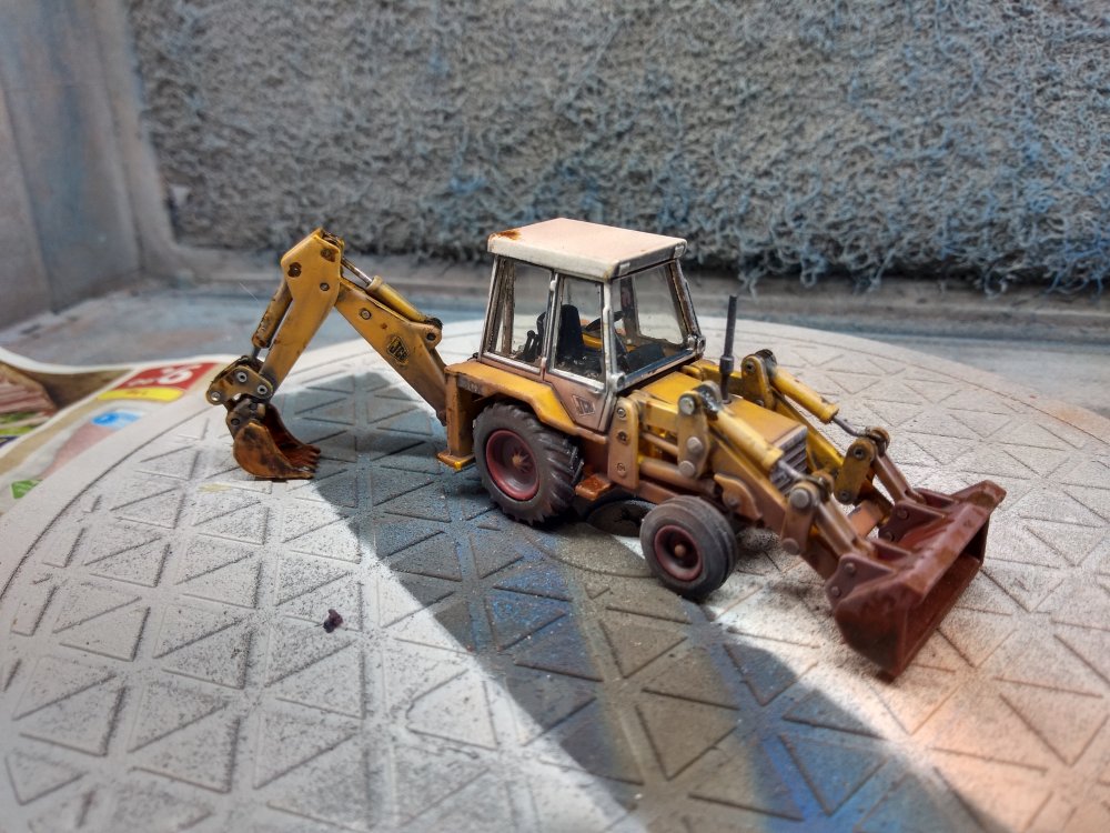

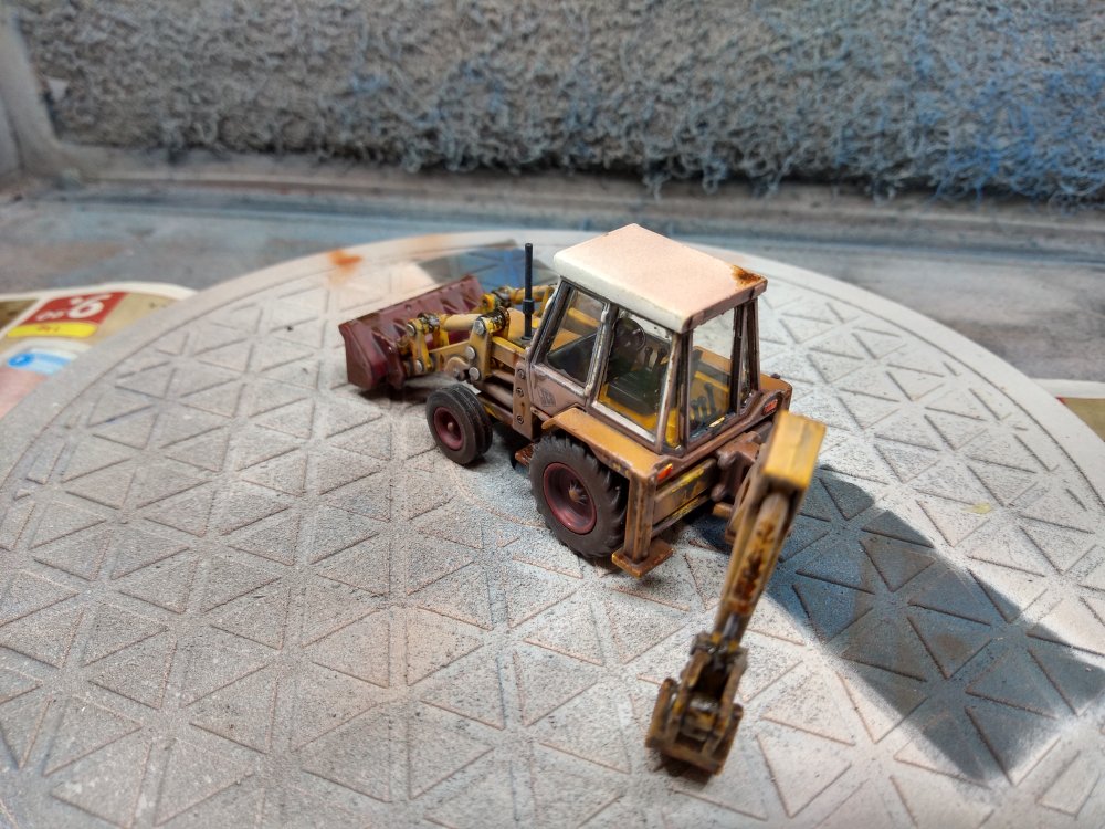

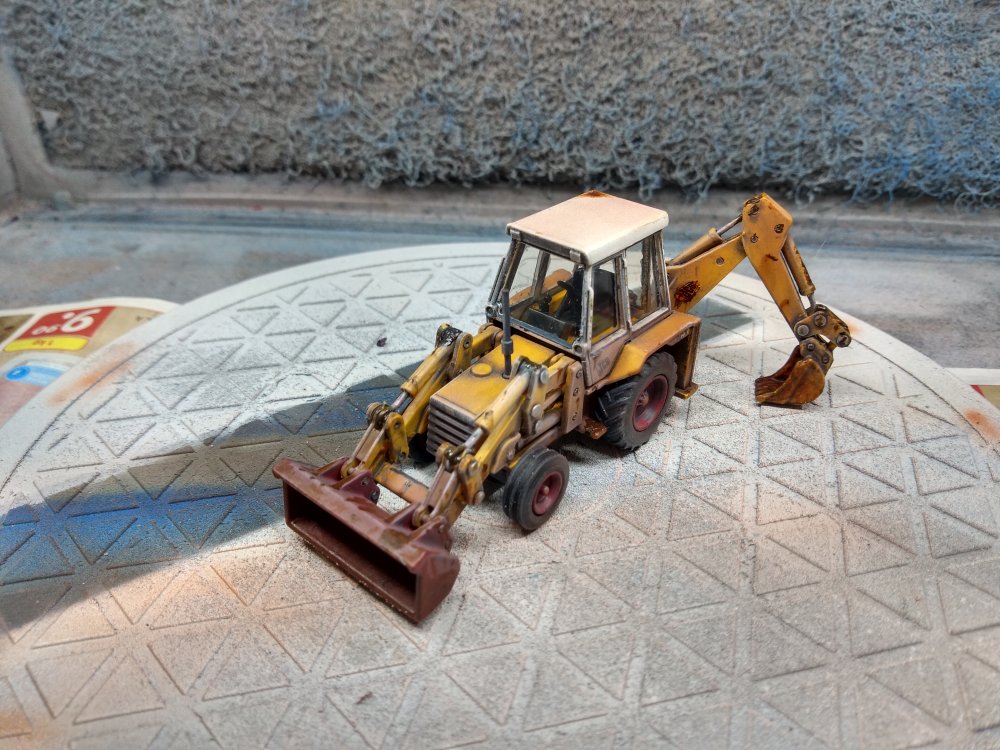

murphaph Posted October 31, 2022 Author Posted October 31, 2022 I have parked the NIR 111s for the moment as I want to try laser cutting a stencil and airbrushing the logo on the side. The laser cutter is on the way. In the meantime a bit of messing about weathering some Oxford diecasts. I imagine these old things were operated by the local builders' providers... 11 4 Quote

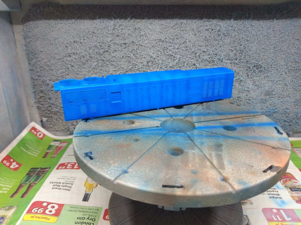

murphaph Posted November 1, 2022 Author Posted November 1, 2022 I have stripped and resprayed this piece a number of times as I try to familiarise myself with the Vallejo polyurethane primer. This stuff gets extremely mixed reviews but on this material if you follow the Vallejo instructions (thin the primer about 20% thinner and 5% flow improver and spray a mist coat first and then build it up) then it works well IMO. As the loco is to be heavily weathered I am trying a post shading effect here. The paint did not age uniformly. UV damage was highest on the top for obvious reasons but also areas along panel lines tended to be darker and areas under projections like the louvres and turbo cover were also darker relative to the more exposed panels. As mentioned briefly above my plan is to further experiment with a laser cut stencil of the NIR logo. I could probably get a good enough result from transfers but I want to challenge myself a bit. 8 Quote

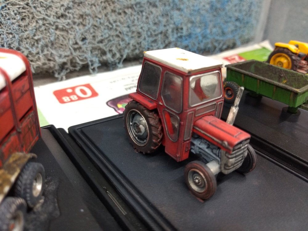

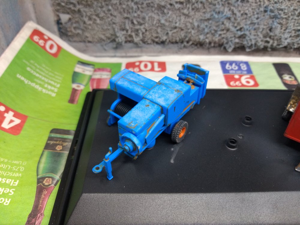

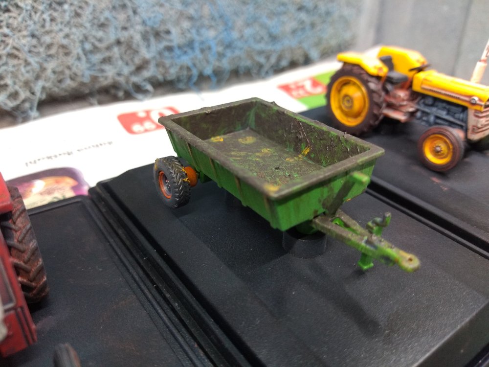

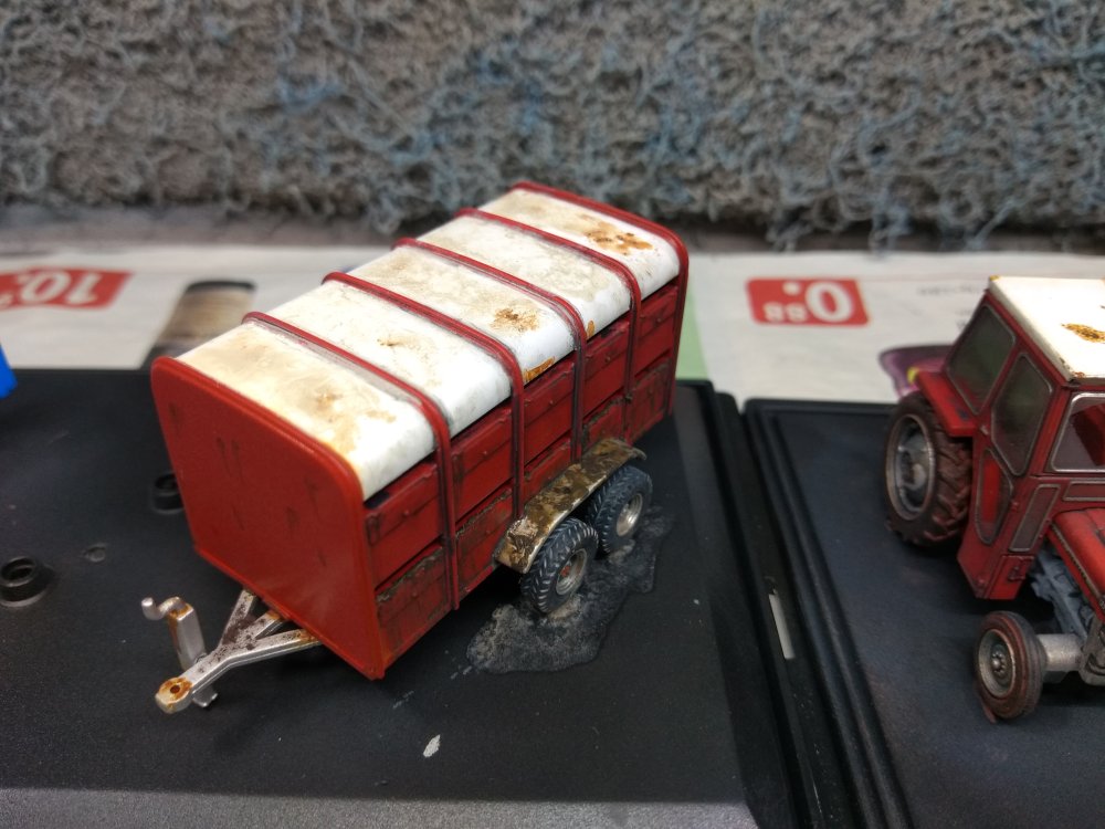

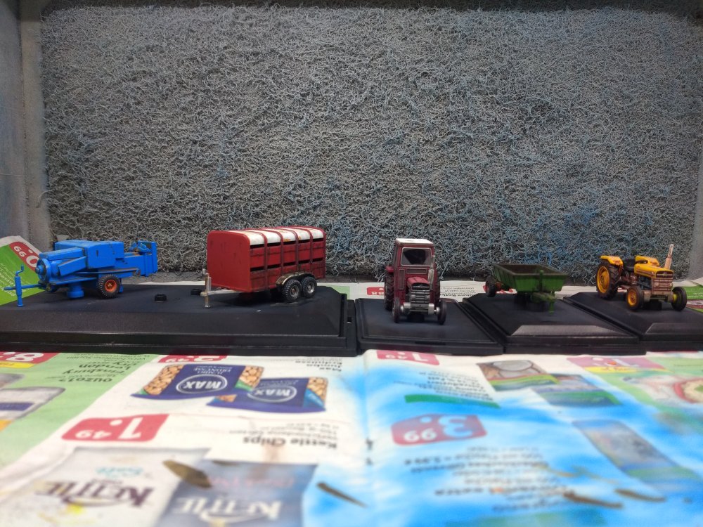

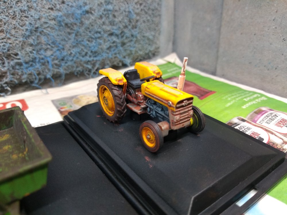

murphaph Posted November 4, 2022 Author Posted November 4, 2022 (edited) A bit more weathering fun, this time with an agricultural theme... This baler hasn't been used for many years, not since the round baler replaced it. Sun bleached paint from lying up out behind the barn most likely: The livestock trailer sees regular, erm use: These old Masseys are still doing the odd light duty: And best not ask what this thing is used for: Group photo: Edited November 4, 2022 by murphaph 7 1 Quote
Broithe Posted November 4, 2022 Posted November 4, 2022 5 minutes ago, murphaph said: A bit more weathering fun, this time with an agricultural theme... These old Masseys are still doing the odd light duty: Needs a dog, keeping the seat warm..? 2 Quote

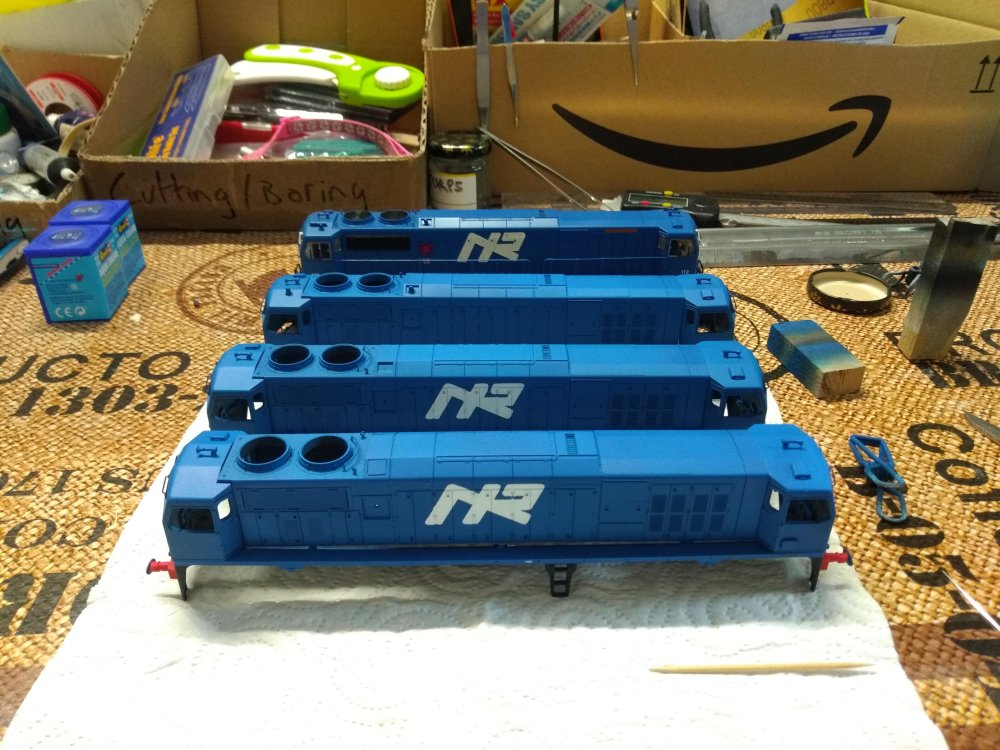

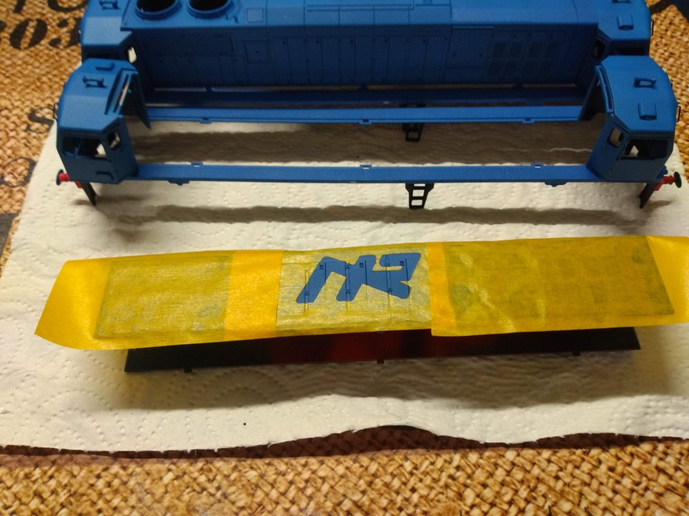

murphaph Posted November 29, 2022 Author Posted November 29, 2022 (edited) And now for something completely different.... As some of you may know, I am (for the longest time now) repainting 3 086's into NIR 111's, in mid 90's condition. I wasn't entirely happy with the large NIR logo transfer so I decided it was finally a good enough excuse to buy a laser cutter to see if I could cut out my own masks and airbrush the logo on instead. Well I'm not quite that far but progress has been made as the laser cutter arrived and has been assembled and tested. Using plain copier paper I can achieve a very crisp mask. I am hopeful when I get wide enough Tamiya masking tape that it will produce a very decent mask and I can forget about getting transfers to sit down into all the unevenness of the side of a 111. Interestingly I believe the MM logo is slightly too rounded, when I compare it to the mask I have cut out and when compared to the real thing. Side on Flickr image for comparison: Even the prototype looks, well, a bit off if you ask me. The bottom strokes of the N and I are not parallel. I guess it was hand painted after all. It's not a vinyl sticker by the looks of it. Edited November 29, 2022 by murphaph 3 3 Quote

murphaph Posted November 29, 2022 Author Posted November 29, 2022 9 minutes ago, Flying Snail said: Very interesting project - do you mind me asking what laser cutter are you using? When you mentioned decals, I wondered if you considered any of the vinyl cutters like the Cricut Maker etc.? I presume the laser cutter will give you more options around materials to cut .... It's a no-brand chinese diode laser, 40W input power, unknown output power lol. It's mounted to a 3018 cnc machine, again a no-name Chinese thing with the most questionable instructions. I did originally look at Cricut machines a couple of years back but personally I think for most applications we are already beyond them with laser cutters. The primary advantage of a Cricut I would say is that you can cut PVC materials without releasing chlorine gas, which is what happens when you burn it (as a laser does). Chlorine gas is highly dangerous obviously. Nice one George. I did consider overlapping my 10mm stuff but I thought it might be tough to properly burnish it where it overlaps so I have just ordered some wider tape from a local supplier. Should be here in a couple of days and then I can see if the whole idea is folly or not. Probably handy to have anyway. I think Tamiya actually does A4 sized sheets of paper backed masking tape, for exactly this sort of purpose. 3 1 Quote

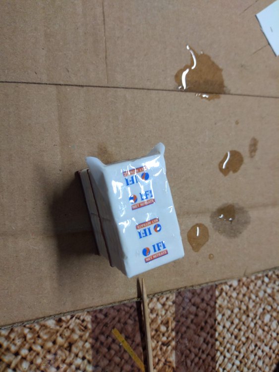

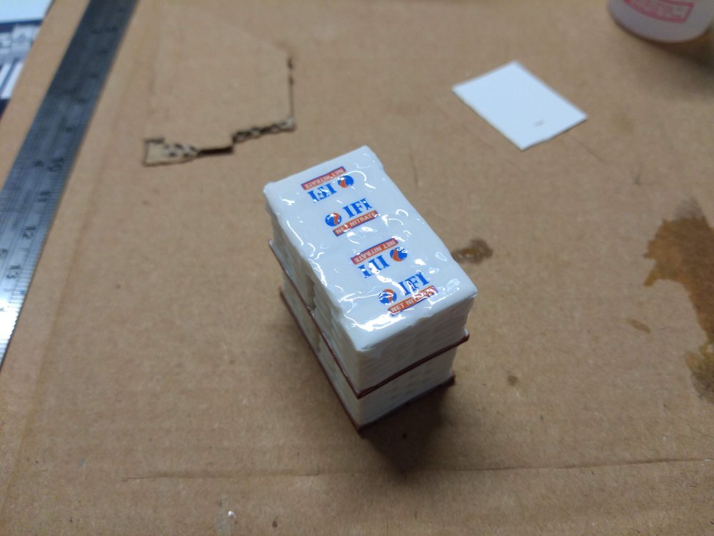

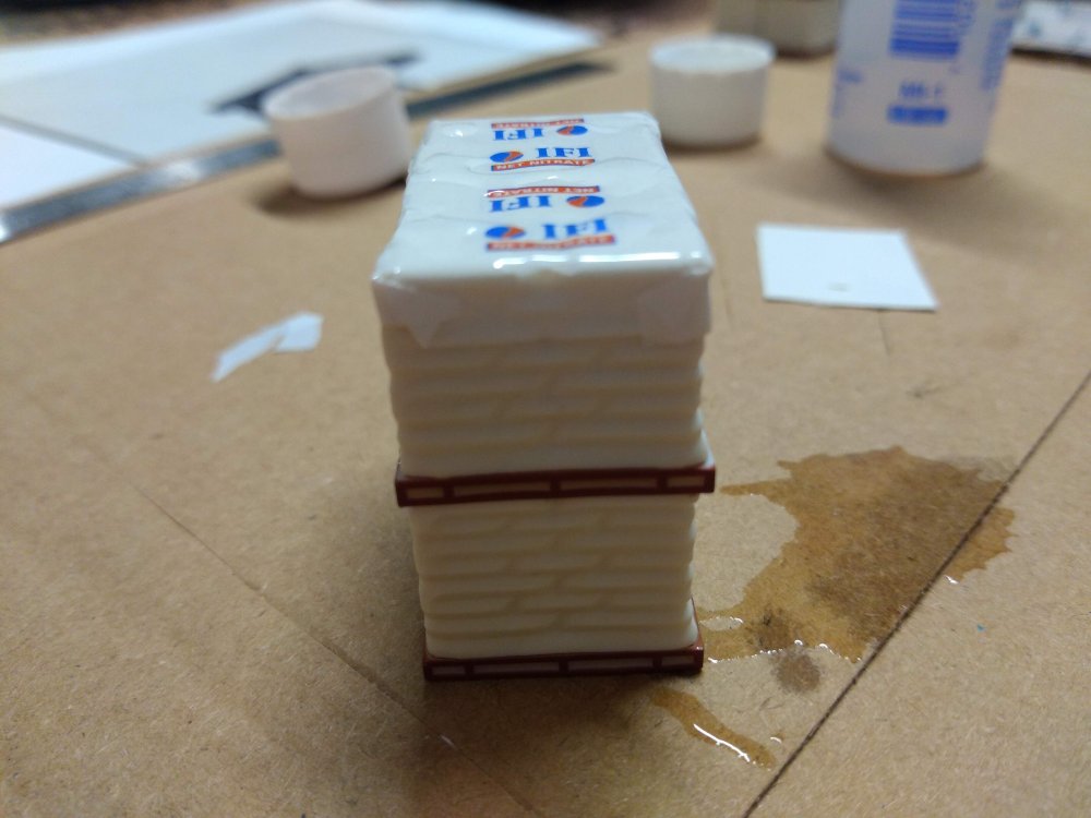

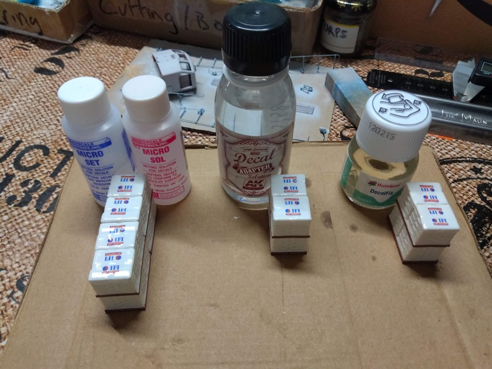

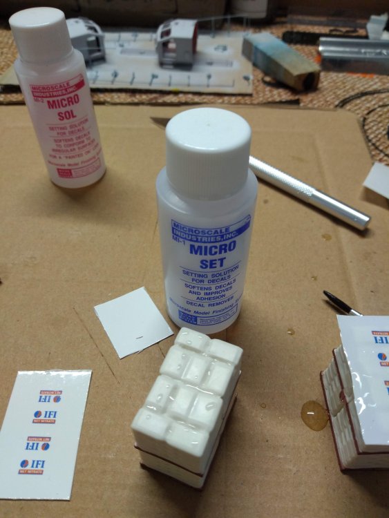

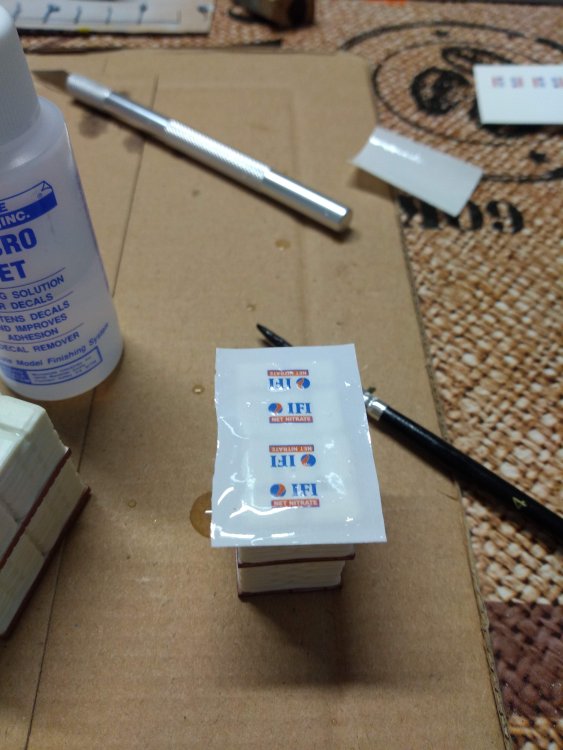

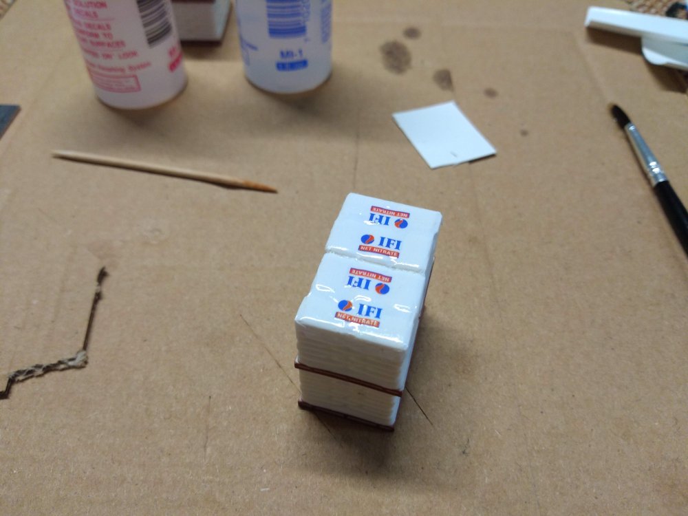

murphaph Posted December 4, 2022 Author Posted December 4, 2022 Hi all. I have been asked by a couple of people to write a more detailed "how to" on my IFI Net Nitrate transfers for the IRM fert wagon loads. So, here is exactly how I do it. 1: Apply microsol to the degreased wagon load. If you haven't been mauling them they should be fine out of the box to be honest. The one in the pictures here was not degreased as I had not handled it. 2: Cut out the transfers by cutting right down the middle line between each column & row decal design, leaving all the white border material attached. 3: Soak one transfer at a time in cold water and after about a minute it will release from the backing paper. Remove it from the water and slide the decal off the backing paper onto the top of the double pallet stack load. 4: apply some microsol (microset would probably work too) around the overlaps, even the undersides and fold the flaps down at one end, then the longer sides, then the other end, tucking the corners in like wrapping a present. It will stick to itself.then smooth around the edges with a wet finger. apply some microsol all over and let the whole thing dry. 5: Optional: After letting an hour or so, you can work on getting the transfer to sit down into the crevice between the two pallets. It would be ok to pierce the transfer in this crevice in a number of spots with a sharp scalpel or needle and apply more microsol, to get the transfer to "pull in" to the crevice. It's not really necessary though, but I think it's a nice touch. 6: Optional: Apply a protective coat of clear varnish if you expect the loads to be handled much. Some pictures to illustrate the process. Remember, this is just how I do it. As long as you are happy with the results your way is fine too Once more, a big thank you to everyone who has bought one or more packs from me. Thanks especially for your kind words of encouragement. If you would like a set, which is enough to do 4 of the IRM wagons with a few spares for mishaps, feel free to message me directly. And then optionally the crevice line can be pierced or even cut aling with a sharp scalpel and decal softener applied along it and the result is the following once dry (The gloss finish can be left or matted down according to taste): Other decal softeners also seem to work ok, though decalFix could maybe do with a little dilution: 13 1 1 Quote

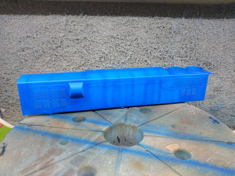

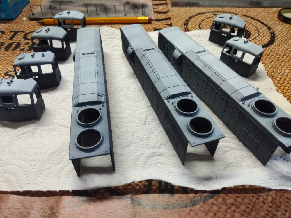

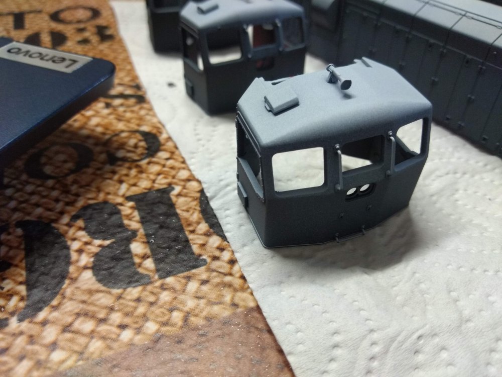

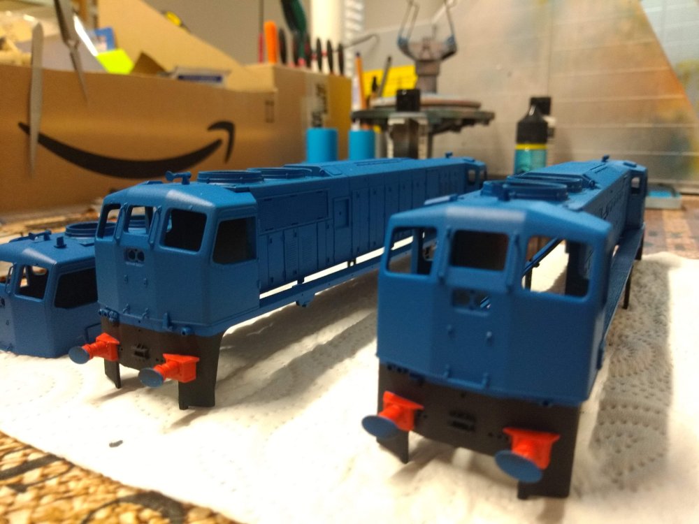

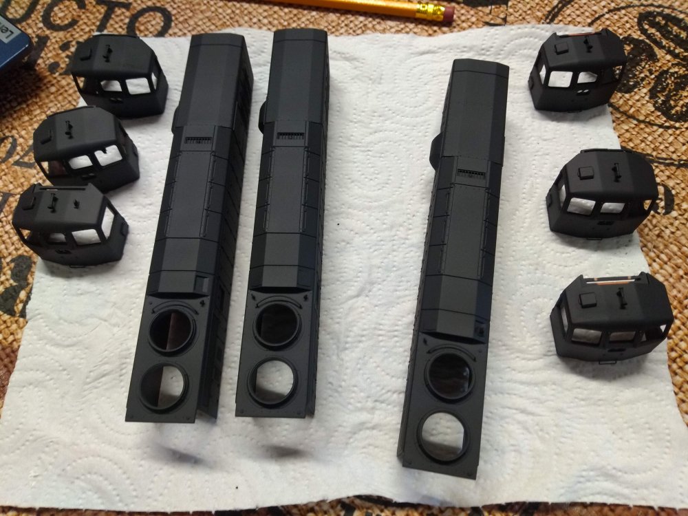

murphaph Posted December 11, 2022 Author Posted December 11, 2022 (edited) Ok so the longest project in the world draws a big step closer to completeion. I was satisfied with a test spray of the laser cut NIR logo on the side of one of the 111s but felt the actual paint job was letting the end result down. I took back down to bare plastic and I ordered Stynelrez primers as an alternative to what I had been working with and I am very glad I did. Priming is a breeze with my setup and these paints. I chose to "zenithal prime" these three, that means priming them all black, then priming the upper surfaces white, so that when painted over, the upper surfaces would be more bleached out due to the effects of the sun. A lot of this will disappear under roof dirt and soot but I wanted to give the technique a try and it works, at least for these darker top colours. I then painted the blue and finally the NIR logo was airbrushed on through the laser cut mask. For me the results are far superior to using a transfer. There's no translucency in the white, it's proper opaque white like the factory finish. It's obviously not quite as good as the factory finish but the actual shape of the logo is closer to the real thing IMHO. I will use the same technique to cut out masks for the yellow warning panels. These were a mare to prepare by hand previously and the result still wasn't as good as I expect to be able to achieve with the laser. It was just too tricky to get the corner radii right/uniform doing it by hand. Edited December 11, 2022 by murphaph 13 4 Quote
