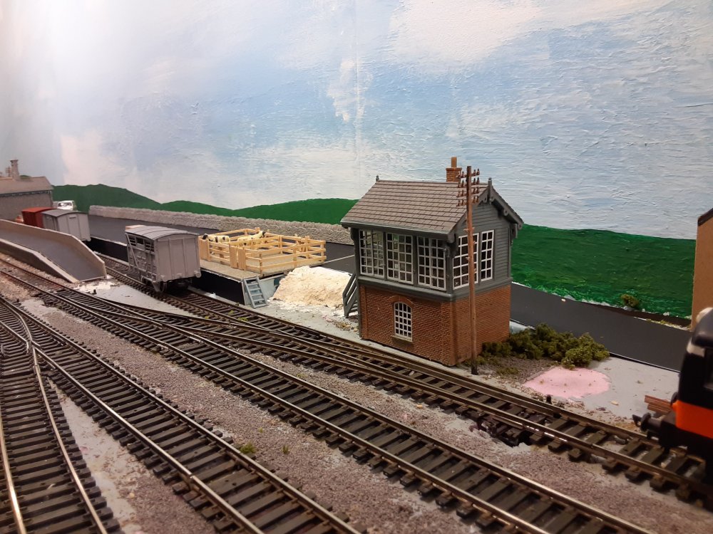

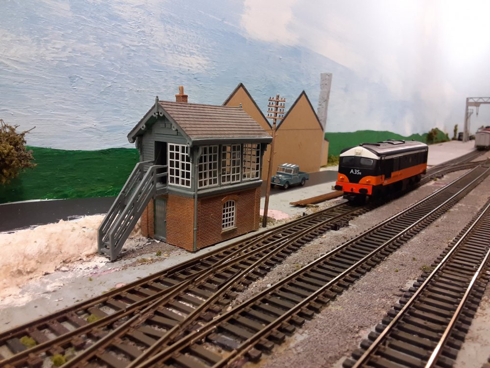

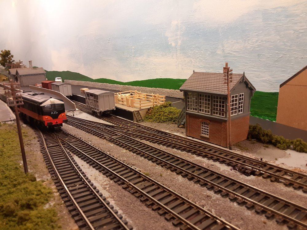

patrick Posted June 1, 2020 Author Posted June 1, 2020 Something I have been putting off for a long time was repainting the green trim on the Bachmann signal cabin grey. The green was much more attractive but grey is prototypical for a railway set in the early seventies 6

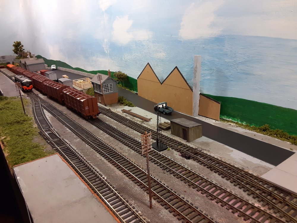

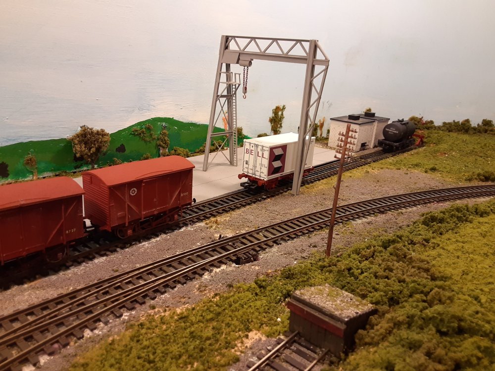

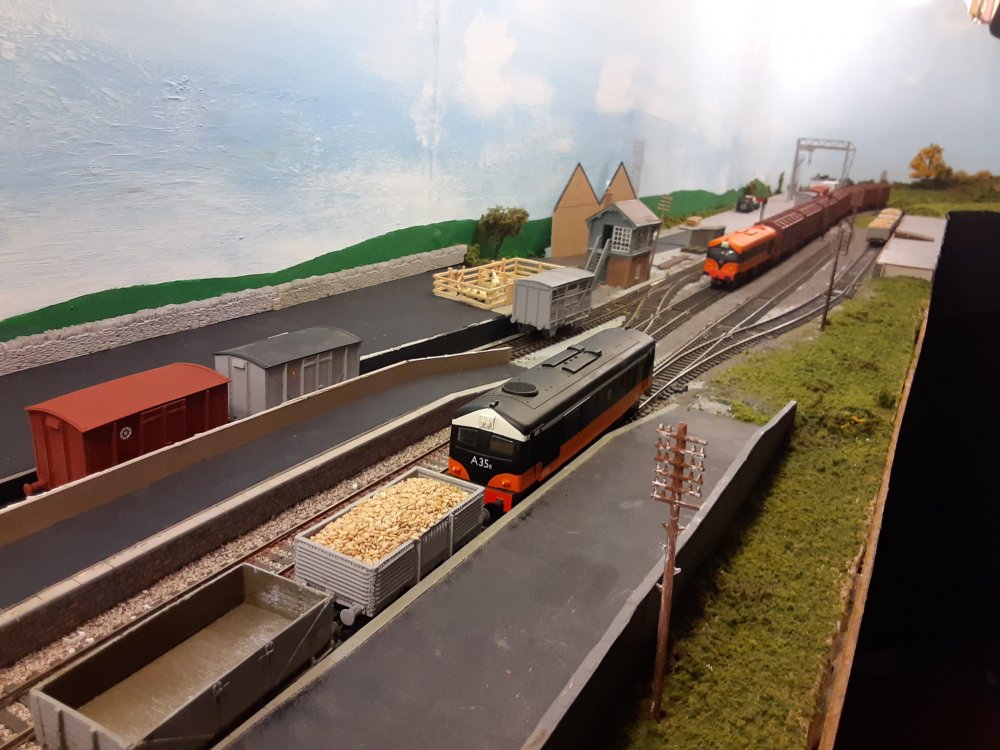

patrick Posted June 2, 2020 Author Posted June 2, 2020 (edited) Finally Glen More is coming together. A major reason to rebuild the station was to provide more shunting possibilities. There are now seven spots to spot wagons. The track behind the passenger platform has an end loading dock, cattle pens and a spot for a yet to be built goods shed. The siding on the North West side has a hard standing, a gantry crane used to load containers of produce from the local co op and a tar bitumen depot. The siding on The South side has a bank for beet loading. John Mayner asked in a previous post which I did not get around to reply to (sorry John) if a card forwarding system was used during operation. Not at present, I write up a switch list telling the train operator which wagons to drop off and pick up at each station. Wagons are blocked in the fiddle yards to facilitate shunting. There is plenty of interesting operation running a pick up goods without resorting to shunting puzzles which I find get tedious quickly. Beet specials drop off an empty for every load picked up. Edited June 2, 2020 by patrick 6

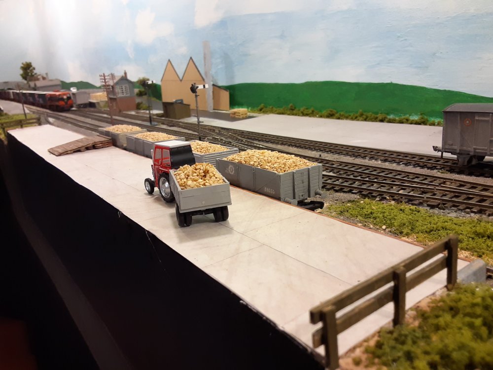

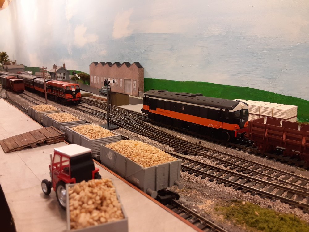

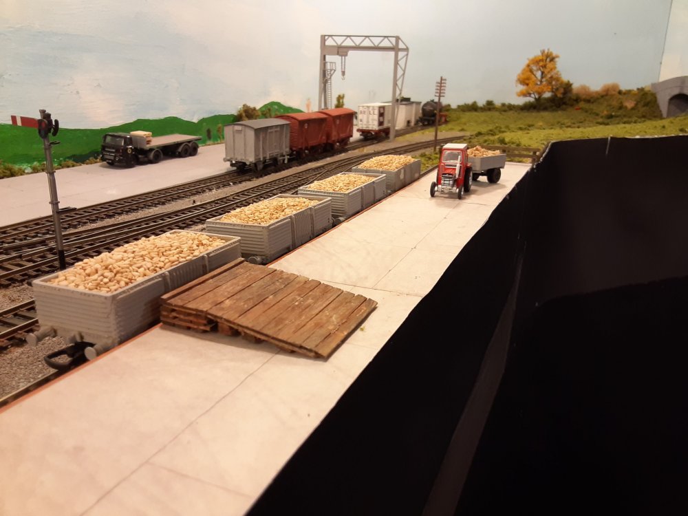

patrick Posted June 4, 2020 Author Posted June 4, 2020 (edited) A farmer waits the arrival of empty beet wagons at Glen More. The platform surface is downloaded Scalescenes concrete ground. Edited June 4, 2020 by patrick 2
Liam_Murph Posted June 4, 2020 Posted June 4, 2020 Are those sunflower or sesame seeds that you are using in the beet wagons?
patrick Posted June 4, 2020 Author Posted June 4, 2020 50 minutes ago, Liam_Murph said: Are those sunflower or sesame seeds that you are using in the beet wagons? The are sesame seeds. They are flat rather than round but look well at normal viewing distances. I must try mixing in some earth colored chalk powder to provide some weathering. 1
Edo Posted June 4, 2020 Posted June 4, 2020 (edited) Patrick - you have the timber beet loading platform just perfect - lovely. Edited June 4, 2020 by Edo

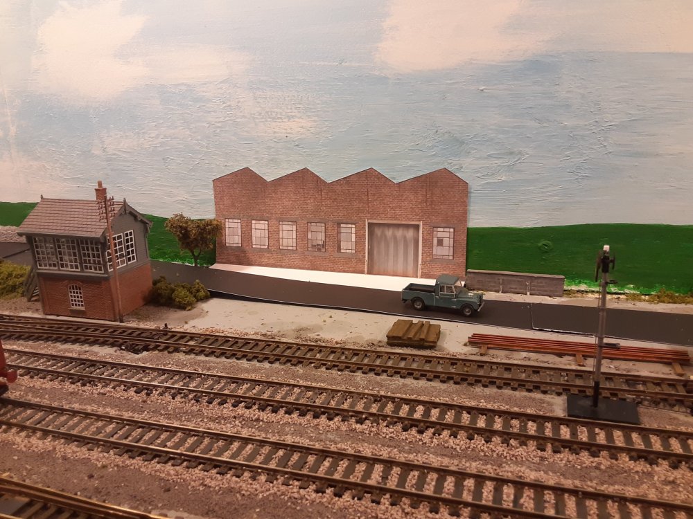

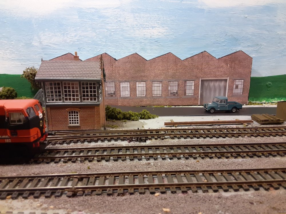

patrick Posted June 4, 2020 Author Posted June 4, 2020 1 hour ago, Edo said: Patrick - you have the timber beet loading platform just perfect. Amazing what can be achieved with a fistful of coffee stirrers and a tube of glue! It was painted/weathered with Woodland Scenics rail tie the marker. Inspired by the Scalescenes downloads I found a picture of a factory online, printed up two copies spliced them togeather to extend the length and glued them to a piece of foam board. I will add some roof and sides to give it depth. It may get replaced some day with a more detailed structure. Meanwhile well worth the effort for an hours work! 6

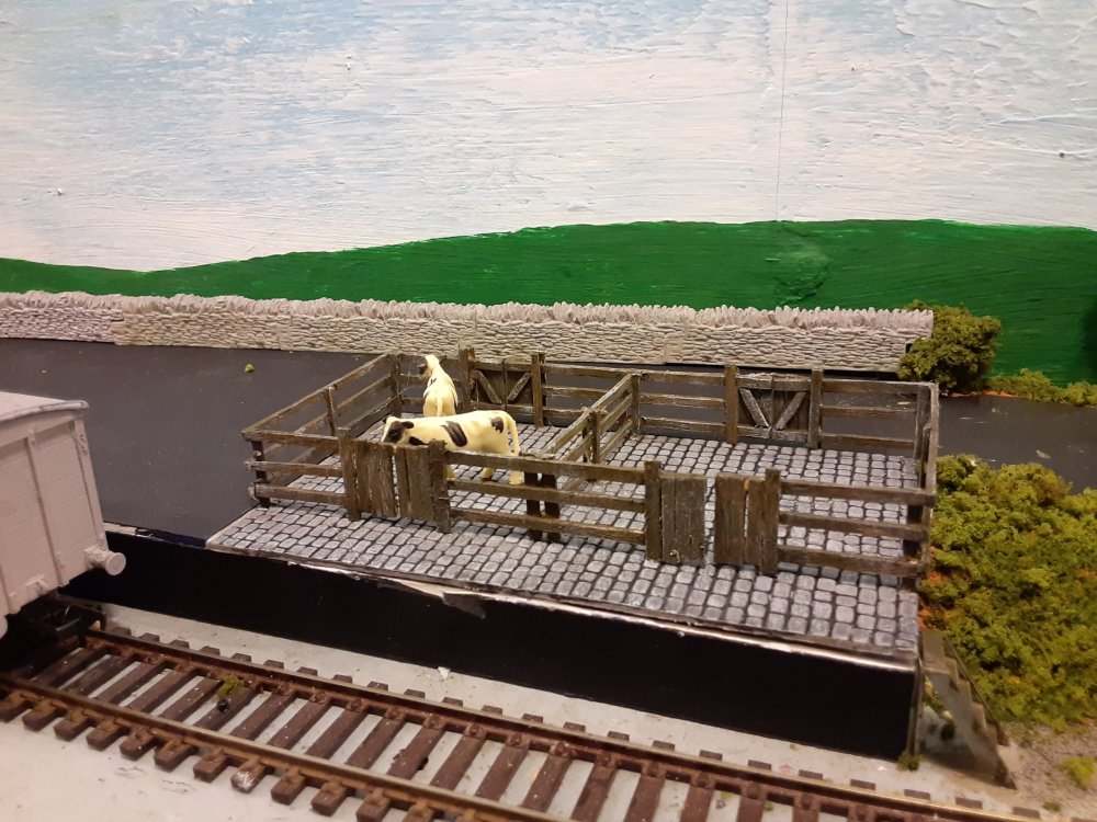

patrick Posted June 12, 2020 Author Posted June 12, 2020 The cattle pens were painted using a Woodland Scenics rail tie brown weathering pen and dry brushed with white poster paint. The cattle are rubber figures I found at the checkout of a local Hobby shop. I dont know if their livery is correct for the geographic location or era. 7
Old Blarney Posted June 12, 2020 Posted June 12, 2020 (edited) Cattle - perhaps - The Irish Moiled - see page - The Irish Moiled Cattle Society. What's your opinion? I do enjoy your posts and your railway. http://www.irishmoiledcattlesociety.com/the-breed/ Edited June 12, 2020 by Old Blarney
patrick Posted June 12, 2020 Author Posted June 12, 2020 6 minutes ago, Old Blarney said: Cattle - perhaps - The Irish Moiled - see page - The Irish Moiled Cattle Society. What's your opinion? I do enjoy your posts and your railway. http://www.irishmoiledcattlesociety.com/the-breed/ My turn to make dinner tonight. I'm thinking steak. 1
patrick Posted June 12, 2020 Author Posted June 12, 2020 (edited) Close enough for me. In any case Leslie's cattle wagons will get all the attention. Edited June 12, 2020 by patrick

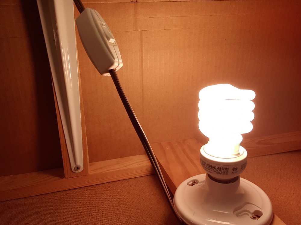

leslie10646 Posted June 12, 2020 Posted June 12, 2020 Patrick, as always it's a treat to see your railway. Watching a few of the videos what struck me was your excellent lighting - you probably told us how somewhere earlier, but maybe you share the info again? Thanks to the lighting, the triangulated chassis on the Bullied opens shows up to advantage. You're one of the few people to have my little Ballast flat and using it as they did - AS A CAR CARRIER. Keep well and prosper Leslie
patrick Posted June 12, 2020 Author Posted June 12, 2020 (edited) The lighting is done with fluorescent light bulbs in cheap holders about 2 foot apart. The layout is located in an area of our condo the previous owner converted from a storage room to what was described as a media room with a multitude of electrical outlets. The bulb holders were wired in parallel using cheap extension chords which provided the wire and plug when I discovered this method was cheaper than buying wire and a plug separately. There are three such circuits covering the layout, each with it's own on/off switch so the entire layout doesn't have to be illuminated when I'm working on it. This assembly is fixed to the pelmet framing and plugged in to one of the many electrical outlets. Edited June 12, 2020 by patrick 3 1

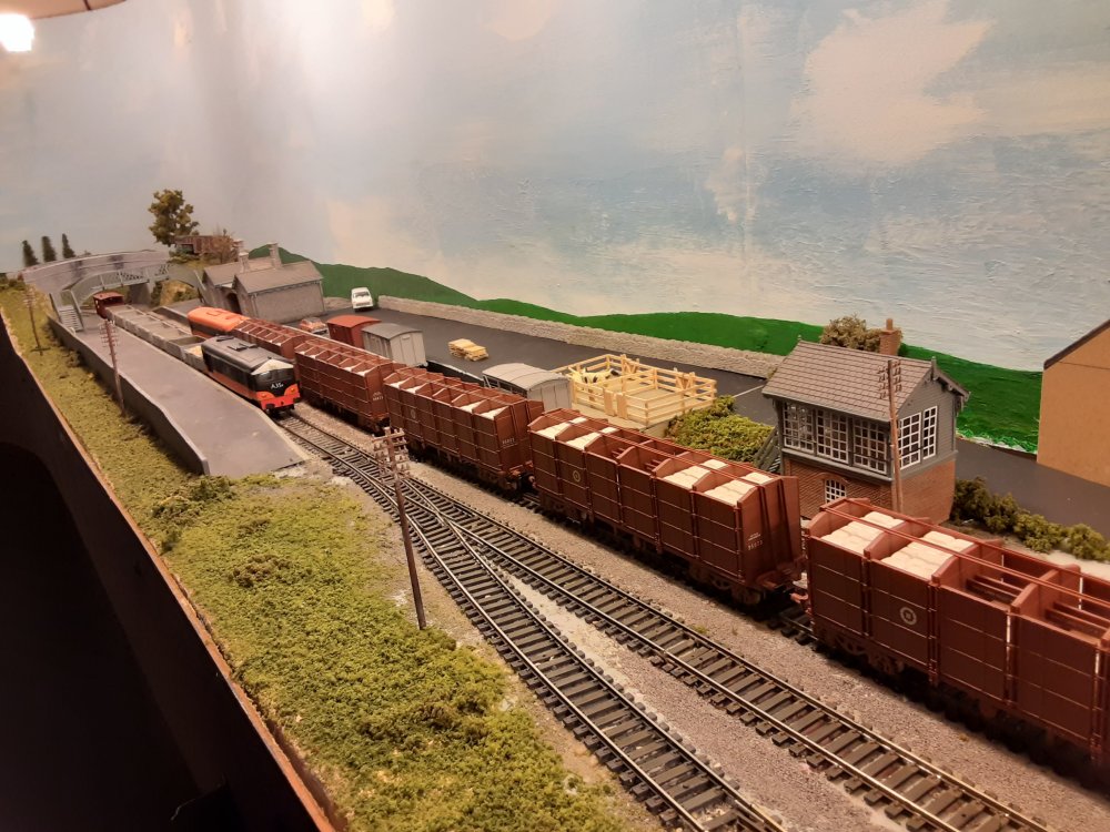

patrick Posted August 28, 2020 Author Posted August 28, 2020 (edited) The layout lay.practically dormant the last few months due to health issues which had me literally off my feet, a complication from an injury to my foot which occurred years ago. Work has resumed this week and ballasting has begun on the rebuilt section of Glen More. Having made some progress I couldn't resist taking a few photos. Here we see a Waterford bound passenger train crossing a pick up goods train which is shunting the yard. Edited August 28, 2020 by patrick 9 1

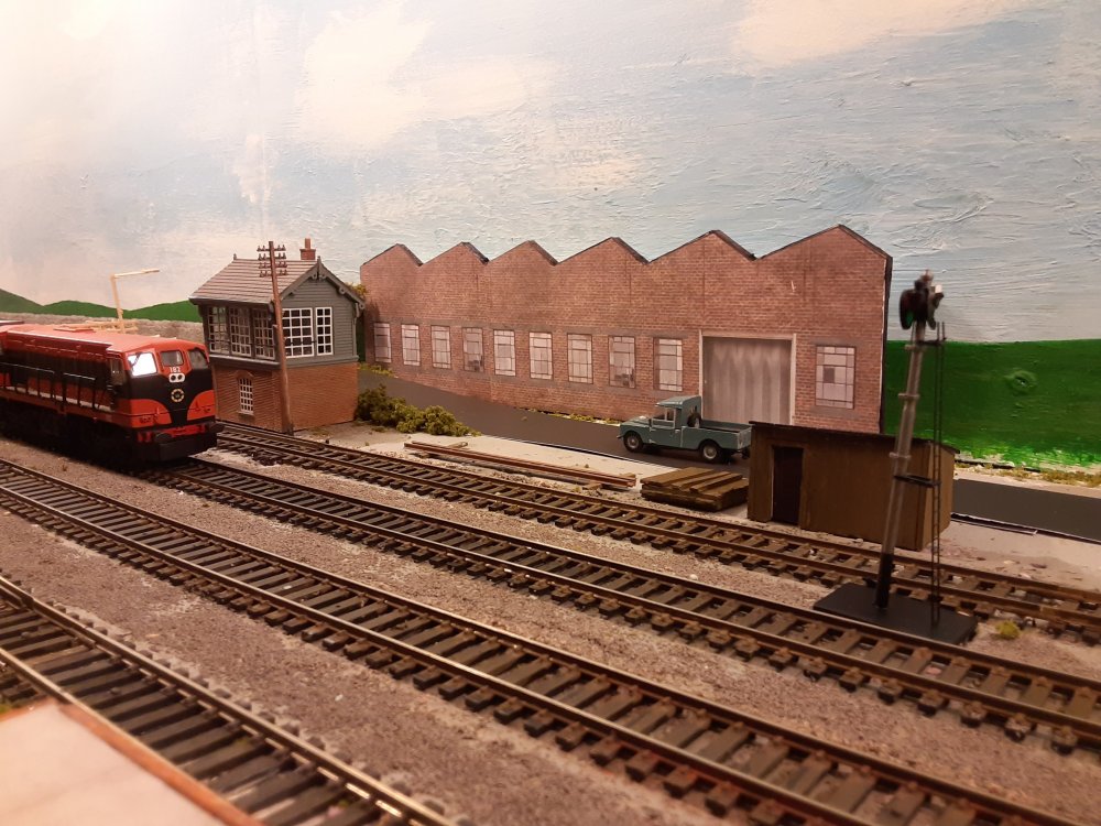

patrick Posted August 29, 2020 Author Posted August 29, 2020 Looking at the previously posted photos I became more and more dissatisfied with the low relief factory building behind the signal cabin at Glen More. It was intended to be a stand in until something better came along but it seemed to overpower the scene. The building was made from a downloadable image mounted on foam board in order to give it some dept. A little experimentation showed that mounting the picture directly to the backdrop and adding some detail to the foreground would look far better. The displaced building did not go to waste. It joined a few surplus buildings which have been placed at the entrance to Cork fiddle yard just for fun and provide some intrest before transitioning to the scenic part of the layout. The structure looks like it could be a loco shed which is appropriate since the track in front of it which in not connected to the layout serves as a dead line for locos which are not yet chipped. 3
