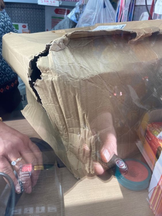

DiveController Posted February 22, 2024 Posted February 22, 2024 On 20/2/2024 at 8:16 AM, Horsetan said: Update: the local post office has found the parcel and we have retrieved it! It does look like it has either been drop-kicked or partly crushed in transit.... Bastardos! 1
Flying Snail Posted February 22, 2024 Posted February 22, 2024 On 20/2/2024 at 2:16 PM, Horsetan said: Update: the local post office has found the parcel and we have retrieved it! It does look like it has either been drop-kicked or partly crushed in transit.... Did they survive intact????
Horsetan Posted February 22, 2024 Posted February 22, 2024 2 hours ago, Flying Snail said: Did they survive intact???? I haven't had time this week to open the wreck of the parcel, but will get round to it on Saturday. It's currently sitting there, looking like the elephant in the room. 1 1

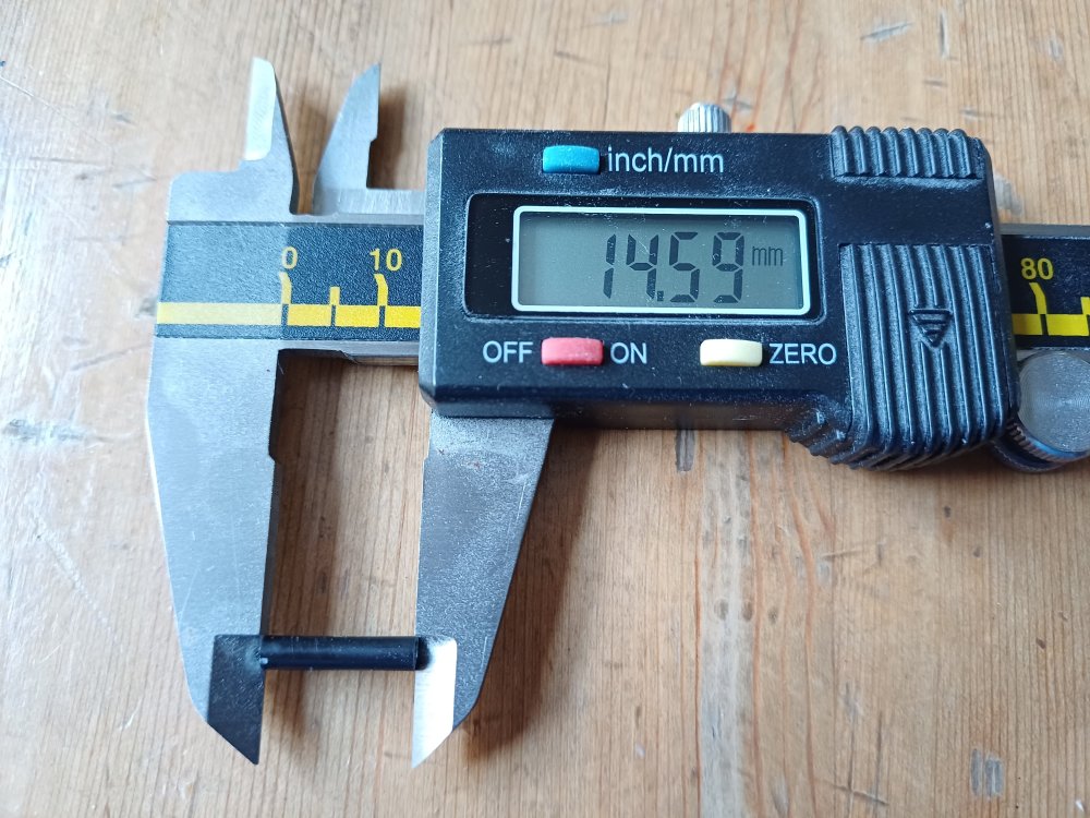

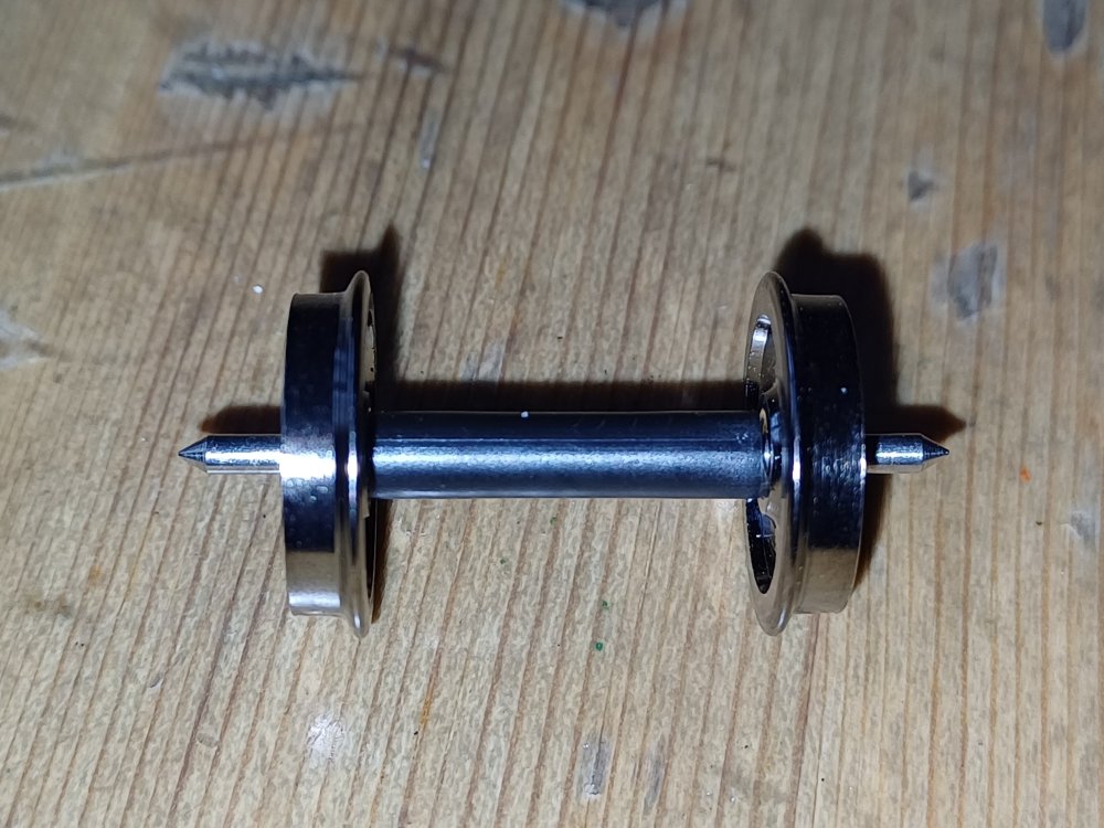

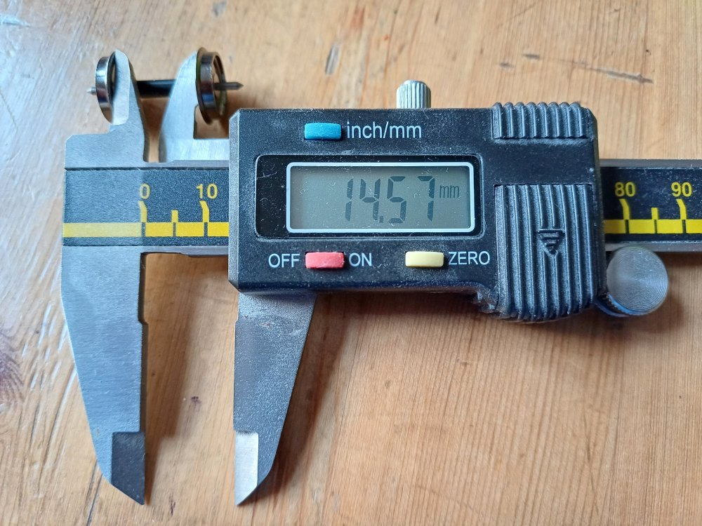

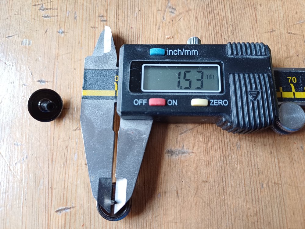

Horsetan Posted March 3, 2024 Posted March 3, 2024 (edited) Digging into the wheelsets a bit further, I found the wheel diameter to be a consistent 12.06mm, with a standard back-to-back set at around 14.57mm... Pinpoint stub axles came out at 1.53mm: ...and the insulated axle muff was found to be virtually the same as the back-to-back measurement: Quite encouraging so far... Edited March 3, 2024 by Horsetan 1
