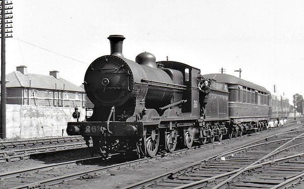

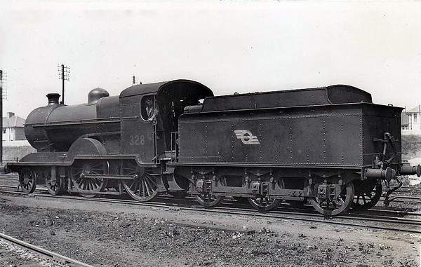

jhb171achill Posted August 11, 2016 Posted August 11, 2016 (edited) Re the links to photos of locos above.... Â The coach behind it certainly isn't a Pullman car, as the caption suggests. Â It is the single most luxurious carriage ever built in Ireland, the former MGWR Ddirector's Saloon, which survived until the early 60s, largely in storage, and retaining fully lined MGWR 1918-25 maroon until the mid 50s, when it got CIE's post-1955 lighter green. Â Disgracefully, CIE scrapped it about 1960-ish. Edited August 11, 2016 by jhb171achill
