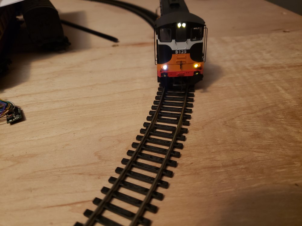

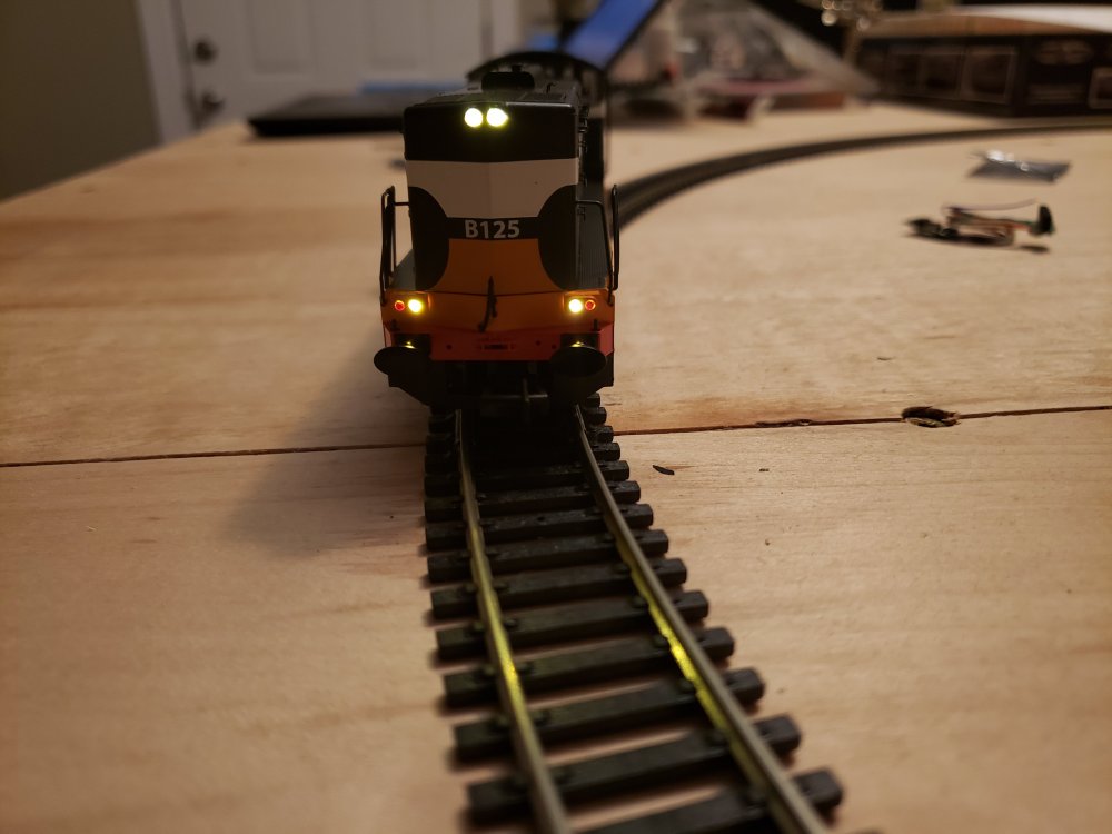

mmie353 Posted December 13, 2020 Posted December 13, 2020 I have gotten 3 of my order for 121's a couple of days ago and one of them MM0121 has no sound coming from it, swapped decoders and still nothing from it. Also a strange color on one of the LEDs from MM0125, the LED on the pic for the right hand side. I just emailed my vendor so see what I can do being in the US on this one. I just hope that the rest of them from what I have ordered are ok. 1
DiveController Posted December 13, 2020 Posted December 13, 2020 (edited) Looks like it has the wrong LED (or LEDS!). I think that B125 should has the 2700K type bulb with the 'warm white' color of an incandescent bulb. I believe that only the 121s with newer LEDs on the prototype should have the 'cool white' color, open to correction on this. What color is on the other end? iirc someone had an issue with a speaker already. I guess this means I need to test run all of mine when I get a sound decoder, irritating if you have more than a couple of loco (although the decoder is easy to get in and out tbh) Edited December 13, 2020 by DiveController 3
mmie353 Posted December 13, 2020 Posted December 13, 2020 (edited) This is the other end dude and I did get it wrong, it is the left one that has the issue from the other end. I am willing to fix the stuff myself if I am allowed to, it would be easier than sending it back to Ireland. Not doing nothing until advised further Edited December 13, 2020 by mmie353 1

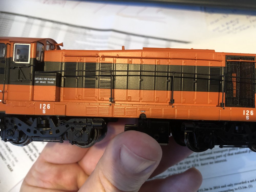

Noel Posted December 13, 2020 Posted December 13, 2020 (edited) On 11/12/2020 at 3:36 PM, Thameslink said: Really delighted with my Supertrain era 126 - only quibble I have is the guard rails have come away from the body in places. Does anyone have some advice on how to pop them back into place? They should go back on fairly easily using a tweezers without the need for glue, and the base of the stanchions nicely friction fit into holes on the side of the walkway. My eyesight is not great so I wear an optivisor to see what goes where. I had to remove the grab rails from my 121s to weather them including the cab door rails, but they went back on again ok. just be gentle. On one of mine the cab door grab rail fell off in transit inside the box, I had to use a micro drill to marginally enlarge the hole above the doors and used the tiniest smear of PVA to secure once pushed back into place. I’ve used a new technique if I ever have to revert to glue when fitting wire parts to models. I put the glue on a piece of plastic bag, hold the part with a tweezers and dip it in the glue to just get the tiniest amount of glue on the end of the wire so when pushed into a body side hole there is no unsightly or messy blob of glue visible. Not neccessary for friction fit parts like walkway rails. I never apply glue using its nozzle directly to a model, a recipient for a mess, instead always indirect transfer using a piece of plastic bag to dip in, or transfer using a cocktail stick. Edited December 13, 2020 by Noel 1
Noel Posted December 13, 2020 Posted December 13, 2020 (edited) 3 hours ago, mmie353 said: This is the other end dude and I did get it wrong, it is the left one that has the issue from the other end. I am willing to fix the stuff myself if I am allowed to, it would be easier than sending it back to Ireland. Not doing nothing until advised further MM have excellent warranty support. They quickly replaced one of my 121s (faulty speaker) a few weeks ago. Obviously I had to pack it up and post it back to them, but being in Ireland I got the replacement back within 3 days. Suggest emailing MM direct for advise. 5 hours ago, K801 said: Thanks Noel. Also, do the 121s have a cab light? No Edited December 13, 2020 by Noel 2

mmie353 Posted December 13, 2020 Posted December 13, 2020 Well besides having issues with my sound on my MM0121, these are pics of the lights I have from it, I am not sure if they are correct that is bothering me. Please feel free to advise

DiveController Posted December 13, 2020 Posted December 13, 2020 2 hours ago, mmie353 said: Well besides having issues with my sound on my MM0121, these are pics of the lights I have from it, I am not sure if they are correct that is bothering me. Please feel free to advise That's also how mine is running. So does anyone know for certain if the 121 prototype had 2 or 3 FUNCTIONAL front white marker lights when delivered please?
