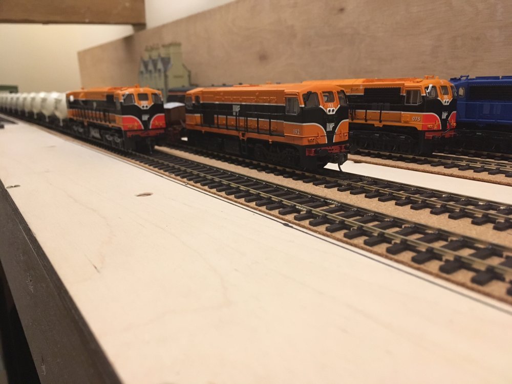

NIRCLASS80 Posted February 24, 2018 Author Posted February 24, 2018 A9FC808B-AA75-47DD-B921-EA15456D1765.MOV Need to start ballast work on the layout.

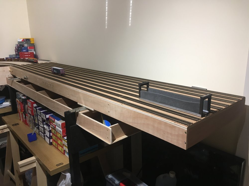

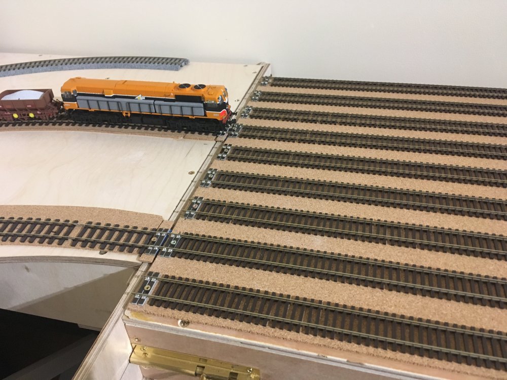

NIRCLASS80 Posted April 25, 2018 Author Posted April 25, 2018 Traverser completed and ready for action. D440A8CA-58E4-4801-B336-072117FCBC21.MOV 7

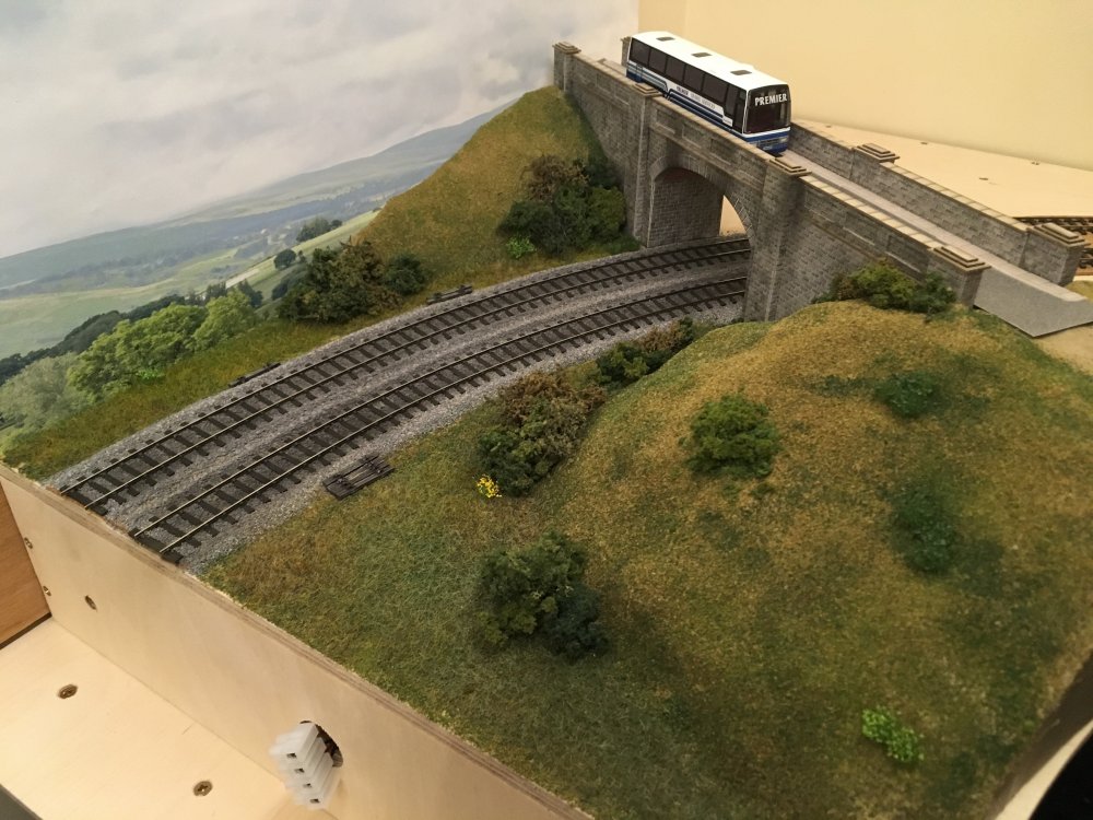

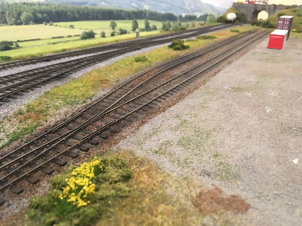

NIRCLASS80 Posted August 27, 2018 Author Posted August 27, 2018 Start made on getting the scenery base done. 6 2

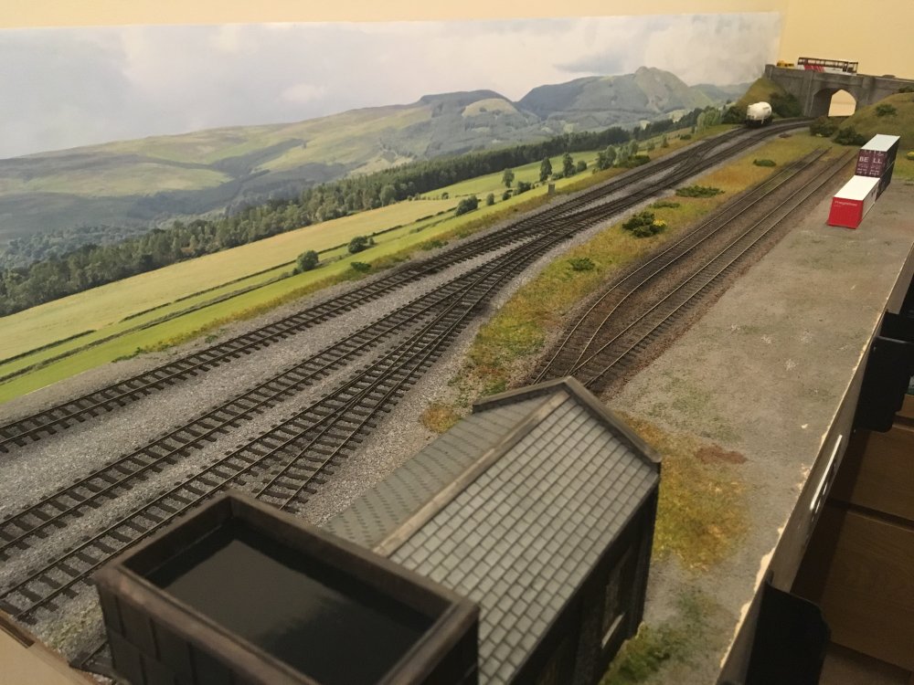

NIRCLASS80 Posted September 8, 2018 Author Posted September 8, 2018 Start made on getting the scenery base done. Board 2 now done. Lots of details to be added 6
