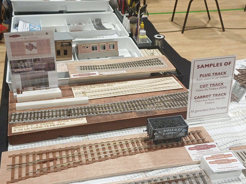

I suspect that the most practical way forward involves Templot and 3D printing.
I think 3D printed track bases for both plain line and turnouts would actually be very easy to produce, with an understanding of Templot and 3D printers. Certainly people are churning them out in other gauges and I think the track gauge is just a simple input parameter to Templot
However, 3D is not my strength. My mind works best with 2D stuff like etches and laser cutting. So I don’t draw in 3D CAD and I don’t have a 3D printing capability.
We do have some people on the forum who are good at 3D printing.

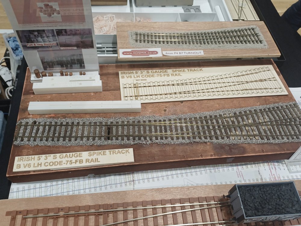

If there is a level of support for 21mm modelling as Dave suggests the first step would be to form a group to promote the gauge, develop an agreed set of standards and commission companies to produce track, drop in wheelsets and other components.
One of the biggest challenges facing a 4mm 5'3" group would be agreeing on a set of standards that would "meet the needs of the many" as Dave put it, in particular the questions of wheel profile, running clearances and minimum radius curve.
Adapting a 5'3" Standard using or derived from one of the "finescale" Standards such as P4 or EMF would potentially involve the costly replacement of the NMRA RP25 wheelsets fitted to the majority or RTR Irish outline locos and stock, a high level of precision in baseboard and track construction and larger minimum radius curves than commonly used in OO.
The majority of my (mainly steam outline) locos and stock run on EMF profile wheels set with a Back to Back dimension of 19.3mm together with a flangeway gap of 1mm through pointwork similarly derived from EM Standards.
Brendan on this forum sets the existing wheelsets on re-gauged IRM to a Back to Back of 19mm, similarly David uses a Back to Back of 19mm on his 7mm 3' Gauge (21mm models) with a 1mm flangeway gap.
The 19.3 B-B based on EM standards may reduce hunting (side to side wobble) and on plain track compared with a 19mm B-B and reduce the risk of a wheel set "dropping down" where the track is slightly wide to gauge.
Personally a 4mm 5'3" track standard derived from the Double O Gauge Association "Intermediate" https://doubleogauge.com/standards/ or NMRA (United States) https://www.nmra.org/index-nmra-standards-and-recommended-practices possibly with the gauge reduced to 20.2 or even 19mm may be a better option to 'meet the needs of the many" than using a P4 or EM derived standard.
The selecting a narrower gauge that 21mm in combination with an "Intermediate" standard would reduce the narrow gauge effect compared with OO, potentially allow smaller radius curves that feasible with EM or P4 and potentially allow scale width steam outline locos to be modelled with plastic injection molded or 3D printed bodies.
Personally I have never seen the absence of ready to lay 21mm gauge track or pointwork an issue, scratch or kit building steam Irish outline locos was always a greater challenge. A lot of my influence came from American modelling where traditionally there was a preference for hand-laid track (spiked to wooden ties) even on Basement Empire style layouts.
Using a bit of lateral thinking a  group could sponsor/commission 5'3" 3D printed or plastic injection molded track bases and custom order 5'3" gauge pointwork through Marcway Models Sheffield https://marcway.net/point.php
Ultrascale could be commissioned to produce "drop in" wheelsets for diesel outline locos, or potentially commission a machine shop to produce replacement stepped axles for the recent generation of RTR locos with revolving roller bearing caps.
David on this Newsgroup commissioned Marcway to produce track and points for both his 7mm Broad and Narrow Gauge Layouts, while modellers in New Zealand have commissioned local manufacturers to produce brass rail and injection molded track bases in a number of scales.
So it can be done if there is sufficient interest and a will, particularly with the availability of "21mm friendly" locos and stock from IRM & MM something that was unimaginable 20 years ago.

With traditional injection moulding there was a huge up-front cost in the tooling, which had to be funded by a society as you say.
But with modern 3D printing technology such as the Templot / Plug track process it's apparently possible to design and print custom turnout and track bases with a few clicks of a button.
I don't think the traditional approach is the only way forward.

While Templot plug track may be suitable for finescale use, a simpler system based on a one piece 3D printed sleeper strip with integral rail fixing is likely to be more attractive for general use particularly those using re-gauged RTR quipment with their existing RP25 wheels pushed out to Irish "Broad Gauge"
Injection moulded plastic flexible track bases may be worth considering a number of UK cottage industry suppliers including SMP(Marcway) C&L produced EM flexible track using plastic bases many years before Peco produced their EM gauge track system in colloboration with the EM Gauge Society.
Similarly a society could comission Marcway to produce a bulk order of 21mm gauge points as opposed to producing 21mm gauge points to order.

For the few parts of the system that used Bullhead then the existing C&L (or similar) injection moulded chairs and sleepers can be used, fairly straight forward with a bit of practice, pre machined crossings and blades are readily available for those that need them and Templot can generate the templates (with a bit of practice or a helpful friend). The pain of doing yards of plain track can be eased with the latest developments in Templot plug/COT track and a home 3d printer (or another friend who has one?).
Flatbottom plain track is feasable with a home FDM 3d printer as my experiments with the S Scale code 75 are showing and no doubt Paul will document his progress on Broombridge in the fullness of time. Even the cheapest of the FDM printers will do it and the material cost (sleepers, not rail!) is just pennies.
Of course back in the "old days" the likes of Mike Sharman, Colin Binnie and Roy Link would have just milled up a simple brass die and squirted hot plastic around the kitchen with their homemade injection moulding machines - in fact Roy did with his 7mm/14mm gauge NG track although that needs the rails spiking down through the pre-moulded holes.
If someone was going to put their hands in their pockets for a  few sleepers worth of injection moulded plain track base is there a consesus on what rail size to use?

A batch of 21mm gauge sleeper bases in production for someone on here who is brave enough to give it a go.
No name, no pack drill🙂
