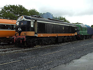

Got the Black Beetle into my C Class. It's 15:1 ratio with 34mm wheelbase and 12mm wheels. It runs very well, i tried pulling 9 wagons and no problem
at all, it could pull more. Along with the other bogie it has all wheel pickup and runs over points well.
This last pic shows the old motor nearest camera, it was a rough runner.
Edited by popeye
When i got it, it was bright orange so i put some brown on it and it looks ok.
The slow running is very good right down to a crawl, but keep the track clean.
