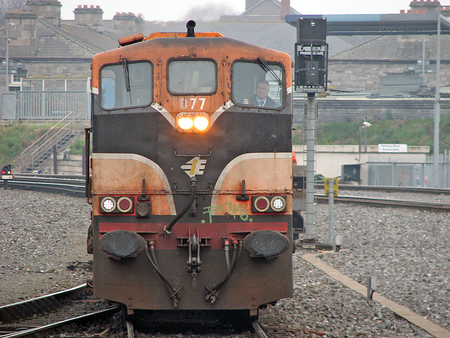

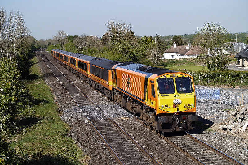

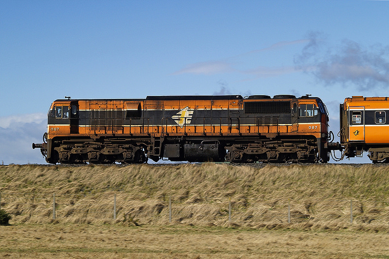

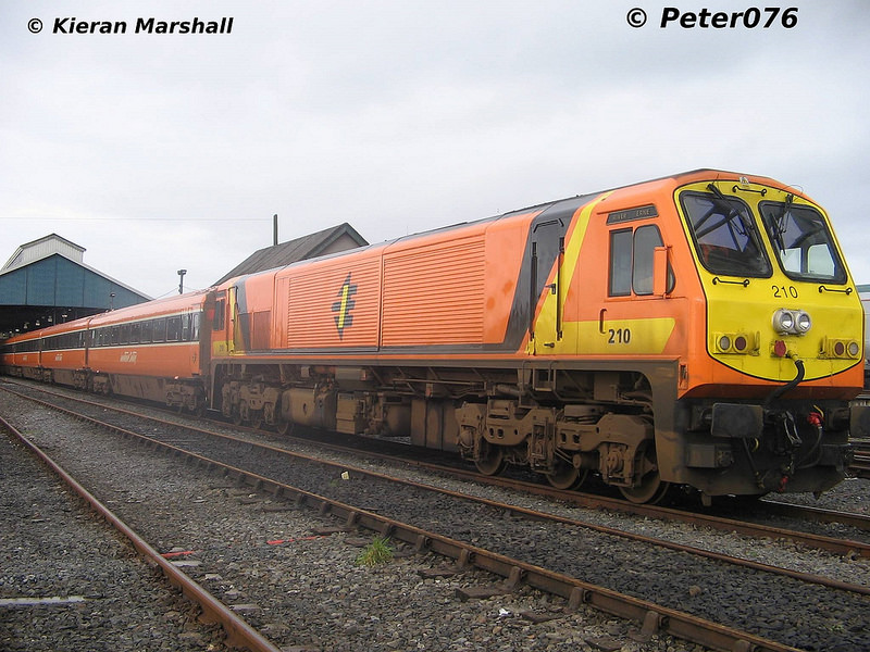

daryl43068 Posted June 6, 2016 Author Posted June 6, 2016 Hi All, Sorry been a bit quiet lately, but I have managed to weather a 201 and a 071. After searching Flickr for reference photos, 201s seemed pretty clean in 2005/2006, with the usual frame dirt underframe and exhaust staining. The 071 turned out slightly dirtier than I planned. Must dash for now, if anyone is interested I can write up my processes in the next few days Cheers Daryl
JasonB Posted June 6, 2016 Posted June 6, 2016 Great job,particularly like 077 nice bit of grime on it

ttc0169 Posted June 6, 2016 Posted June 6, 2016 Impressive weathering in particular on 077,just right and not overdone-well done.
