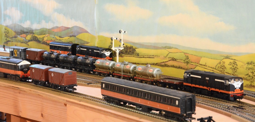

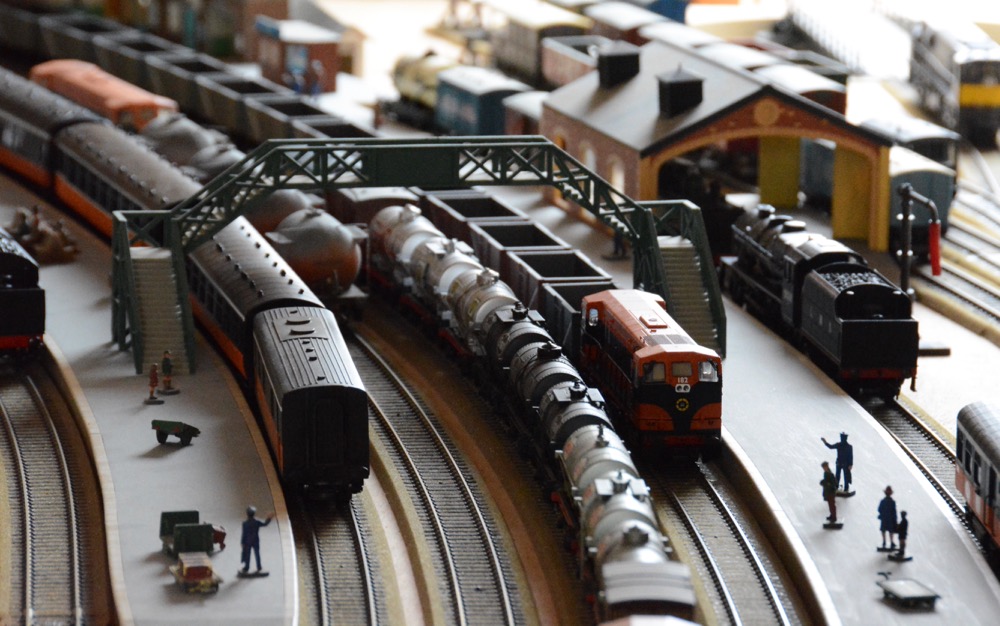

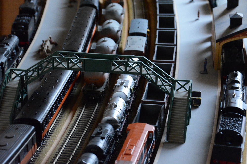

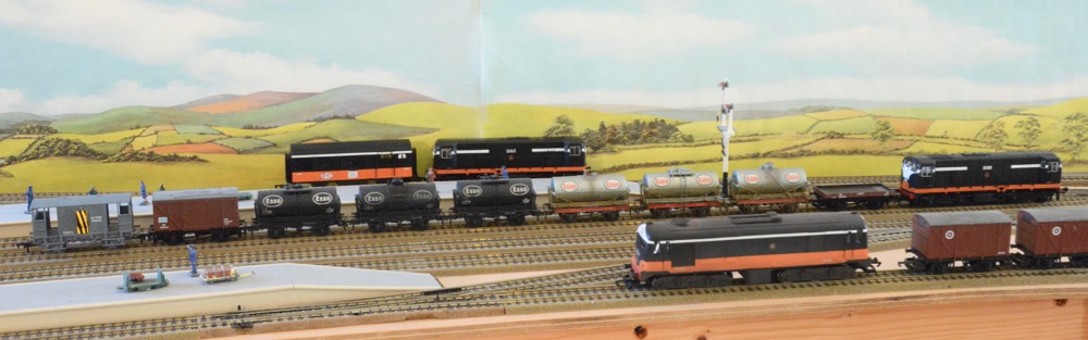

Mayner Posted December 31, 2016 Posted December 31, 2016 Great layout Noel OO at its best! Reminds me of some of the plans in CJ Freezers plan book for larger layouts and the Rev Edward Beal's West Midland Railway. One word with the tank train if its carrying Class A (petrol) should have at least a couple of vans or mineral wagons as barriers between the tank wagons loco & guards van. At one time CIE used a nice rake of silver Texaco tank wagons on the North Wall-Inchacore oil train
Kirley Posted January 1, 2017 Posted January 1, 2017 Always something special about a train of Tank Wagons

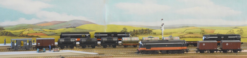

Noel Posted January 2, 2017 Author Posted January 2, 2017 (edited) Great layout Noel OO at its best! Reminds me of some of the plans in CJ Freezers plan book for larger layouts and the Rev Edward Beal's West Midland Railway. One word with the tank train, if its carrying Class A (petrol) should have at least a couple of vans or mineral wagons as barriers between the tank wagons loco & guards van. At one time CIE used a nice rake of silver Texaco tank wagons on the North Wall-Inchacore oil train Thanks John. Its a very long slow process. Safety measures now in place with barriers as per your helpful advice. The track work is Peco code 100, but I hope to lay code 75 on the lower branch line level. Barriers in place Black'n'tan service has been resumed Side profile view rather than modeller overhead Edited July 21, 2017 by Noel

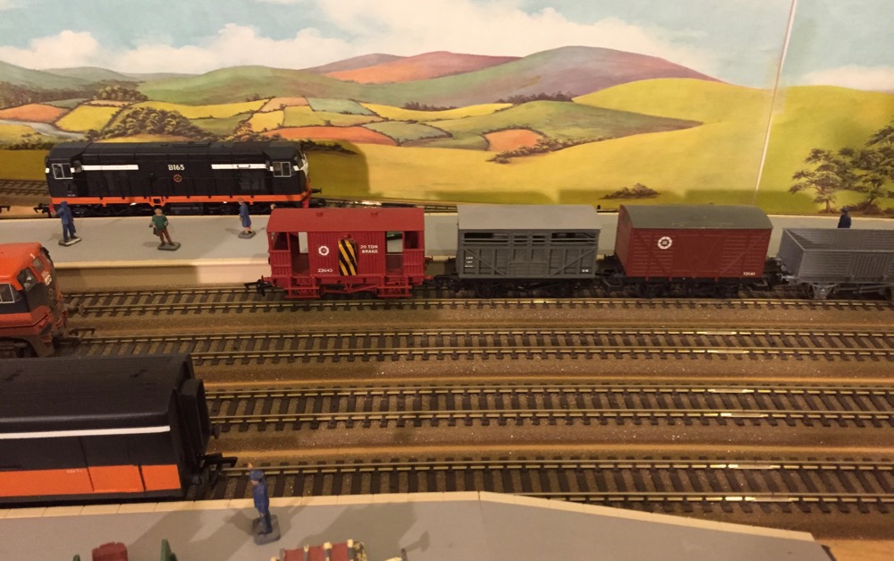

Noel Posted February 1, 2017 Author Posted February 1, 2017 (edited) Some activity with new rolling stock arrivals on layout this evening. Irish Freight models - 20 ton brake van - I just love these brake vans Irish Freight models - CIE Bulleid Heat Van (on test track bed sample) - A welcome addition from my favourite era Edited July 21, 2017 by Noel
roxyguy Posted February 3, 2017 Posted February 3, 2017 Love it, especially the mix of the different rolling stock.

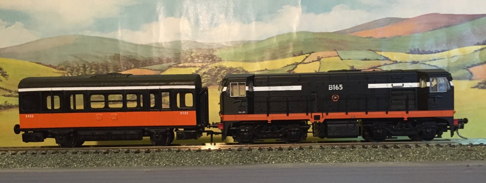

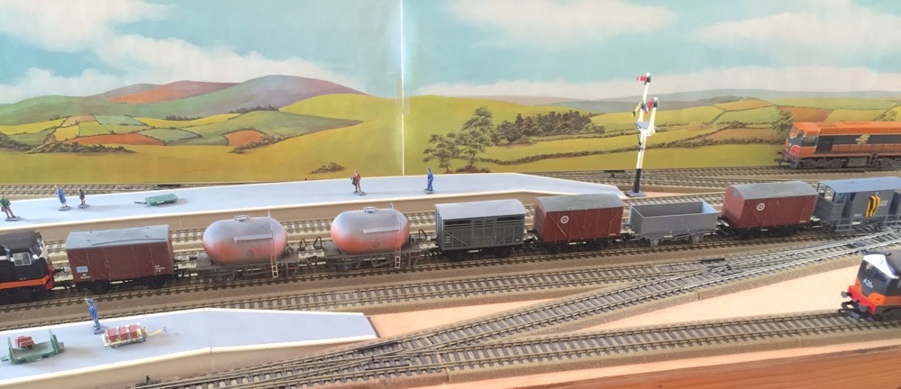

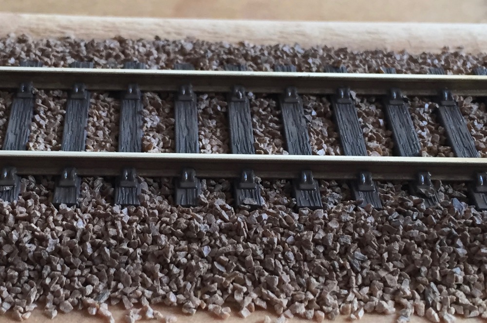

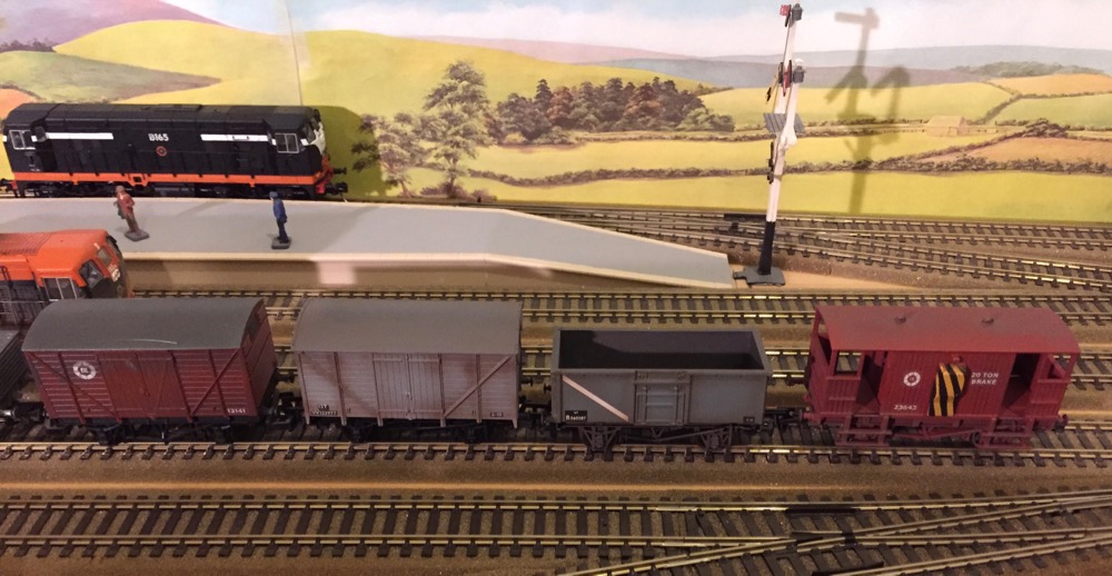

Noel Posted February 19, 2017 Author Posted February 19, 2017 (edited) Enjoyed a running session earlier with mixed goods traffic. Have been busy experimenting with air brush on some old rolling stock and off cuts of plasticard, trying different paint colours and weathering experiments. Jeepers it takes a while to setup each spray session and even longer to clean up afterwards. Also continuing experiments with different ballast mixes and track beds. Below Woodland Scenics medium buff ballast on top of 3mm foam track bed, over sprayed with dusting of RailMatch sleeper grime. This is my favourite so far as I think I will prefer the warmer colour of track ballasted this way to contrast with greenery rather than more authentic grey and green. Edited July 21, 2017 by Noel lexdysia
Sulzer201 Posted February 19, 2017 Posted February 19, 2017 Lovely train of mixed wagons and the bo bo in the b&w livery. Great job on the pw, it looks very realistic.
Noel Posted February 20, 2017 Author Posted February 20, 2017 Lovely train of mixed wagons and the bo bo in the b&w livery. Great job on the pw, it looks very realistic. Thanks. I've started to convert some of the Bachmann BR rolling stock to a semi-irish look (poetic license) and weather some recently accrued Irish wagons as well as old lima vans, and a few kits to finish, and some of Leslie's. I just adore the look and operations of pre 1975 goods trains, pick up freight, and all that interesting shunting which is great fun with a sound equipped baby GM. Old proverb from my nostalgia memory - "If it doesn't have an engine at the front and brake van and the end - the train had its end bitten off by a shark" Nice work, well done Noel Thanks Noel. It's slow progress, but getting there gradually. The tooling up, learning and experimentation has been fun. I lapse into playing trains too much, when I should be cutting, painting and gluing more. I'd really like to get the embankments shaped in foam and plaster cloth the in the next month or so.

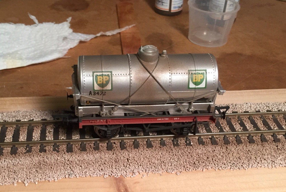

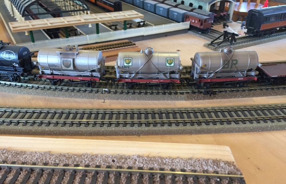

Noel Posted March 2, 2017 Author Posted March 2, 2017 (edited) Bought some of these Bachmann early era tanker wagons on eBay over the past few years. Gave these three a very light dusting of weathering, just enough to take the shine off them. The under frames need more work and a bit of oil spill colouring, but its fun experimenting with the air brush. I have an awful lot to learn. Bachmann oil wagons after the shine was taken off them I am using some old Triang and Hornby wagons as test beds so I don't risk making a mess of the lovely Bachmann wagons. Edited July 21, 2017 by Noel

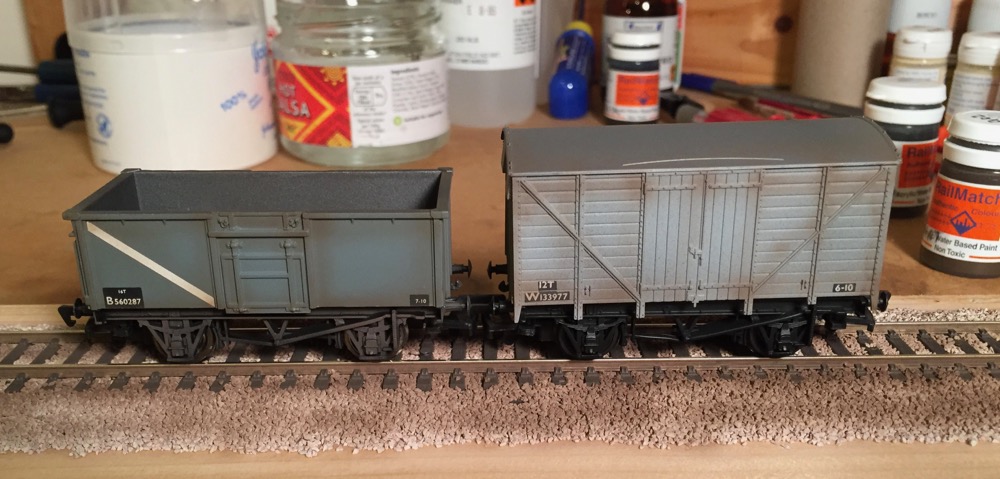

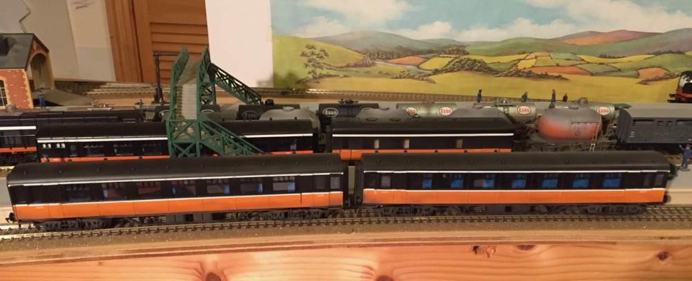

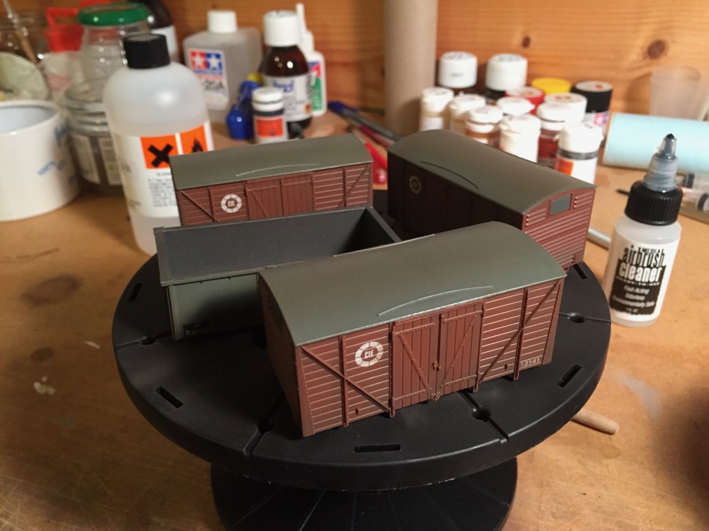

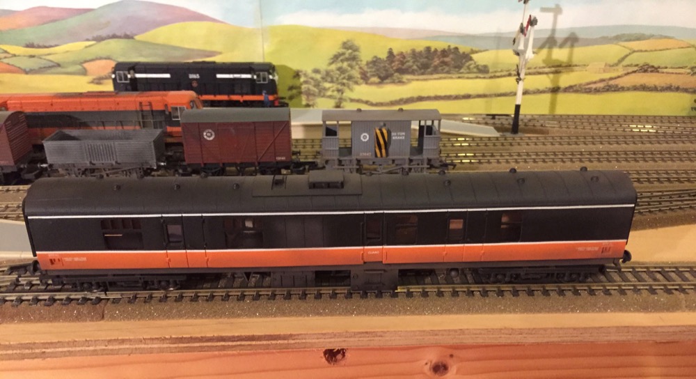

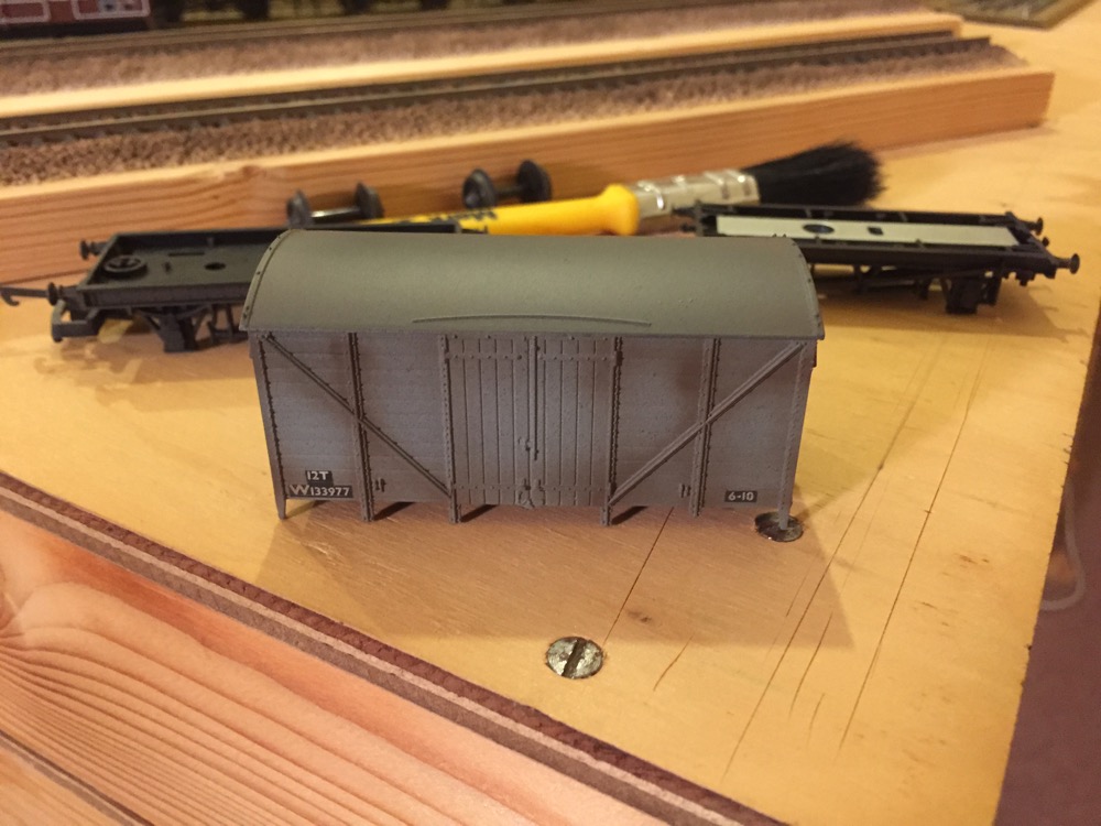

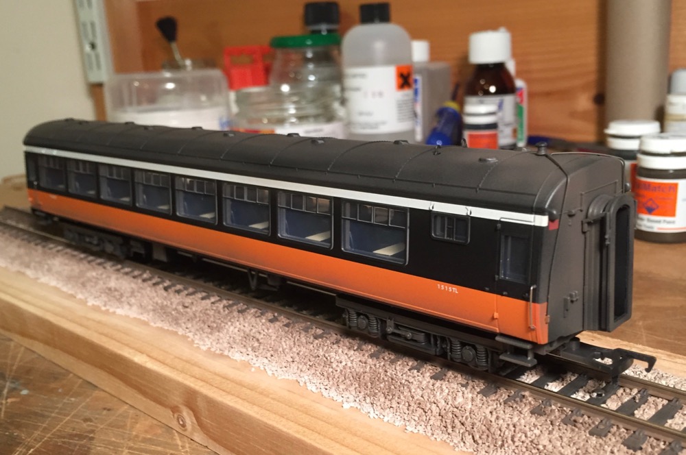

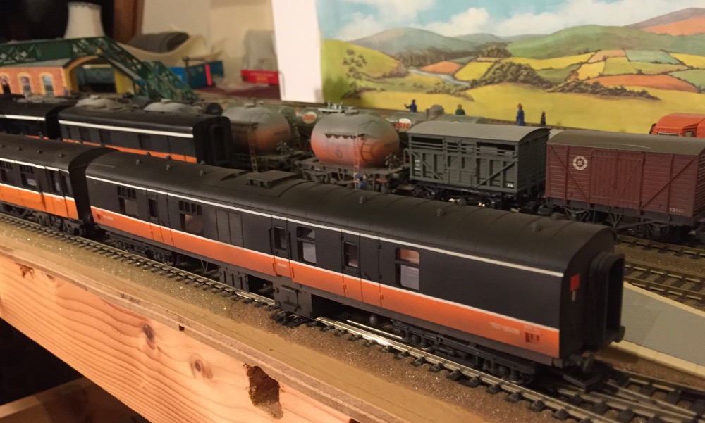

Noel Posted March 2, 2017 Author Posted March 2, 2017 (edited) This weathering milarky is addictive! I'm a complete beginner but it is SO much fun experimenting and learning by trial and error. Lots more to learn. Tonight got 7 wagons lightly dusted and 6 coaches gently weathered (1xCraven, 3xPark Royals, 1xGSV, 1xMk2a). Found it easiest to take wagons off their base and remove wheels Still have to do the chassis on the van. I don't want wagons to look too dirty or like they are close to scrap heap, just in use and slightly weathered so they don't look like they came out of the box looking all shiny and new. Lima - Vans Silverfox - GSV (the weathering dulled the bright orange of these RTR models) Murphy Model - Craven Irish Freight Models - Park Royals (the weathering dulled the bright orange of these lovely RTR models) Assorted goods wagons very lightly dusted to get the toy shine off them GSV very lightly weathered Craven with the shine removed This really is addictive and the temptation is to keep going and add too much. Next trial will be a wash on mineral wagons, over sprayed with light dusting of grime. After that its the IFM laminates that need dulling down. Have made so many mistakes, and made more than a few messes with the airbrush, clogging it up on a few occasions, but with experimentation have found more ways to keep it spraying without dismantling to clean nozzle and needle every time it blocks. Two main lessons I have discovered so far are to spray little and often over the same areas, and don't let the airbrush sit for long between uses or the paint in the nozzle dries. So far I am mixing the thinners and paint directly in the cup using an eye dropper to mix approx 50/50% (thinners in cup first, then paint, then mix with paint brush handle, then back flush by blocking nozzle with finger to mix paint). I'm sure I am probably doing much this incorrectly but it is so much fun. Hopefully when I get more used to the airbrush I will have a go at weathering a rake of MM orange roofed mk2's. Torn between using a light dusting of roof dirt on the roofs, or using a wash, wipe it off, and then a dusting of roof dirt with the spray. Edited July 21, 2017 by Noel
RobertRoche Posted March 2, 2017 Posted March 2, 2017 This weathering looks good! I especially like the GSV, but then again I do like orange things
jhb171achill Posted March 2, 2017 Posted March 2, 2017 Very well done.....tip...on wagons, chassis, wheels, couplings, etc., usually pretty heavily weathered. The body would always be less weathered than this. The roofs quite heavily weathered too... Great job!
Glenderg Posted March 3, 2017 Posted March 3, 2017 Lol, your mixing method is unorthodox! Why not make up a jar of what you need? Perfect mix is the 1 second drop test. If the blob of paint hangs and then drops, within a second, that's the right blend. Too fast, or too slow, and something will break. If you go too high up the tumblehome with weathering, you can always use white spirit on a make up sponge to draw some off, and leave the jagged lines of muck you see. It's and endless challenge though. Have fun. R. edit - wait until you discover washes.....
burnthebox Posted March 3, 2017 Posted March 3, 2017 Noel, looking really good on that weathering, I read somewhere LESS IS MORE when weathering, so your going in the right direction, keep those pics coming
Noel Posted March 3, 2017 Author Posted March 3, 2017 (edited) Very well done.....tip...on wagons, chassis, wheels, couplings, etc., usually pretty heavily weathered. The body would always be less weathered than this. The roofs quite heavily weathered too... Great job! Thanks JB, thanks for the tip. I'm going to give the chassis under frames another coat. I'll need to find 'colour' photos if possible of H-Vans and their roofs as they would have been in the 60s and 70s. Lol, your mixing method is unorthodox! Why not make up a jar of what you need? Perfect mix is the 1 second drop test. If the blob of paint hangs and then drops, within a second, that's the right blend. Too fast, or too slow, and something will break. If you go too high up the tumblehome with weathering, you can always use white spirit on a make up sponge to draw some off, and leave the jagged lines of muck you see. It's and endless challenge though. Have fun. edit - wait until you discover washes..... Cheers Obi Wan (Richie). Yea the mixing in the cup idea came from watching loads of youtube's especially Everard Junction and a few others. Thanks for the 1 second tip. Just today I picked up a few mixing bottles from JM (thanks btw) so in future will pre-mix thinners and paint. I have a tin of precision paints 'CIE Golden Brown' enamel, but I want to try and stick with acrylics so I'm going to try and mix a few colours to get a 1960s 'tan' colour for some resprays. Tried the 'wash' already on some Hornby Mk2a's and made a bit of a hash of it so its off to the 'coach cleaners' and start again. Lovely weathering there Noel, well done. Noel, looking really good on that weathering, I read somewhere LESS IS MORE when weathering, so your going in the right direction, keep those pics coming Thanks guys, its very novice, but its a start and more importantly I'm really having fun. Apprehensive about next up which is to attempt a MM 141, but I'll just have to risk it. After that some retaining walls, and then the orange roofed MM Mk2d's. Question: When sealing this lot with matt acrylic varnish, should I use it straight out of the jar, or thin it 50/50%? PS: I'm beginning to wonder if I should thin the acrylic paints 40/60% (paint/thinner) rather than 50/50. Edited March 3, 2017 by Noel
ttc0169 Posted March 4, 2017 Posted March 4, 2017 My kind of weathering-nothing overdone and just right for the Park royals and Cravens, nice one Noel.
popeye Posted March 4, 2017 Posted March 4, 2017 Love the weathering, it does turn a plastic model into something more real. You will learn as you do more. BTW i believe that you can't mix thinners with acrylic paint, just use water. Also with acrylic wash the airbrush with warm water.
