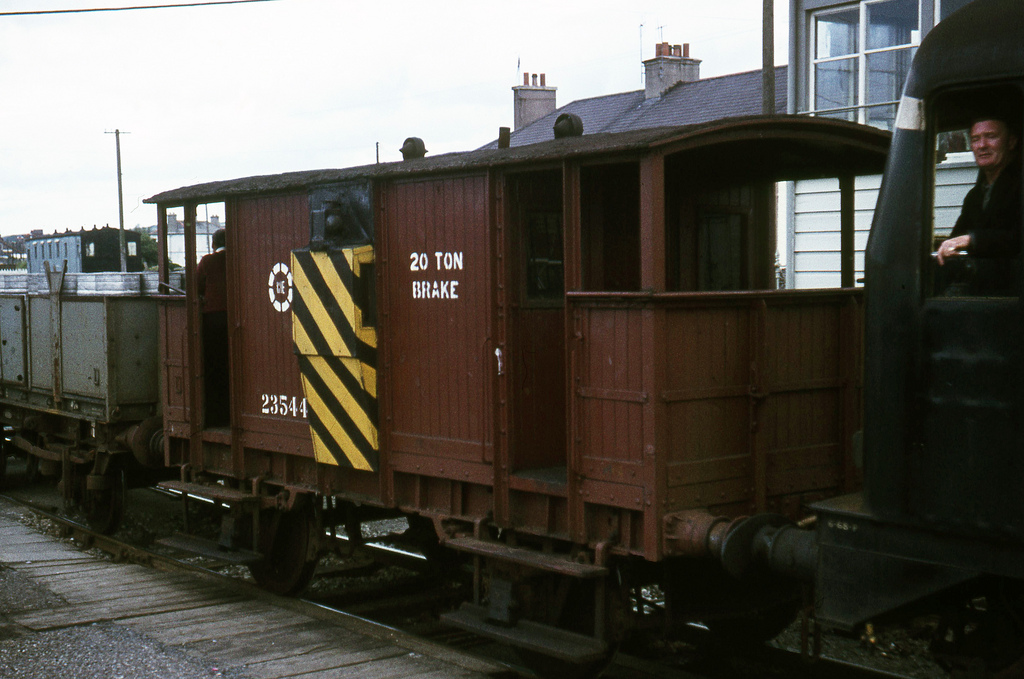

Glenderg Posted April 23, 2013 Author Posted April 23, 2013 Cheers lads, I'll get some natural daylight photos when I can. The gouache has really brought some "plain jane" models to life, even sheep dipped (as JHB would say) in a charcoal grey bath. The kit is a doozy to put together if you take your time with the instructions, and I'm looking forward to doing another one in the grey 20 ton variant, with longer duckets and the rivetted end panels. Quote

Hunslet 102 Posted April 23, 2013 Posted April 23, 2013 Yeah Thump, you blob on a rice shaped bit, and use a wet brush to push it into the corners, really heavy and crude. When it dries in a few minutes, run the wet brush over it again and take the heavier stuff off. Keep repeating as much as you need, and if it goes wrong, wash the model and start again! R Superb build and weathering Glenderg,an excellent finish has been achieved.Most weathering technique's I have tried in the past have generally failed,but thidthen seems like a fail safe solution,must look into trying this stuff. Also,would be interested in hearing how you are going to tackle the 20 ton van from the SSM kit,as I have been looking at different avenue's to doing one of these van but never thought of using another 30 ton van as a solution. Quote
