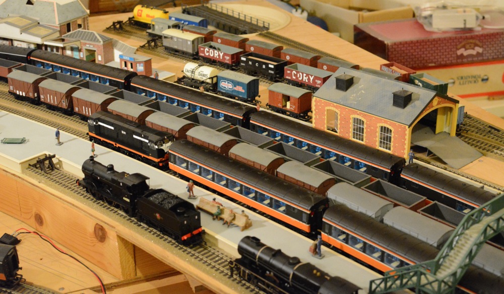

Noel Posted November 22, 2014 Author Posted November 22, 2014 (edited) . . . and stock, lot's of it to run on it as well . . . Thanks BTB. Glad you like the video. I've been collecting BR outline stock for over 45 years, but delighted to have got some proper Irish trains running instead of the GWR, LMS and LNER stuff I've collected over the years. Paddy Murphy's stunning GM locos and coaches was the trigger that got me back into this wonderful hobby this year. Looks and sounds great Noel, I'm looking forward to seeing your layout progress. Cheers guys - I'm hoping to progress the scenery over the next 4 months. There is a danger I might spend too much time 'playing' with it instead of working on it. Some wiring to be tidied up, and few more DCC power drops, a bit of wiring on the upper level so I can switch it to DC to run-in locos, and also run old stock that I won't convert to DCC. I have a lot to learn still about all the new techniques and materials that have emerged in the past 20 years. Some of the scenic work, modelling, painting and weathering work by forumites that I have seen on this site is simply inspiring. I am also in awe at what DCC has enabled in terms of layout operation, and DCC sound has me hooked like a baby on hot milk. PS: Yes I have a weakness for long trains, just very very fortunate to have the space for them. Edited November 22, 2014 by Noel

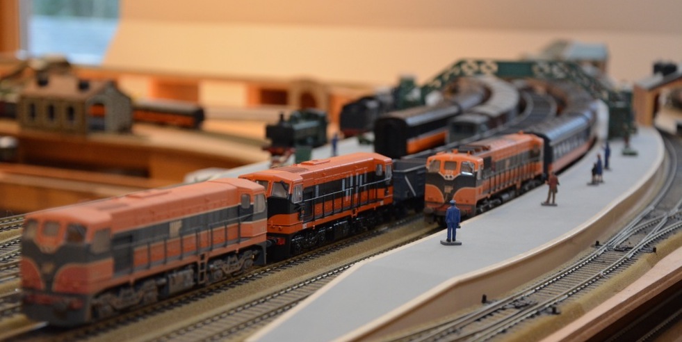

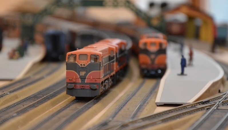

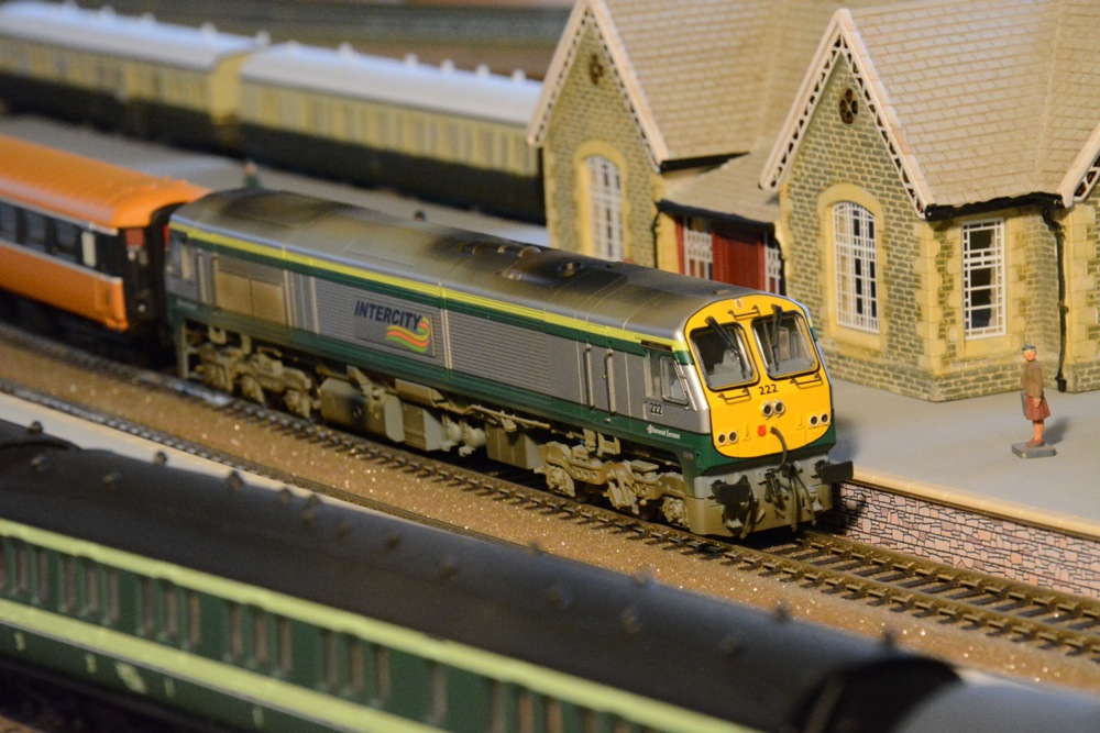

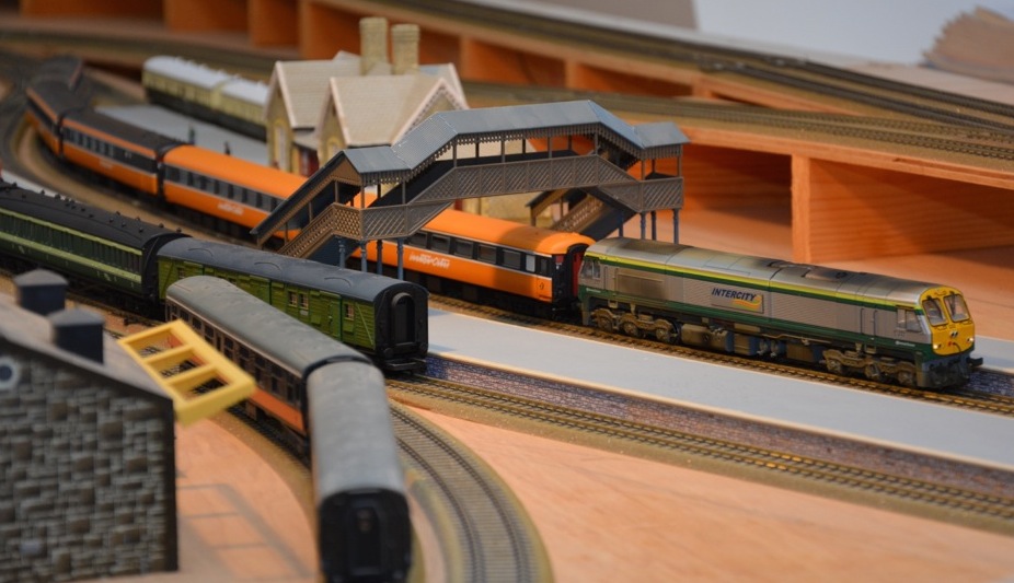

Noel Posted December 23, 2014 Author Posted December 23, 2014 (edited) Foam hot wire cutters has arrived, a supply of foam insulation board and plaster cloth ready to start work on embankments and sections of landscaping over the Christmas break. GMs - detailing yet to be added after speakers installed. I have become a fan of operating GM pairs - consists Newest arrival 'Dargle River' Hopefully the background of this photo will look a little better in a few weeks time when its greened up a little. Edited July 21, 2017 by Noel
Dave Posted December 23, 2014 Posted December 23, 2014 Looks good Noel, I love double heading the baby GM's. Also love the 222, I'm not a fan of the 201's but I do like that livery and must get one. Looking forward to seeing the scenery develop. It will ad a whole new dimension to your layout.
Noel Posted December 24, 2014 Author Posted December 24, 2014 (edited) Looks good Noel, I love double heading the baby GM's. Also love the 222, I'm not a fan of the 201's but I do like that livery and must get one. Looking forward to seeing the scenery develop. It will ad a whole new dimension to your layout.Hi Dave. Like you I'm not a fan of real 201s, but I do like that livery and we've travelled quite a bit behind green/silver 201s in mk4s since our RTA a few years ago, so had to get one and very glad I did. Looking forward to rolling up my sleeves and getting stuck into making a start on the scenery in the next few weeks. But for me the baby GMs double heading is what they did so well on passenger and freight work and look great on the scaled down confines of a layout. Noel Edited December 24, 2014 by Noel

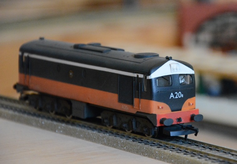

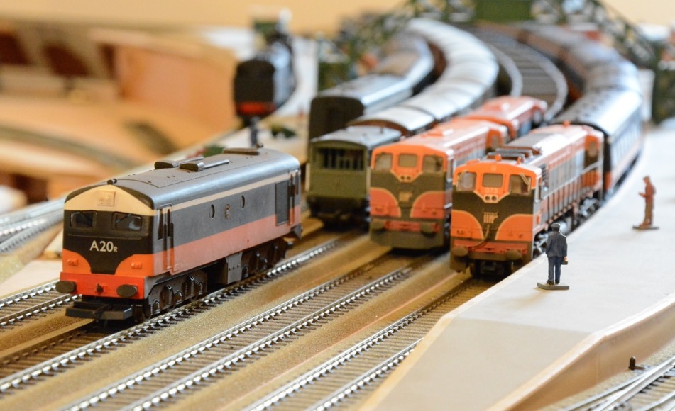

Noel Posted January 19, 2015 Author Posted January 19, 2015 (edited) Black and tan A class arrived at Kingsbridge this evening. The white splash above the cab windows needs to be corrected, but a nice addition to the layout. Edited July 21, 2017 by Noel
Killucan2 Posted January 19, 2015 Posted January 19, 2015 Black and tan A class arrived at Kingsbridge this evening. The white splash above the cab windows needs to be corrected, but a nice addition to the layout. Plus the black needs cutting back.
Blaine Posted January 19, 2015 Posted January 19, 2015 The white splash above the cab windows needs to be corrected, but a nice addition to the layout. Bit more than that needed and no...
Alan564017 Posted January 20, 2015 Posted January 20, 2015 Noel, firstly what a fabulous layout, locos and carraiges, one day when I get my backside off the couch.....Can I ask, I presume the black and tan A class is an SF model, what type of chip did you put into it and did you have to adjust any of the CV settings? Also how long did you have to wait for the SF model, Im considering getting one this year.
Noel Posted January 20, 2015 Author Posted January 20, 2015 Noel, firstly what a fabulous layout, locos and carraiges, one day when I get my backside off the couch.....Can I ask, I presume the black and tan A class is an SF model, what type of chip did you put into it and did you have to adjust any of the CV settings? Also how long did you have to wait for the SF model, Im considering getting one this year. Hi Alan. Yes it is an SF purchased direct as an RTR. Delivery was about 8 weeks as promised. The gentle weathering was included for the list price, and the Hornby decoder was fitted for an extra £20 to the Hornby chassis during build by John in SF. I haven't had time to play around with CVs yet as it's just out of the box, so only changed its address to 20 for a quick test run, but I expect to reduce CV5 to reduce the top speed, and also give a little more inertia using CV3 & CV4 so make it less responsive to throttle changes. Initial test run last night was it ran well on the Hornby class 55 chassis running slowly over Peco code 100 insulfrog points without any stalling. Over all I am pleased with the model which is a vast improvement on my Lima 'A class' locos which were repainted BR class 33s. Its not up to MM standards of detail, but for a resin body it ticks all my boxes for now and looks well with my CIE coaching stock. All the best. Noel. PS: I also ordered a weathered Dutch GSV in Black and Tan livery which looks great with Cravens or Park Royals.
Alan564017 Posted January 20, 2015 Posted January 20, 2015 Thanks for that Noel, do you know which type of hornby decoder was fitted? the reason I ask is I got a class C two years ago and initially fitted a bachmann decoder, it kangrooed around the track. I changed to a hornby and it is ok but not good at slow running (when compared to an MM). I would be interested in how you get on with the CV settings and what values you assign to them. My class C has issues over insulfrog points (its not all wheel pick up and has traction rubbers, is your class A all wheel).
Noel Posted February 8, 2015 Author Posted February 8, 2015 (edited) This gently weathered Dutch GSV arrived this week from Silverfox. I am pleased with it (please no slagging match like the A class thread). PS: By coincidence I also spotted a Dutch GSV for sale on ebay today by IFM (see ebay thread). Edited July 21, 2017 by Noel
irishthump Posted February 8, 2015 Posted February 8, 2015 Hi Alan. Yes it is an SF purchased direct as an RTR. Delivery was about 8 weeks as promised. The gentle weathering was included for the list price, and the Hornby decoder was fitted for an extra £20 to the Hornby chassis during build by John in SF. I haven't had time to play around with CVs yet as it's just out of the box, so only changed its address to 20 for a quick test run, but I expect to reduce CV5 to reduce the top speed, and also give a little more inertia using CV3 & CV4 so make it less responsive to throttle changes. Initial test run last night was it ran well on the Hornby class 55 chassis running slowly over Peco code 100 insulfrog points without any stalling. Over all I am pleased with the model which is a vast improvement on my Lima 'A class' locos which were repainted BR class 33s. Its not up to MM standards of detail, but for a resin body it ticks all my boxes for now and looks well with my CIE coaching stock. All the best. Noel. PS: I also ordered a weathered Dutch GSV in Black and Tan livery which looks great with Cravens or Park Royals. Bear in mind that if it has the standard Hornby decoder you won't be able to adjust CV5. Basic Hornby decoders offer very little adjustment, CV's 2, 5 or 6 can't be changed.
Noel Posted February 8, 2015 Author Posted February 8, 2015 Bear in mind that if it has the standard Hornby decoder you won't be able to adjust CV5. Basic Hornby decoders offer very little adjustment, CV's 2, 5 or 6 can't be changed.Thanks IT. I'll probably put a spare Lenz silver in it when I get time to open it up and add lights. Noel
Noel Posted April 15, 2015 Author Posted April 15, 2015 Bear in mind that if it has the standard Hornby decoder you won't be able to adjust CV5. Basic Hornby decoders offer very little adjustment, CV's 2, 5 or 6 can't be changed. Update. I put a Lenz silver+ decoder in her and she now runs a lot better.

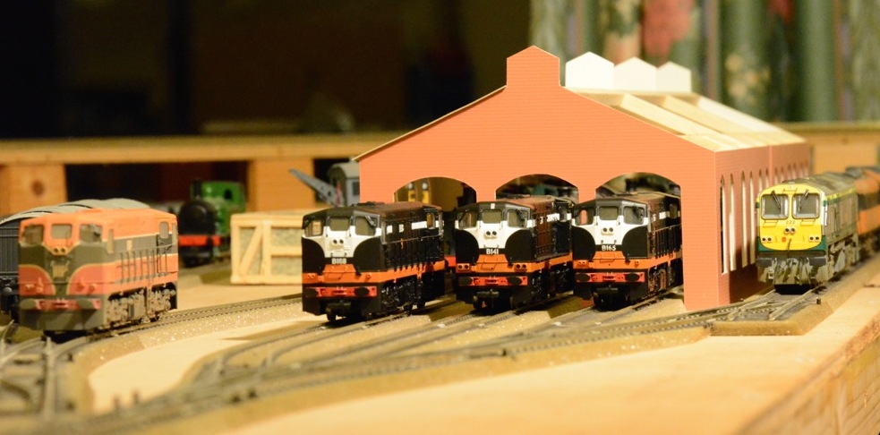

Noel Posted April 15, 2015 Author Posted April 15, 2015 (edited) The D class thread reminded me how much I like the older black and tan livery on CIE locos PS: Yes I will finish the engine shed one of these days Edited July 21, 2017 by Noel

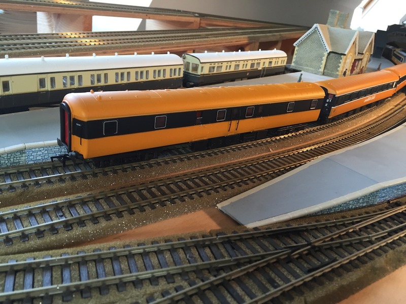

Noel Posted May 20, 2015 Author Posted May 20, 2015 (edited) Supertrain EGV arrived today from Marks sale. The model has some small flaws but not as bad as I had feared nor some of the rumours suggested. €46 in the sale made it attractive, however had it cost €56 I might not have been as content. Looks ok behind IE/IR Mk2d's. I understand some IR/IE tippex rakes ran with ST livery EGVs for a period before they were all repainted. The colour is 100% identical to the IE/IR livery. The roof ends are very slightly separating from the body but easily tacked down with super glue. The black lining is straight but the edges are not sharp and have very slightly fuzzy edges. The black band wrapping around the coach ends narrows slightly instead of remaining parallel with the black bands on the edges. But these are not obvious and survive the 3ft viewing rule. I have to decide now to either leave it as is, or spray tip-pex white lines on it which will eliminate the fuzzy black edges. Edited July 21, 2017 by Noel
Noel Posted May 23, 2015 Author Posted May 23, 2015 Inspired by recent visit to Glenderg's workbench, I have decided the EGV will need to be resprayed.
DiveController Posted May 23, 2015 Posted May 23, 2015 (edited) Inspired by recent visit to Glenderg's workbench, I have decided the EGV will need to be resprayed. You're doing a total respray after your visit with Richie? I did notice that the orange color on the ST EGV wraps round onto the back of the coach and I was wondering what you were going to do with that. Tranfers seem to the the way to go for the white lines Edited May 24, 2015 by DiveController typo
richrua Posted May 23, 2015 Posted May 23, 2015 Might get an egv myself. Handy enough way to get one , plus I haven't got any at all
Noel Posted May 24, 2015 Author Posted May 24, 2015 . . . Tranfers seem to the the way to go for the white lines Hi Kevin Not for me. Will paint the white lines. Noel
Dhu Varren Posted May 24, 2015 Posted May 24, 2015 Hi KevinNot for me. Will paint the white lines. Noel Have to agree with Kevin, if it is the Tippex livery, then transfer lining is the only option to get a decent consistent line. The earlier single white line above the windows is doable by painting.
201bhoy Posted May 24, 2015 Posted May 24, 2015 Rake of mk2s looks really good in the curve of that platform! Can't wait to see Kingsbridge progress!

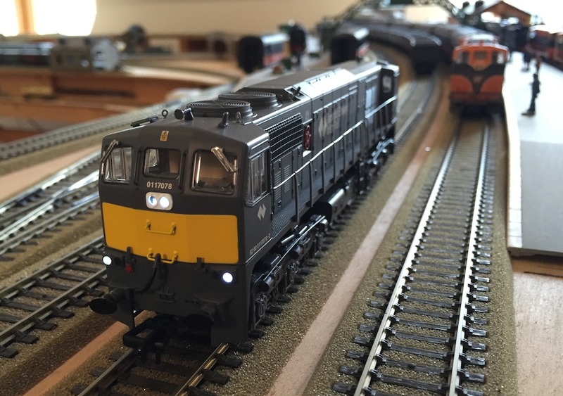

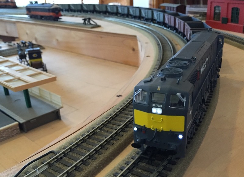

Noel Posted September 14, 2015 Author Posted September 14, 2015 (edited) The superb photo on the 071 loco-080 thread thread inspired me to unbox and chip 7078 today and pop it on the layout. The layout has been a bit neglected during the summer break, but hopefully now tooled up with foam, plaster and static grass tools will make some progress this winter. 7078 unboxed today from Mark's earlier summer sale 7078 pulling a rake of mineral wagons Notice how different the white balance effects the colour of the yellow panel in the two photos!!! Edited July 21, 2017 by Noel
