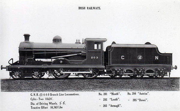

Right ye asked for it! The U class:
Built by Beyer peacock in 1915'
No.196-200'
Second batch
Built by Beyer peacock in 1947'
No.201-205
Third Batch
Built by 00 Works in 2016
Sorry Harry , I couldn't resist .
Can I suggest a tempering of expectations here?
- The joints on the boiler appear to be too few
- The dome looks slightly too large
- the rivet detail underneath is missing
- Pipework on the sides is absent
- some roof detail is missing on the cab
- complete absence of rivet detailing on the tender.
- valve doohickey in front of cab centre and associated pipework absent.
I'd want a bit more detail before I shelled out €400 on a loco. I assume this a "first run" cad and more is to come?

The response to my enquiries from the company
"The image on the web is CAD, and is a good image of what we will produce.
….due to low volume of production, its not super detailed ,but the customer can add further detail to their own speck if they wish to.... there isn't any riveting on the tender again due to manufacturing techniques"
It seems like what you see really is what you get here, so it is definitely a nice model but probably a little less than I would have hoped for
(at twice the price or a good rtr like MM 141/071 class)

Sounds a bit like 'sure it'll be good enough for the Irish lads'.
. . . Reckon I will not be parting with my hard earned for either of these models
It's a pity they would not go the extra mile when they have a model which is almost there
Agree. Seems over priced for an underwhelming model. My modelling budget will be saved for the 121s.
This is a shame. It's gone from a definite to a see what it looks like thing for me, I think. The rivet detail on the tender tank is quite a distinctive feature of these locomotives - it points to the origin being something other than the worsley works scratch aid parts as the tender rivet details on these is really very good. If the lining and painting is good it still might be good.
It might've been easier to have gone for one of the 1915 locos with a more traditional tender....
Richard.
That has to be one of the quickest deflations I've yet seen in railway modelling, as the disappointment takes over.
