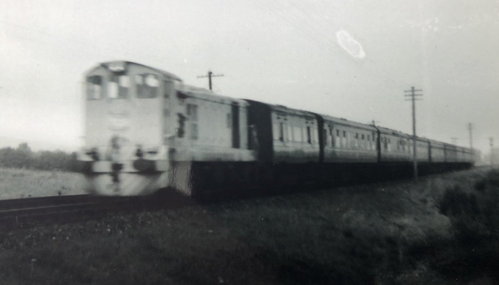

jhb171achill Posted June 24, 2020 Posted June 24, 2020 (edited) jhb171Senior was not known for having any interest in things non-steam (though Donegal railcars were of vague interest). Among his "stuff" is but one black'n'white of a 121, obviously taken in a hurry. The first main line passenger duty they became regular on was the "Enterprise", and this unidentified example is seen on this duty, though I am unaware of the location or date. I suspect it's somewhere in the Portadown - Goraghwood section, as he was doing track upgrading work there at that time. Every carriage and van green.......naturally, nothing would be black'n'tan for some 18 months into the 121's time..... The "Indian Summer" of the "Grey'n'Green" era. Edited June 24, 2020 by jhb171achill 6 Quote
