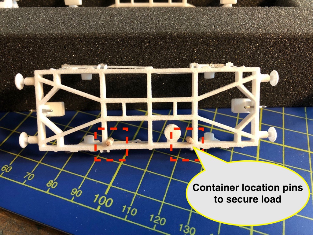

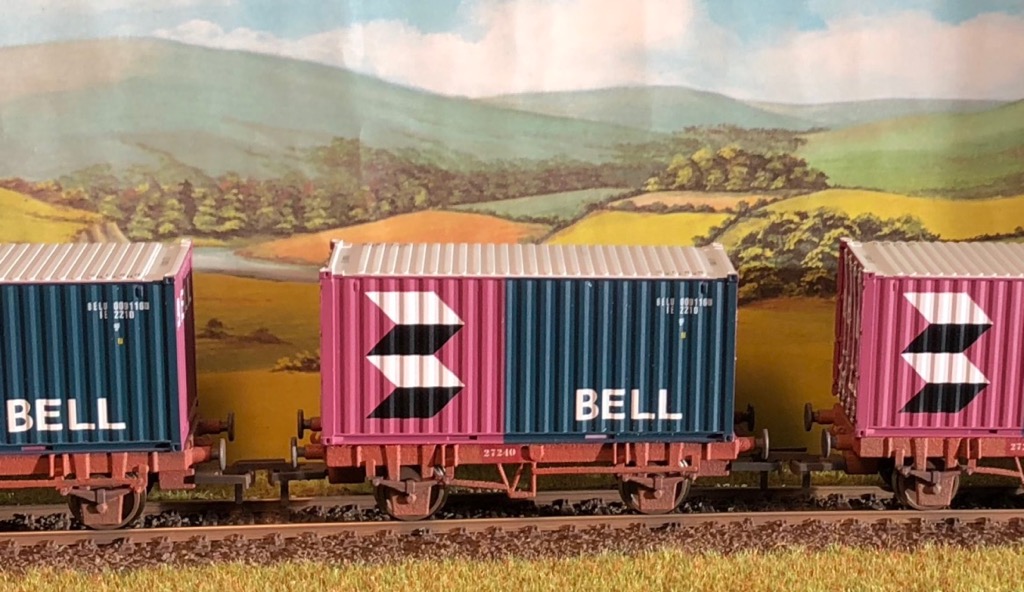

Noel Posted December 14, 2017 Author Posted December 14, 2017 Securing pins to hold containers on wagon and prevent movement. Holes drilled in floor of C-Rail 20ft containers to match and facilities mounting containers in either direction as well as running containers empty. First coat of paint 1 Quote

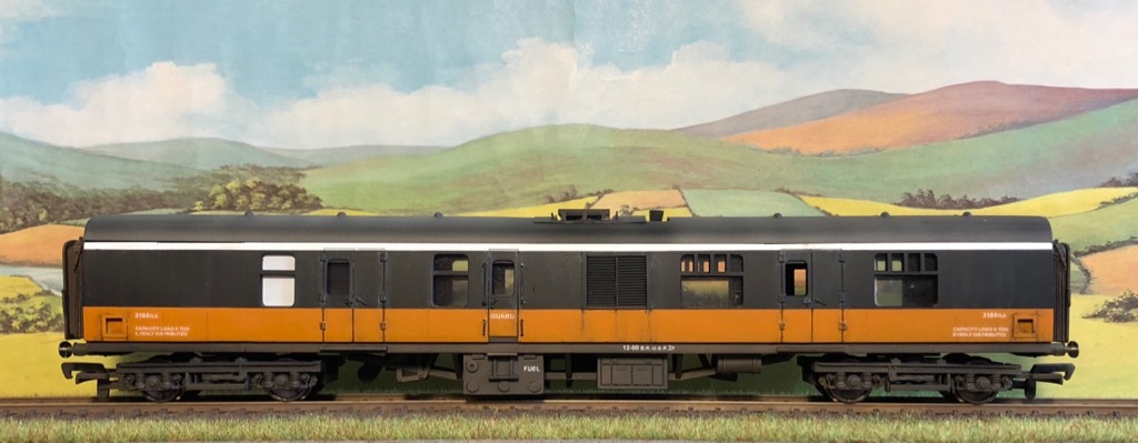

Noel Posted December 16, 2017 Author Posted December 16, 2017 GSV almost finished! Just the water fillers left and a change of couplings to do. Lightly weathered using weathering powders applied both dry and some wet using cotton buds to adjust. Not too heavy as back in the CIE single stripe B&T era they were kept reasonably clean unlike the later IR/IE era. Gloss varnish ready for SSM waterslide transfers, applied the decals using decalfix, then finally matt varnish to seal. I will lightly weather the sole bar and undersides to fade the white decals on the chassis. Shaping and fitting the door grab rails was a challenge with my shaky hands and poor eyesight. Thanks to Eoin's @murrayec advice I filed off the moulded plastic ones. Reasonably happy the way it turned out for a first GSV conversion. Next up a Bachmann BCK conversion to maroon 3173 hopefully over the Christmas holidays. What I've enjoyed most is learning from the mistakes I made along the way. 6 2 Quote

Noel Posted December 16, 2017 Author Posted December 16, 2017 Thanks guys for the kind and encouraging comments. Will post a pic in natural light tomorrow and perhaps a video clip. It took a lot longer than I'd thought when starting out but enjoyed every bit. Looking forward to trying 3173. Quote

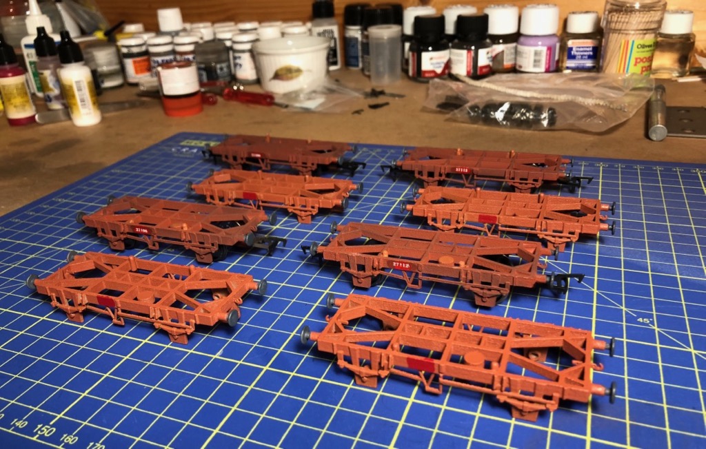

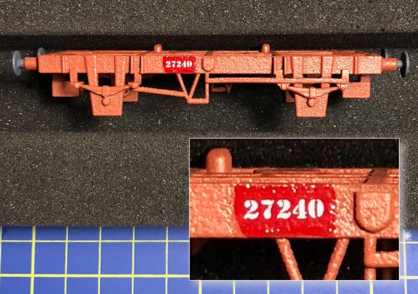

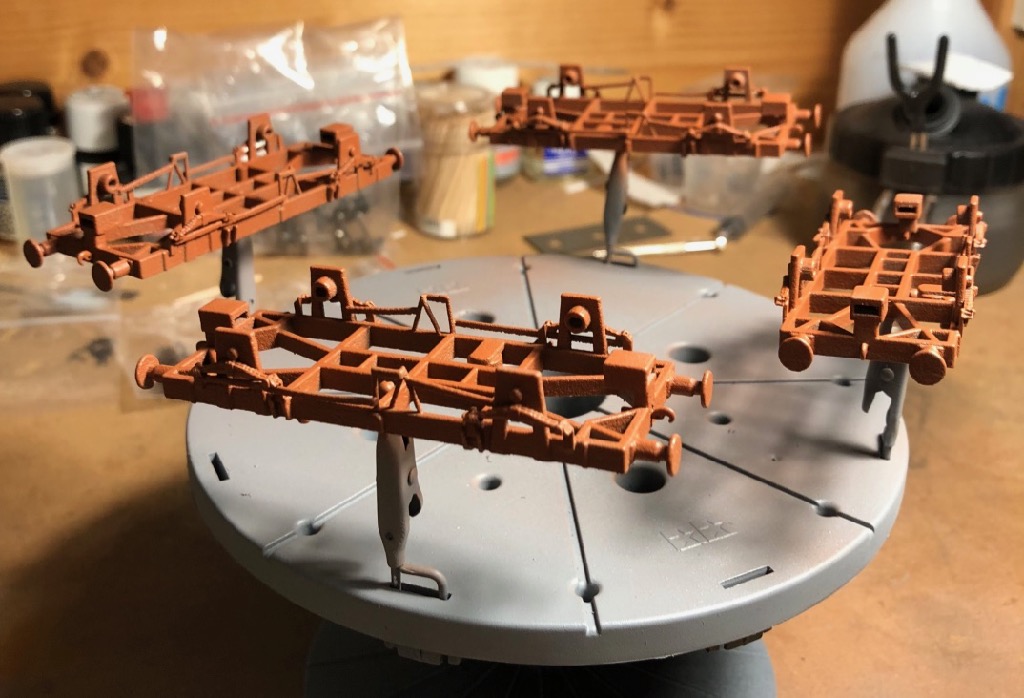

Noel Posted December 19, 2017 Author Posted December 19, 2017 Work continues on the 20ft skeletal container wagon rake. Four more painted bauxite (railmatch acrylic 235). They are awkward to airbrush and waste a lot of paint due to the need cover all the shaded angles of the skeletal chassis. Ready for decals and weathering. These will be used to haul C-Rail 20ft Bell containers in mixed goods traffic formations behind B&T locos. The 3D kit was supplied by ifm and is quick and easy to assemble. 1 Quote

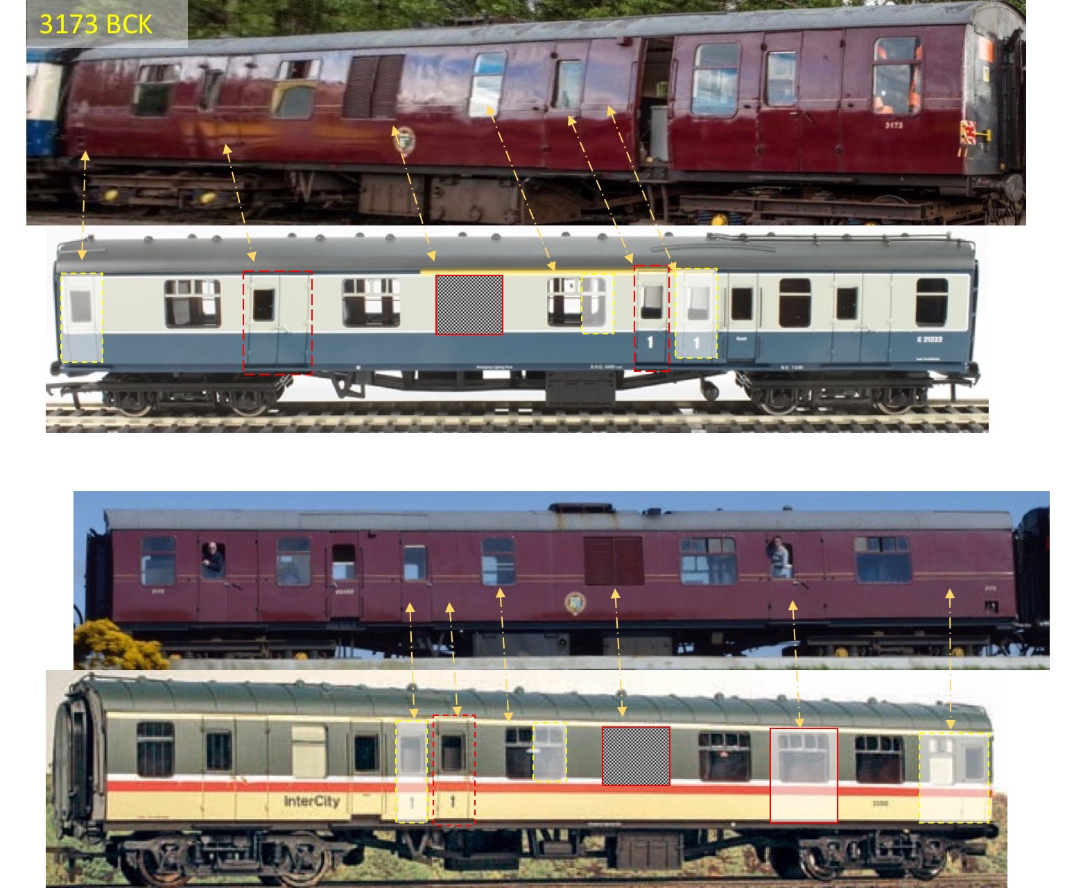

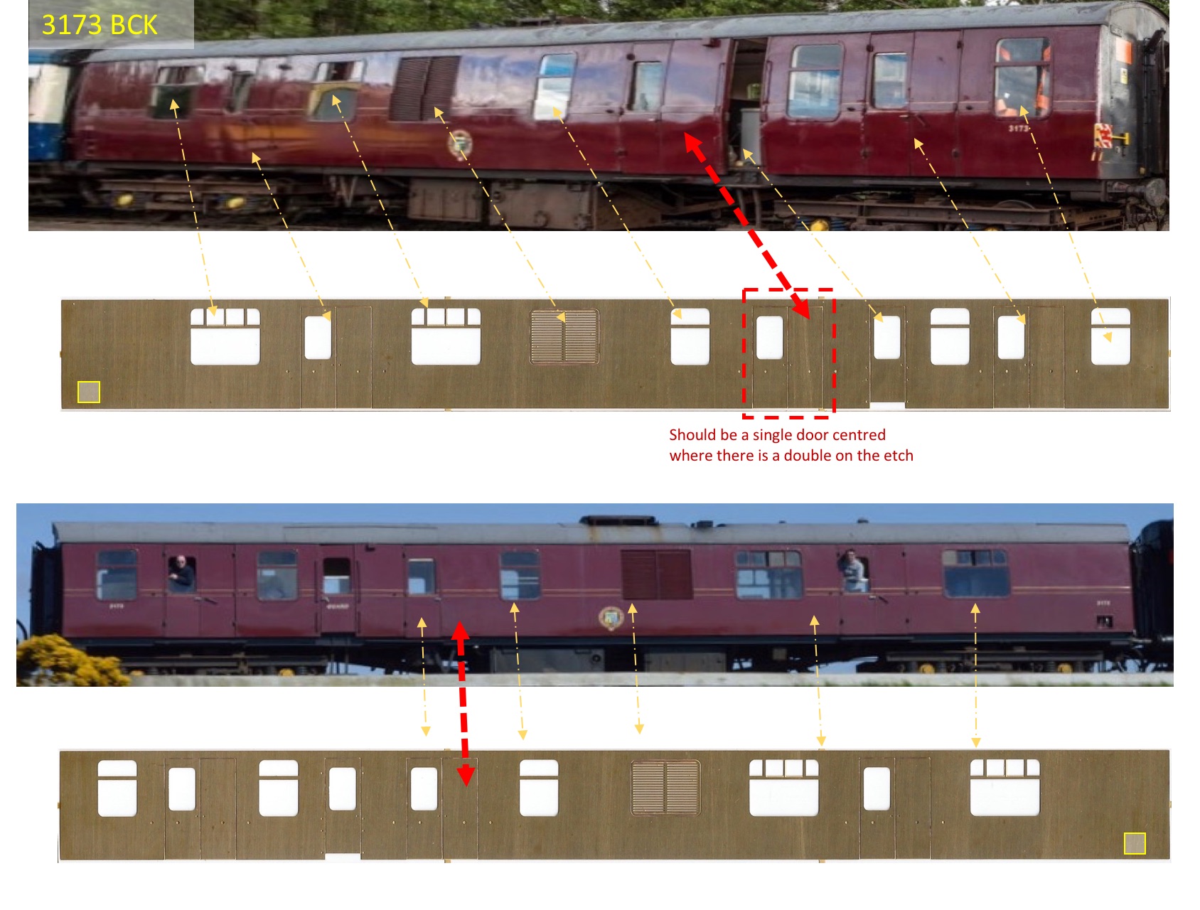

flange lubricator Posted December 20, 2017 Posted December 20, 2017 The Bill Bedford overlay has the correct door arrangement for the ex bck as used by CIE/I.E. the RPSI may have closed the double door during its overhaul in RPSI ownership. Great work on the recent BSK conversion . Quote
StevieB Posted December 20, 2017 Posted December 20, 2017 Good as it is, the Bill Bedford is overlay is inaccurate in that the double doors next to the guard’s door should be closer to that door by one door’s width. If you look at the BCK next to the overlay, you’ll see what I mean. The blank door of the pair is where the 1st class passenger door was. The RPSI BGSV has lost this blank door during the recent renovation. Hope that all makes sense. Stephen Quote
Noel Posted December 20, 2017 Author Posted December 20, 2017 (edited) Thanks Stevie. Two photo sketches below showing mapping of BCK to GSV 3173 layout a) brass sides b) Bachmann BCK donor. At the moment I am leaning towards the plastic option of cutting and splicing Bachmann BCK donor sides rather than the brass which seems rather featureless. Bill Bedford sides Bachmann BCK donor Edited December 20, 2017 by Noel 3 Quote

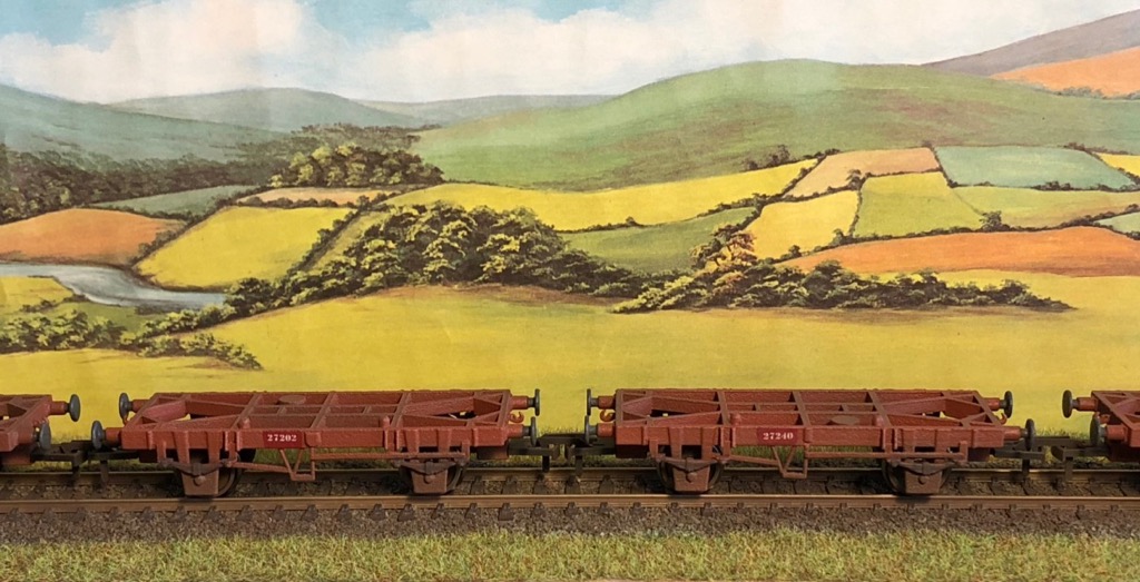

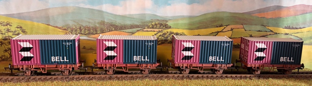

Noel Posted December 23, 2017 Author Posted December 23, 2017 Finished the 20ft Bell container wagons. Coat of frame dirt for the wheels. Then a bit of light weathering for the wagons and springs. They look better dulled down with a bit of light frame dust Drilled the bases of the C-Rail Bell containers with four holes and tested each containers mounting holes aligned with every wagon. A fun and very simple kit to put together. Happy the way they turned out. Will post a video of the full rake in traffic at some stage. The Bell's themselves are now due a visit to the paint shop for a very light dusting to get rid of the clean 'toy' look. 3 Quote

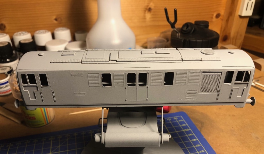

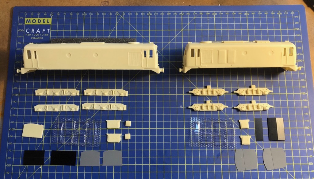

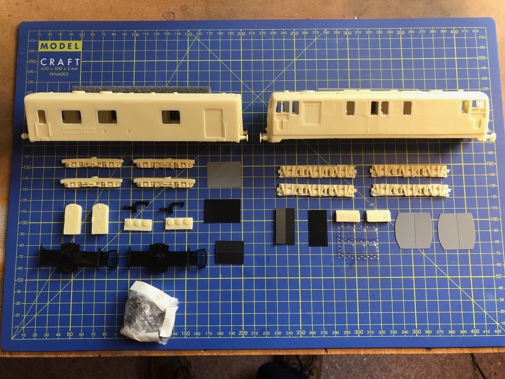

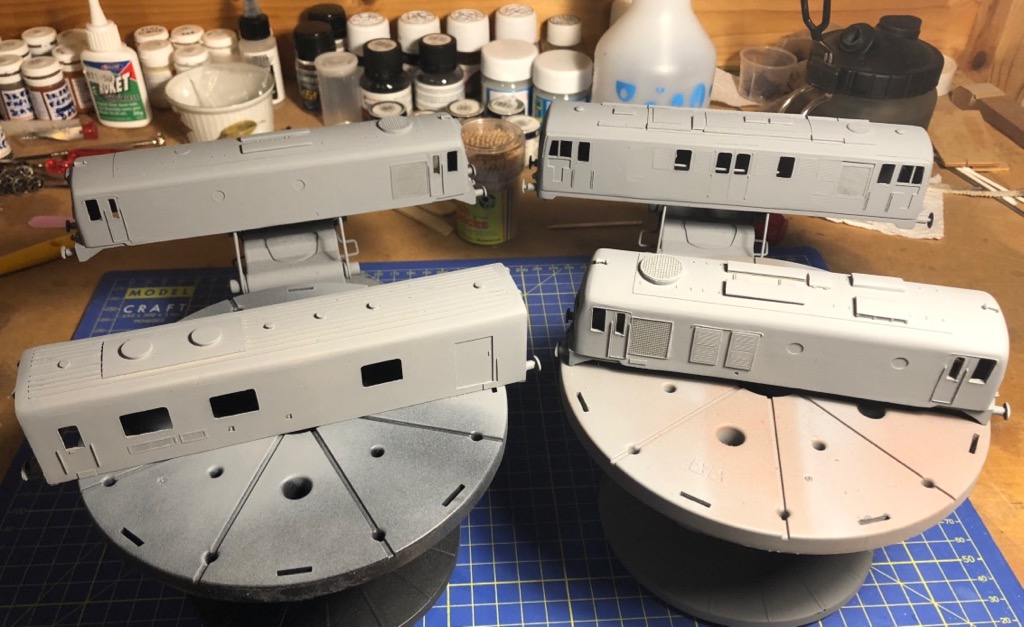

Noel Posted January 27, 2018 Author Posted January 27, 2018 Next up on the workbench will be some Silverfox resin kits I've collected over past year or two. A class B&T livery (rebuilt stepped orange band) - 071 donor chassis C class flying snail green Eau-de-nil livery - 141 donor chassis Sulzer 101 class flying snail green Eau-de-nil livery - Bachmann donor chassis (BR cl 24 sound project) Dutch GSV - RPSI green to run with their mk2 rake These may take some time. Will start by doing some of the common work on all four in parallel to save time. Then its cut'n'shut time for some centre drive donor chassis. Silverfox A + C class kits Silverfox Dutch GSV kit + B101 class Sulzer kit due for 'eau-de-Nil' flying snail green livery That'll keep me busy for a while 2 Quote
Robert Shrives Posted January 27, 2018 Posted January 27, 2018 Good luck ! A large amount of work but I am sure end will be first class. Like you I have A to work on which will give the office lads time to procure the RTR one !!! Certainly the luxury chassis plan will give lots of power ! I think Kirley has contact for lovely whitemetal side frames for the A class which will really help. robert Quote
Noel Posted January 28, 2018 Author Posted January 28, 2018 Four started. Spent a few hours removing flash and preparing these before first stage prime using Halford plastic grey primer in the spray booth. A few hours filing and sanding, but the resin bodies were in pretty good shape, mainly work to tidy up around the windows and buffer beams. The SF B101 sulzer will be first to get attention as next before any more painting there is the matter for fitting a cut'n'shut 071 donor chassis and figuring out how I can transfer the lighting from the 071. The chassis will need two cuts to shorten it each side of the motor so the cardan shafts will still be long enough to allow both bogies move freely when she goes around bends and over points. This is when it starts to get exciting . . . 1 Quote
