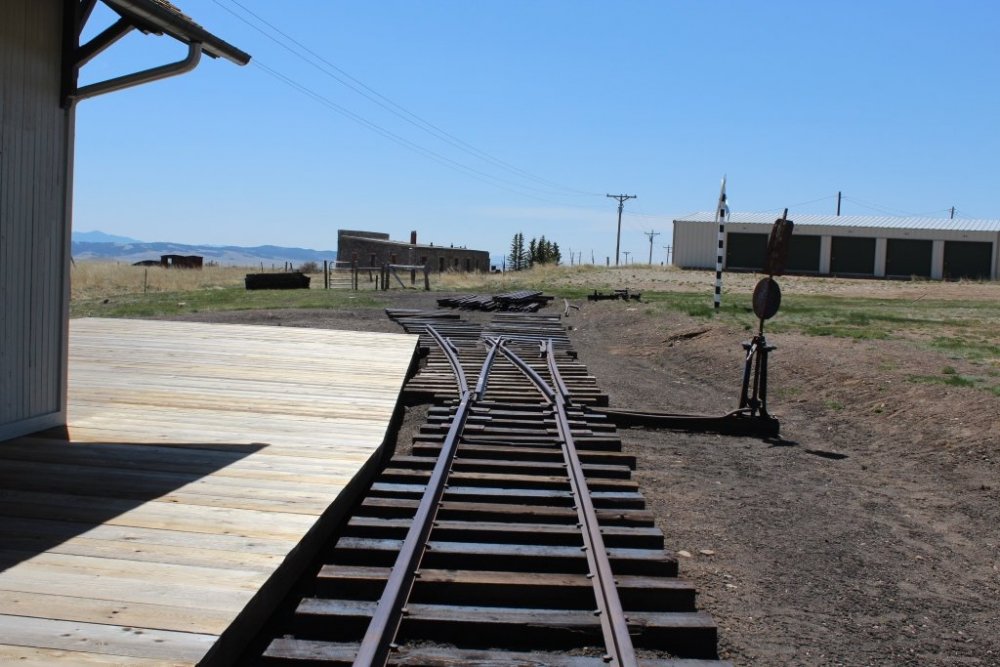

0 Mayner Posted March 19, 2020 Posted March 19, 2020 6 hours ago, Ironroad said: The track used by US O scale 36" narrow gauge modelers is On3 which is 19.2 MM gauge and there is at least one producer in the US of this track in 1m flexible lengths and they also supply left and right points (no 6 which are 9.5 degrees at the frog-same as Peco code 83 whereas Peco code 100 and code 75 points are 12 degrees at the frog) While this is still not 21mm it is a lot better than 16.5 mm gauge and even better that EM or Scale4 for the purposes of representing Irish broad gauge in OO scale. And I'm curious if anyone has considered this and what the pros and cons may be. As to the proportions of the rail and sleepers. I have not seen or inspected this product personally but the rail is advertised as code 100 which is the same as most of us are already using. I would note that while code 75 maybe preferred by some I think code 83 is closer to the Irish standard. As regards the sleepers, since the sleepers of prototype narrow gauge track were/are proportionally smaller than the sleepers used on standard gauge or broad gauge track I suspect the proportions of On3 track may be acceptable. American 3' Gauge track. Como Colorado Cumbres and Toltec Scenic Railroad Irish Broad gauge jointed track flat bottom rail on baseplates. 3 1 Quote

0 Mayner Posted March 19, 2020 Posted March 19, 2020 (edited) 8 hours ago, burnthebox said: Hi guys & many thanks to one & all for your efforts in trying to get me to the tracks for my layout, now I didn’t expect anyone to go comparing COUNTRIES. !! I’m only going to build a MODEL LAYOUT!! What I’m looking for is the kind of information like gauge, appearance, looks etc. in my case it’s oo gauge, if it be Peco code 75 or 100 Bullhead or Hornby whatever so be it, & I’m not looking for perfection. !! I’ll say right now I don’t know what this “ Bullhead “. thing is...! so maybe the wise ones on here might fill me in on the difference between code 75 & code 100 Bullhead, if there’s any difference, TIA TO ALL BTB I would ignore most of the thread apart from Noel's & NIR80s replies of 29th Feb and 1st with photos of Peco HO and Bullhead track on their layouts. Peco track systems are the standard for mainstream use in the UK and Ireland as they are robust and relatively simple to use and the large selection of points, crossings and accessories. The Peco Streamline HO (Code 100) is probably the best option for someone building their first layout as it is fully compatible with their fixed geometry Set Track System. Set track curves and straight track can be useful if space is restricted or if you want to experiment with a track layout without having to cut flexible track. I would avoid using small radius set track or Hornby points and recommend using medium or large radius points rather to achieve smooth and reliable running particularly with large diesel locos like an 071 and 201 and bogie coaches and wagons. Two foot is the minimum recommended radius for OO gauge, No2 or No3 radius set track curves should be used if you are not able to achieve a 2' minimum. The Peco HO/OO Streamline (Code 100 rail) system was introduced in the 1960s as a compromise system suitable for OO (1:76) and HO (1:87) scale as a universal track system suitable for British and international use. The Code 100 rail section was considered "fine" by the standards of the time but is larger than scale for most rail sections used internationally and the Continental HO sleeper size and spacing is incorrect for both British OO and American HO Scale. Peco H0/OO Streamline Fine (Code 75) system was introduced in the 1990s in response to demand for a finer more accurate rail section by both OO & HO users. There is little to choose between the original Code 100 & 75 systems in terms of durability, ease of use and range of points, crossings and accesories. Peco have since introduced an American HO Code 83 scale track system in response to competition from American track manufacturers and British Bull head track systems in response to increasing demand for a OO gauge track system from the scale end of the UK market. The American and Bull head track systems may be less suitable for an experienced user or someone with a restricted space than the the Streamline HO system. The track may be more fragile to work on than the earlier systems and a larger space may be required to build a layout as the points in the American and Bull Head track systems based on full size railway geometry rather than the small, medium and large radius points available in the Code 100 & 75 systems. Peco Streamline track uses a flatbottom rail traditionally used by railways outside of the United Kingdom. British and the majority of Irish railways used bullhead track with an I beam rail profile for main line track until replaced by flatbottom track from the late 1950s onwards. Irish railways tended to use a mixture of bullhead and flatbottom, with Bullhead mainly used on main lines with the heaviest traffic, with flatbottom used on some main lines incl Dublin-Galway-Sligo and Westport and the majority of secondary lines and branches throughout the country. I Bullhead track & point work Irish standard flatbottom track on baseplates on wooden sleepers Edited March 19, 2020 by Mayner 2 Quote

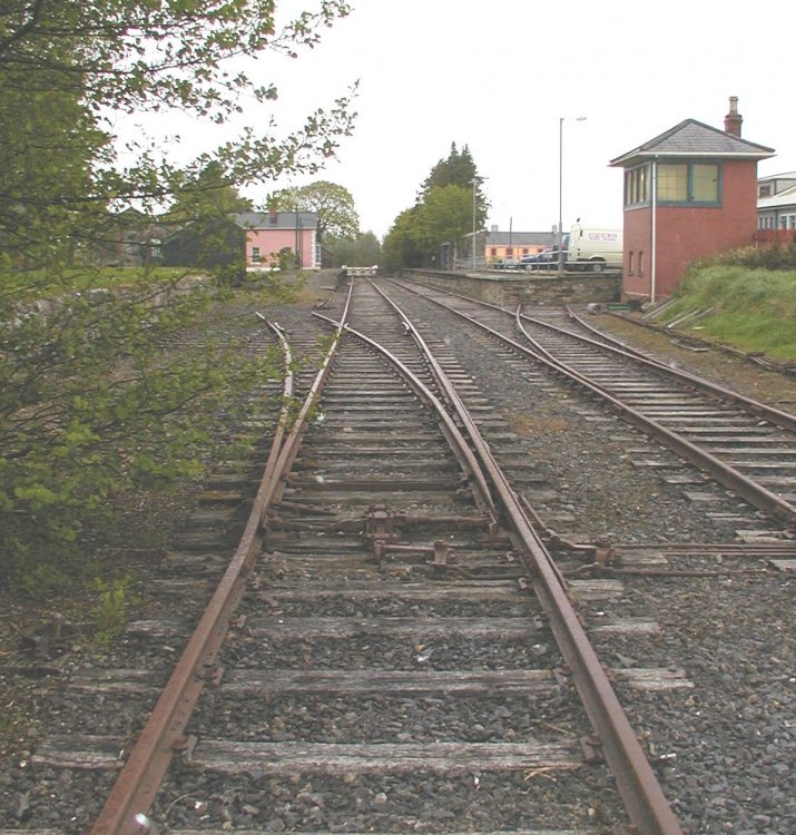

0 Mayner Posted March 20, 2020 Posted March 20, 2020 14 hours ago, Galteemore said: Where’s the Irish pic of, Mayner ? Looks familiar but can’t place it! Kiltimagh on the Burma Road, I have been planning but never got round to building a model based on the station for many years. 1 Quote
0 Galteemore Posted March 20, 2020 Posted March 20, 2020 (edited) Cheers Mayner. It looked Burma Road which is what confused me - it’s so neat and tidy! I remember when all those stations, such as Tubbercurry, looked that way - they are rather greener now... Edited March 20, 2020 by Galteemore Quote
0 DART8118 Posted March 20, 2020 Posted March 20, 2020 2 hours ago, Mayner said: Kiltimagh on the Burma Road, I have been planning but never got round to building a model based on the station for many years. Anything known about the signal cabin? What era or who built it, Any other photos? 8118 Quote
0 Midland Man Posted March 20, 2020 Posted March 20, 2020 Here is an old picture no signal box there. Probably due to the poor quality. There seems to be a level crossing at the far left of the picture and may have been controlled by a signal box? . 1 Quote
0 Midland Man Posted March 20, 2020 Posted March 20, 2020 It says on Eire train s that the cabin was built at the time of the opening of the line in 1895 Quote
0 Mayner Posted March 20, 2020 Posted March 20, 2020 9 hours ago, Midland Man said: Here is an old picture no signal box there. Probably due to the poor quality. There seems to be a level crossing at the far left of the picture and may have been controlled by a signal box? . The photo is of the Swinford end of the station, the gates appear to have been operated by at crossing keeper who lived in the cottage to the right of the photos. The signals and crossover are likely to have been controlled from the signal cabin which is out of view at the Claremorris end of the station. Interestingly the wicket gate was removed and a 3 lever ground frame installed to the right of the buffer stop at some stage after the photo was taken. The frame may have been installed to interlock the level crossing gates with the running signals, so that the signal man could not lower the signal for the section to Swinford or the signals to enter the station unless the crossing gates were open There is another level crossing at the Claremorris end of the station that was operated by the signal man, the gates appear to have been operated by hand rather than from a "big wheel" in the cabin. https://www.flickr.com/photos/152343870@N07/39574108574/in/album-72157713183200497/ Quote
0 minister_for_hardship Posted March 20, 2020 Posted March 20, 2020 The "big wheel" was very much a feature of MGWR cabins, where sited to overlook the road to keep an eye on road traffic. Think a few GN cabins had them too, Poyntzpass(?) I'm not aware of WL&WR/GS&WR cabins having them. Quote
