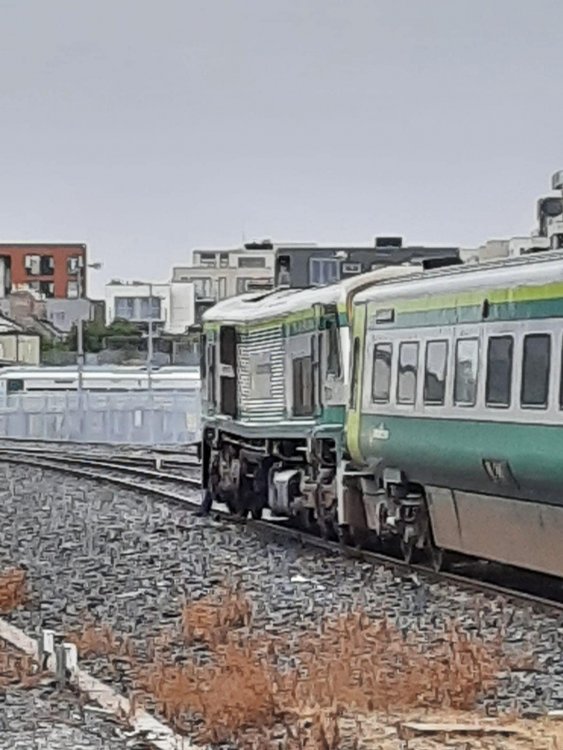

Gortalainn Posted July 8, 2020 Share Posted July 8, 2020 A friend of mine (irishtrains on instagram, for photo credit) sent me this shot last night, taken the day of the incident. Could be just me but it seems it's got a decent bend in the middle? 2 1 Quote Link to comment Share on other sites More sharing options...

Warbonnet Posted July 8, 2020 Share Posted July 8, 2020 It’ll buff out (on Facebook) 1 3 1 Quote Link to comment Share on other sites More sharing options...
Railer Posted July 8, 2020 Author Share Posted July 8, 2020 Looks very similar to how 124 and 134 looked before they were withdrawn. I always thought they had bent frames but clearly not as they were used on everything right up to the end. Quote Link to comment Share on other sites More sharing options...
Noel Posted July 8, 2020 Share Posted July 8, 2020 (edited) 2 hours ago, Warbonnet said: It’ll buff out (on Facebook) Bloody potholes! either that or somebody made a sows ear of putting the decoder in. Edited July 8, 2020 by Noel 1 Quote Link to comment Share on other sites More sharing options...

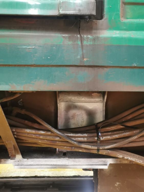

K801 Posted July 21, 2020 Share Posted July 21, 2020 The chassis appears to have cracked under the #2(?) end of the engine above the battery box? 1 Quote Link to comment Share on other sites More sharing options...
Railer Posted July 23, 2020 Author Share Posted July 23, 2020 On 7/22/2020 at 12:36 AM, Ironroad said: But is it an inherent problem, or is it due to impact that wasn't reported? Seems very strange. Apparently it was a metal fatigue defect that was known about from previous exams but the problem accelerated far quicker than expected to the point of failure. I don't know how true that is but it's one of the stories going around. 1 Quote Link to comment Share on other sites More sharing options...

Ironroad Posted July 23, 2020 Share Posted July 23, 2020 6 hours ago, Railer said: Apparently it was a metal fatigue defect that was known about from previous exams but the problem accelerated far quicker than expected to the point of failure. I don't know how true that is but it's one of the stories going around. If that is true is seems to me the whole class is doomed. Not a great recommendation of a GM product and certainly not to be expected in a locomotive that is a mere 25 years old. Quote Link to comment Share on other sites More sharing options...
mphoey Posted July 23, 2020 Share Posted July 23, 2020 32 minutes ago, Ironroad said: If that is true is seems to me the whole class is doomed. Not a great recommendation of a GM product and certainly not to be expected in a locomotive that is a mere 25 years old. hopefully just her affected as none of the rest seem to be showing signs Quote Link to comment Share on other sites More sharing options...

Bob229 Posted July 3, 2021 Share Posted July 3, 2021 According to the railway safety inspectors report the crack was caused by poor weld repairs during maintenance in either 2010 or 2019, IE has now introduced weld repair books to record the location and detail of every new weld as well as adopting the international recognised standard for weld repairs 1 3 Quote Link to comment Share on other sites More sharing options...
