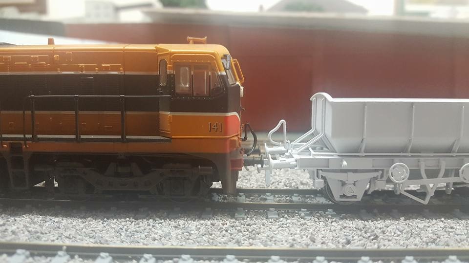

aclass007 Posted August 4, 2016 Posted August 4, 2016 Would it be possible to post a picture of it next a 141 or 071 to get a idea of the size of it? Just like to see how it sits next to a MM loco height wise. I was going to ask the same thing..... But I saw it mentioned somewhere that this sample wagon is on slightly over sized wheels, so it may be sitting a little high next to a loco. Just something to bare in mind, if we get a picture....
Railer Posted August 4, 2016 Posted August 4, 2016 I was going to ask the same thing..... But I saw it mentioned somewhere that this sample wagon is on slightly over sized wheels, so it may be sitting a little high next to a loco. Just something to bare in mind, if we get a picture.... I was wondering that as looking at the side on pictures, the coupling bar looked to me to be sitting very high above the rail height for an uncoupling ramp to engage.
Garfield Posted August 4, 2016 Author Posted August 4, 2016 Taken by a member of the MRSI during our visit yesterday evening:
Railer Posted August 4, 2016 Posted August 4, 2016 That looks superb next to the 141, thanks. The coupling does look to be mounted a bit high on the model to my eye, could be the camera angle though.
iarnrod Posted August 4, 2016 Posted August 4, 2016 Here is a pic of a cement bubble wagon (same chassis) next to a 141 Class loco for comparison. Looks pretty spot on to me. http://eiretrains.com/Photo_Gallery/Irish%20Locomotives/141%20Class/IrishLocomotives.html#168_20050129_001_CC_JA.jpg

Glenderg Posted August 5, 2016 Posted August 5, 2016 If the model is based on CIE drawing No. 468, then the main dimensions and their corresponding rounded conversion to 4mm scale should be as follows, if my calculations are correct : The model is not based on any drawing, as drawings, especially from CIE, are notoriously inaccurate.It is based on a physical measured and photographed survey of a wagon in the North Wall Yard, so I'd hesitate to use any of the dimensions along with a calipers to check. It's a scale representation of the real thing, with the only compromises relating to manufacturers abilities. This is a 21mm wagon on a 00 wheelset, effectively! I'll be getting the wagon later and putting it through the NCT for the coupler height. Richie.

NIRCLASS80 Posted August 7, 2016 Posted August 7, 2016 Have the NEM pocket height been checked for Kadee coupling use??
Glenderg Posted August 8, 2016 Posted August 8, 2016 (edited) Have the NEM pocket height been checked for Kadee coupling use?? See below.... Evening Folks, As we have outlined, this is Engineering Prototype 01 (EP01), concerned with overall appearance, and the look of the model, whereas EP02 generally deals with the business of polishing the tooling to a smooth finish, removing any imperfections, and getting the wheels turned (these are custom to our run) and sorting out any coupling issues. There have been a few concerns raised both here and on social media platforms about coupler height. Since everyone appears content with the overall shape, we chose to tackle this head on. It couples to a 141, but anyone with a track mounted de-coupler would have an issue. In order to resolve it there are four different elements that have to be taken into account, principally: - The centre line of the coupler box is 2.1mm too high, by NEM standards. - The NEM socket is moulded to the buffer beam, so cannot simply be removed and dropped to a chose height. - If there is a substantial design change, then re-tooling must occur, which means a delay in production. This would involve both the ballast wagon, and the cement bubble. - There is a horizontal crossbar for the vacuum cylinders that is in the centre line of the NEM socket. So here’s the condensed version of a very long conversation (72 hours?) amongst all stakeholders…. 01 – If we drop the whole NEM pocket and extend it down to its desired height, it will interfere with the vacuum chamber crossbar, which will require a re-tooling, and create a big lump of plastic hanging from the wagon. Thus all visual finesse will be lost. 02 – We could drop it down, and extend the crossbar downward, but again this would require a retooling, further delay and, well, look nasty. Plus, the crossbar would now be fraudulent. 03 – One of our teams’ stock is fitted with Kadee’s and brought their compatibility to the table, so that has to have a suitable resolution. (We did not find any Alex Jackson Coupling Enthusiasts on our travels…..) 04 – A cranked or swan neck fitting would do the trick, but it is to an older standard and this would leave the NEM pocket in an unsuitable position for Kadee fitted stock. After much discussion, some brain lubrication juice, and calliper activity, we have settled on the swan neck fitting as it keeps production pace steady, does not compromise the visual fidelity of the wagon we bust a gut to achieve, keeps the crossbar intact, and will marry up nicely with your Murphy Model of choice. As for the Kadee issue, it can be mounted directly to the underside of the NEM pocket (you’ll have to file off the IRM stamping, alas) and it fits perfectly between the crossbar and underside of the pocket – a no. 18 or 19 will work. This also lines up perfectly with the Kadee track gauge. Please see photos below. Comments welcome. Richie Edited August 8, 2016 by Garfield
richrua Posted August 8, 2016 Posted August 8, 2016 A lot to digest there! It seems like a perfectly acceptable fix to me. I appreciate that your priority is a highly accurate model.
popeye Posted August 8, 2016 Posted August 8, 2016 Coupling height is always a problem. I find different makers height varies up or down. What i might do is glue a piece of thin plastic under the socket then glue the coupling to that.I do this with other wagons i build and i can keep the coupling from sticking out to much past the buffers.
Noel Posted August 8, 2016 Posted August 8, 2016 Seriously Impressive. Congrats guys. The tension lock swan neck solution seems like the best compromise. Looking forward to planned delivery in 11 weeks. Ps. Any pre-production pics of the load?
