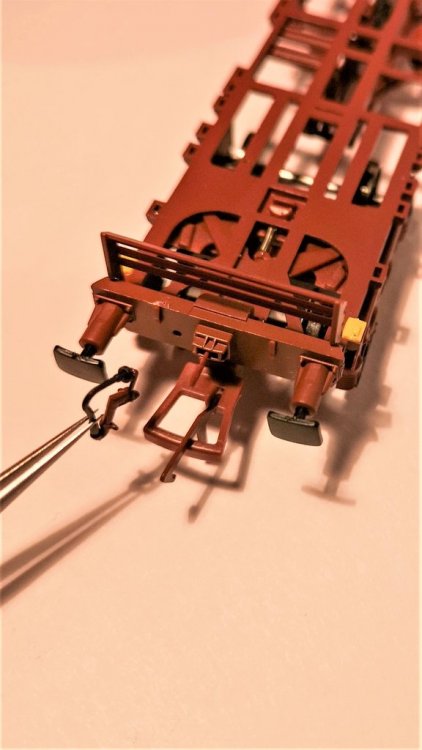

ttc0169 Posted December 28, 2019 Posted December 28, 2019 When fitting the vacuum brake pipe, ensure it is the right way up-not as seen in the photo....the circular dummy plug is always located to the bottom. 2 1 1
DiveController Posted December 29, 2019 Posted December 29, 2019 A triangular spigot and hole would help prevent this (well, nothing is fool proof, but it would look pretty odd)
