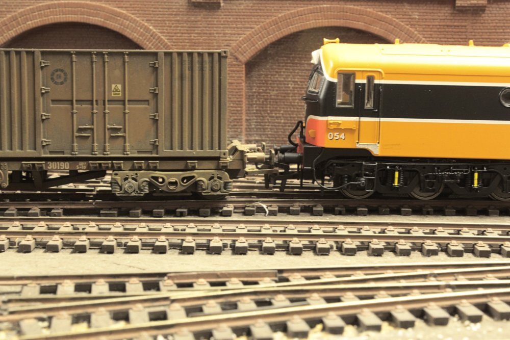

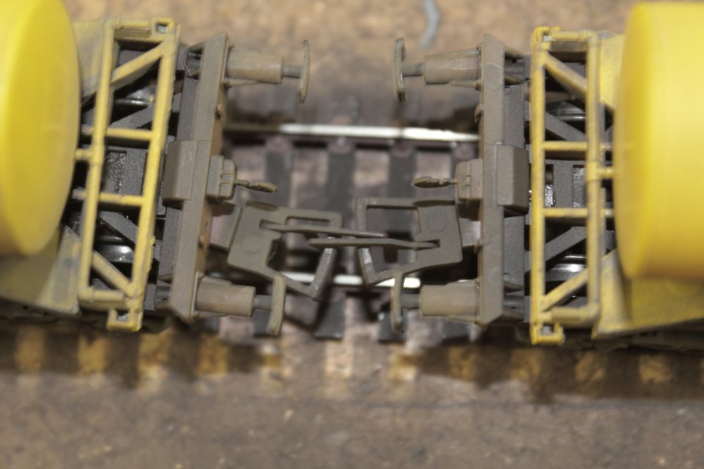

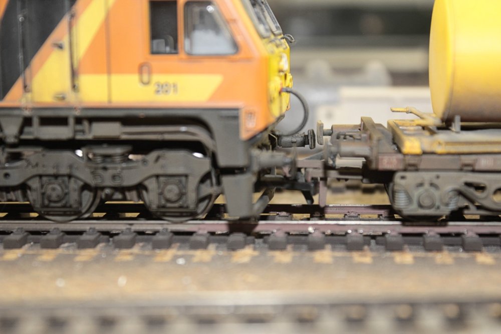

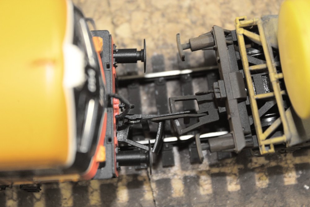

Georgeconna Posted December 31, 2021 Posted December 31, 2021 Well pleased to say lots of shunting about here and there and while the camera was rolling not an item of stock fell off the rails!!. Typical, Anyhow here are some shots of the A Class and 201 Coupling under the 42ft ones plus the couplings not centering. You can see I have some silicon grease is added to the 42's to help this but no luck. I can't figure out why the couplings are not going back to the center. 4 Quote
Dempsey Posted December 31, 2021 Posted December 31, 2021 I noticed similar on some of my own stock of couplings sticking in one direction or the other after curves. 1 Quote
Georgeconna Posted December 31, 2021 Posted December 31, 2021 (edited) Here is some Video, Failed getting into the Oscars so sorry bout the quality, Need more lighting in the cabin. 1st on of a A with Weedy Trains The 2nd one if MK.2 and a mystery uncoupling!! again sorry about the quality, The missus had the only fans set up at the time so had to make do with a manual yoke. Edited December 31, 2021 by Georgeconna 6 Quote
murrayec Posted December 31, 2021 Posted December 31, 2021 @Georgeconna Hi George, I hope you n family had a good Christmas.... I notice in both your videos- in the first one, when shunting backwards the A's coupler is raising up to the point that the latch is not engaged any-more. In the second video, after the loco uncouples one can see that the latch on the A's coupler is still in the raised position> this may be the problem? I would try to limit the A's coupler movement upwards and free up the latch pivot a bit if one can, so that it pivots freely and falls down on its own.... Eoin 2 1 1 Quote

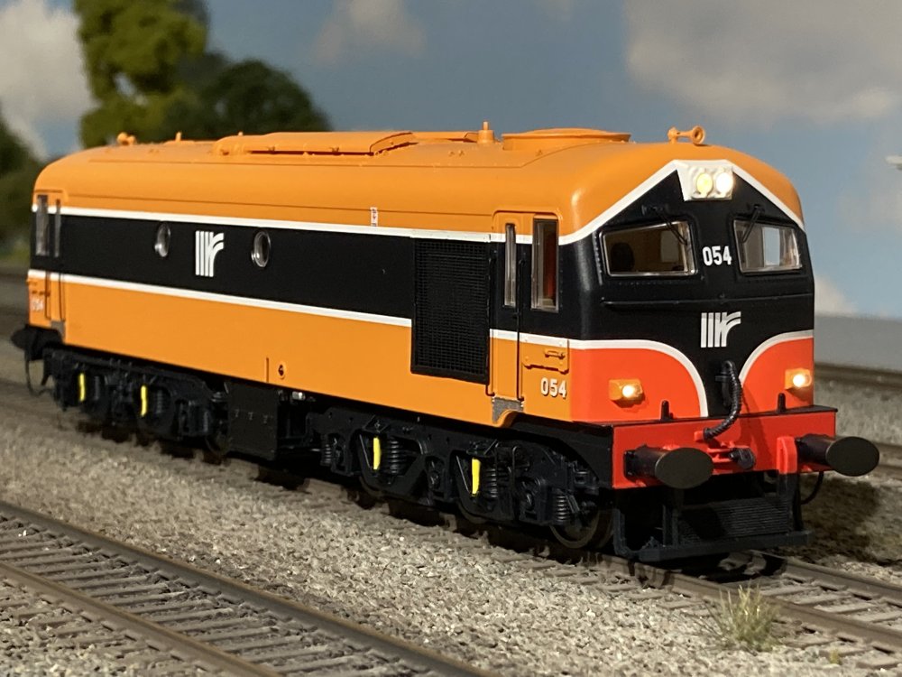

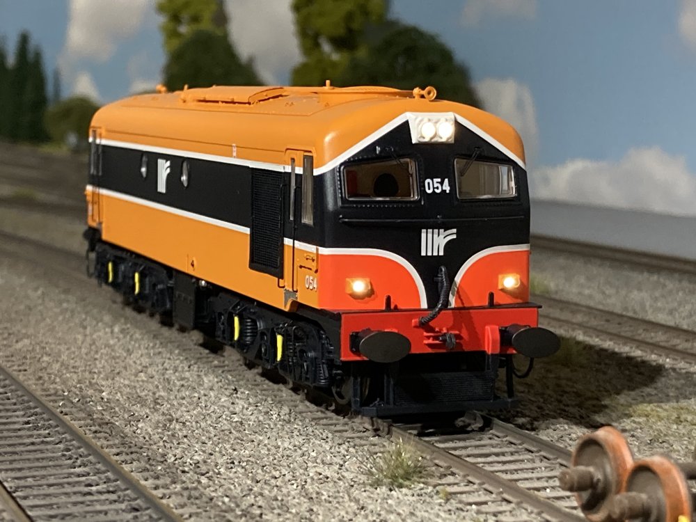

NIRCLASS80 Posted December 31, 2021 Posted December 31, 2021 Massive thanks to my better half for the birthday present in the form of 054! Love the IR A classes. 8 Quote

Georgeconna Posted December 31, 2021 Posted December 31, 2021 9 hours ago, murrayec said: @Georgeconna Hi George, I hope you n family had a good Christmas.... I notice in both your videos- in the first one, when shunting backwards the A's coupler is raising up to the point that the latch is not engaged any-more. In the second video, after the loco uncouples one can see that the latch on the A's coupler is still in the raised position> this may be the problem? I would try to limit the A's coupler movement upwards and free up the latch pivot a bit if one can, so that it pivots freely and falls down on its own.... Eoin It was fully engaged at the start, Just demonstrates the movement of same. I'm not too bother, As Noel says Kaydees would be the bizz.Just need to save up for em. 2 Quote

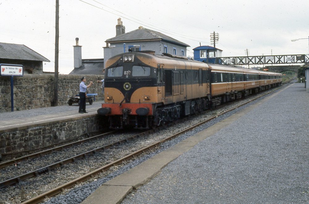

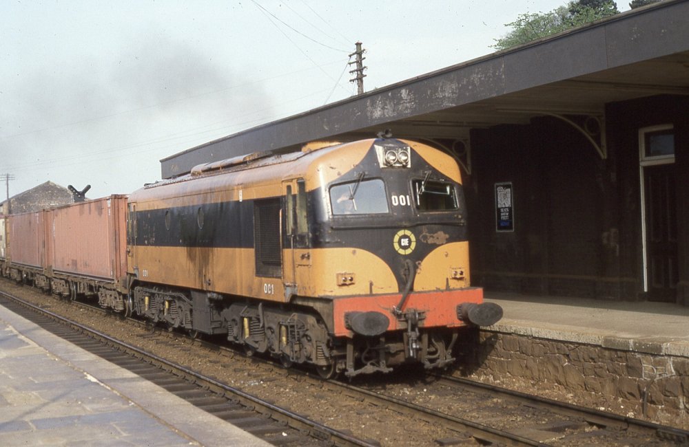

jhb171achill Posted January 3, 2022 Posted January 3, 2022 Weathering of an "A"; who dares replicate this? Lisburn, c.1990; photo by jhbSenior. . Roughly a decade earlier, 001 heads north through Lisburn - photo again H C A Beaumont. . In 1990 and thereabouts, the Rosslare line was one of the few regular turns for an "A" on passenger trains. Photo - self. 11 Quote

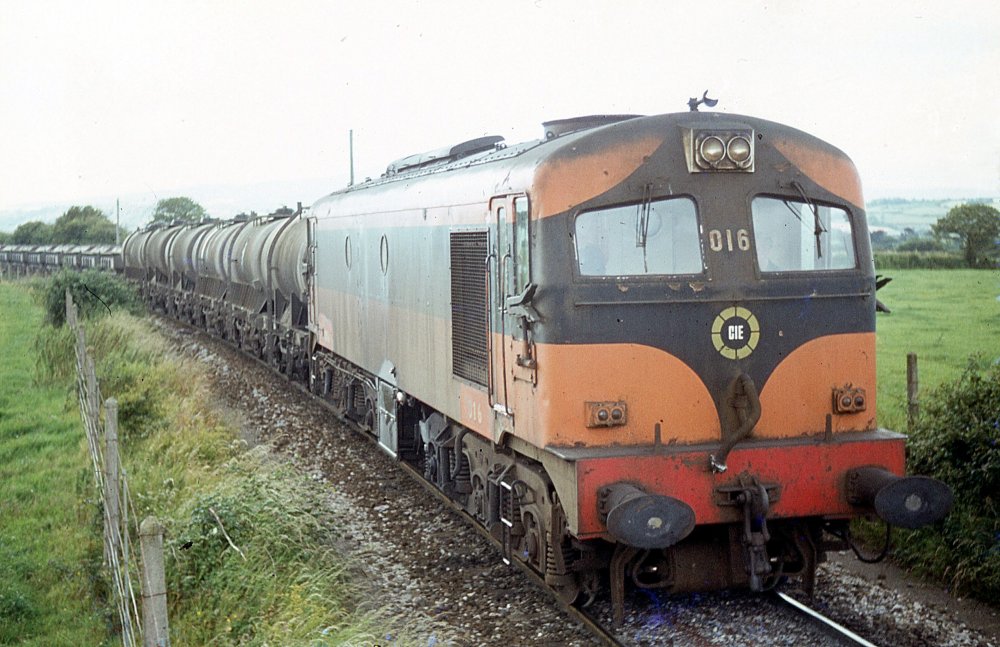

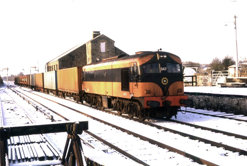

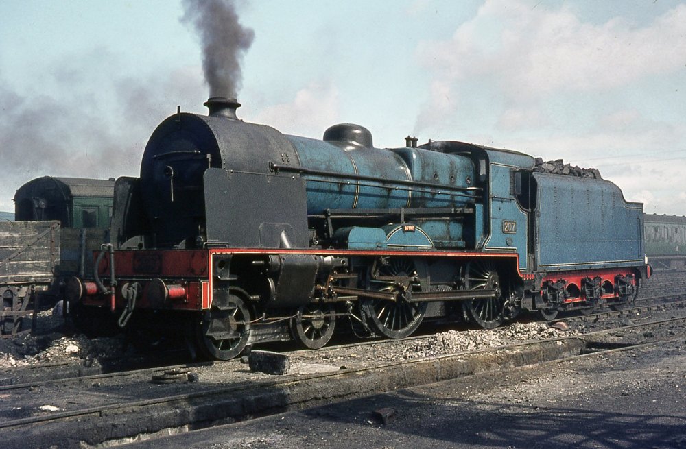

jhb171achill Posted January 3, 2022 Posted January 3, 2022 . This one is undated, taken by Senior. I think it is winter 80/81 but I'm not sure. . This, of course, is what would have interested Senior a great deal more! (Plus me, if truth be told....). His pic, Adelaide 1962. . But back to the diseasels. Senior wasn't down this way too often, so it should be easier to date this, probably late 80s he had a holiday in this neck'o'the woods.. 10 Quote

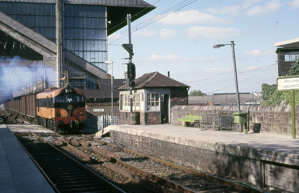

jhb171achill Posted January 3, 2022 Posted January 3, 2022 . Late 1980s, Lansdowne Road, bound for Shelton Abbey, I presume? (H C A Beaumont) 5 1 Quote

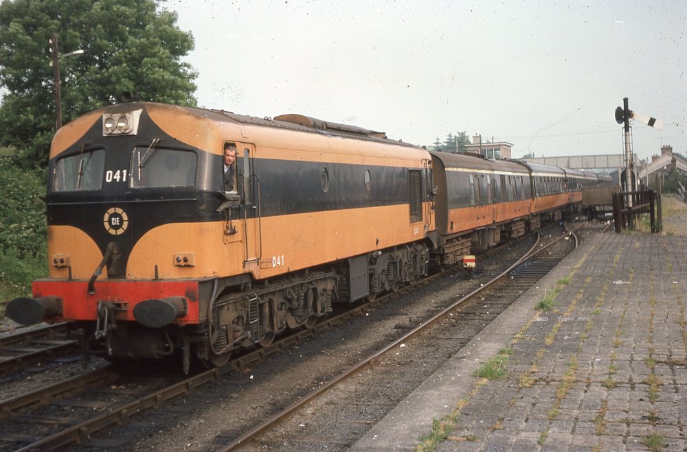

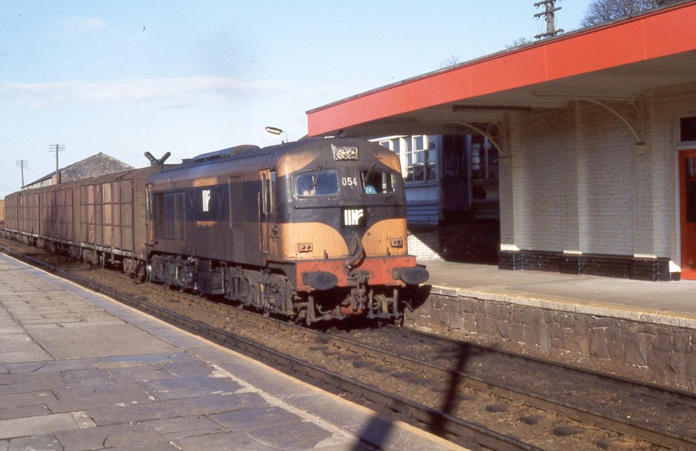

jhb171achill Posted January 3, 2022 Posted January 3, 2022 One for the road. Leaving Westport, July or August 1976. (H C A Beaumont) 8 1 Quote

JasonB Posted January 7, 2022 Posted January 7, 2022 Fantastic shot, Jonathan. 054 looks the business in Supertrain livery with the IR logo. Manky aswell! 9 2 Quote
