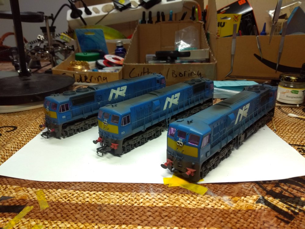

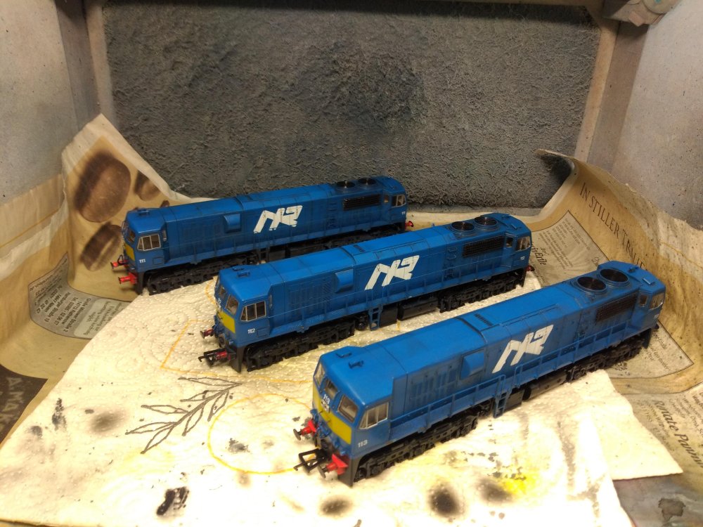

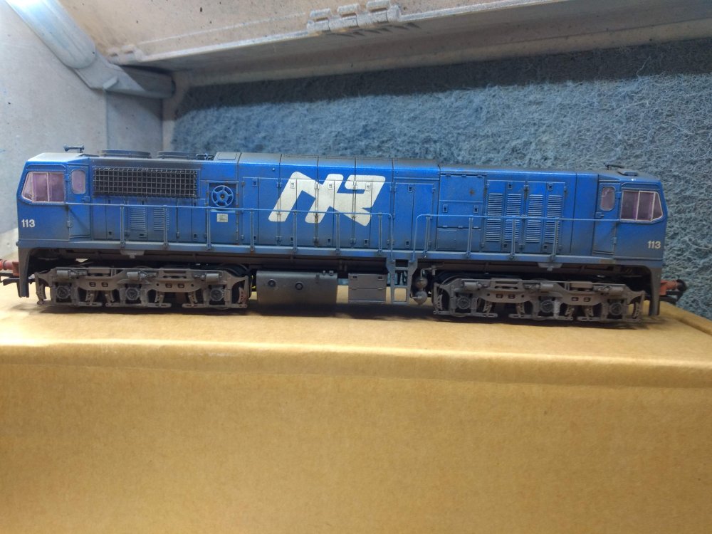

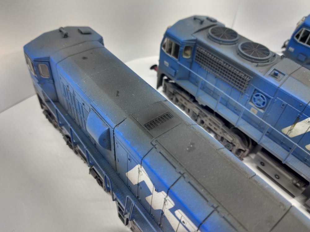

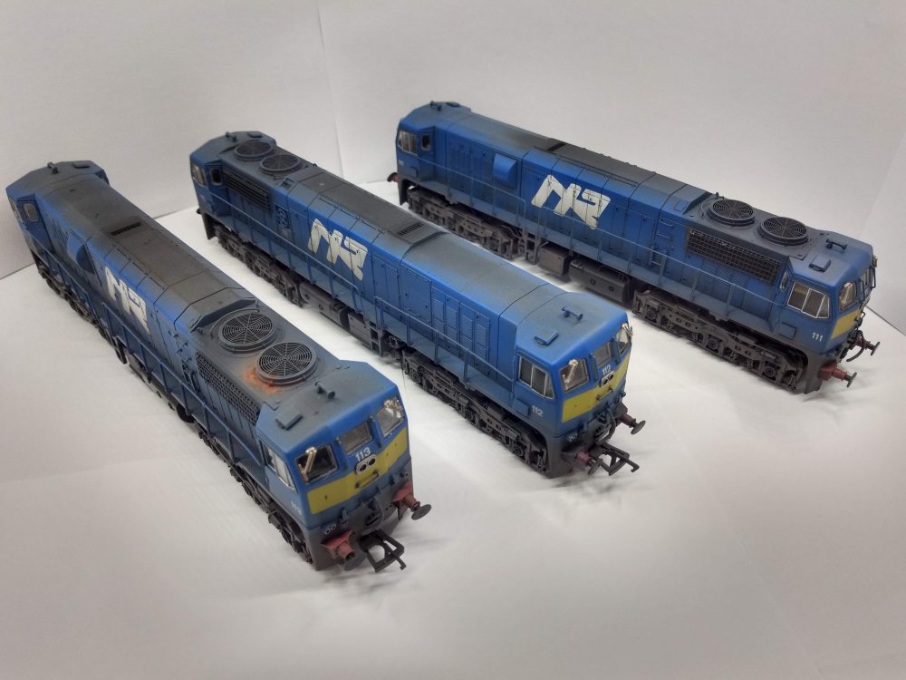

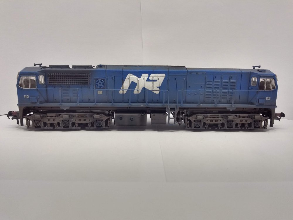

111s all put back together (bar the wipers which will go on at the very end) and first step in the weathering is a grubby enamel wash. I'll let this dry for a few days and clear coat probably, then maybe do some streaking. I don't think I'll go overboard on these. Mainly frame and roof dirt with a few stone chipped rust spots up front. NIR seemed to keep them a little cleaner than IE did at the time.
Beautiful work!! Extra commissions on the way i think!! Im first in the que!!

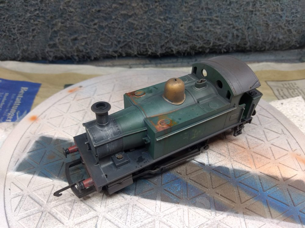

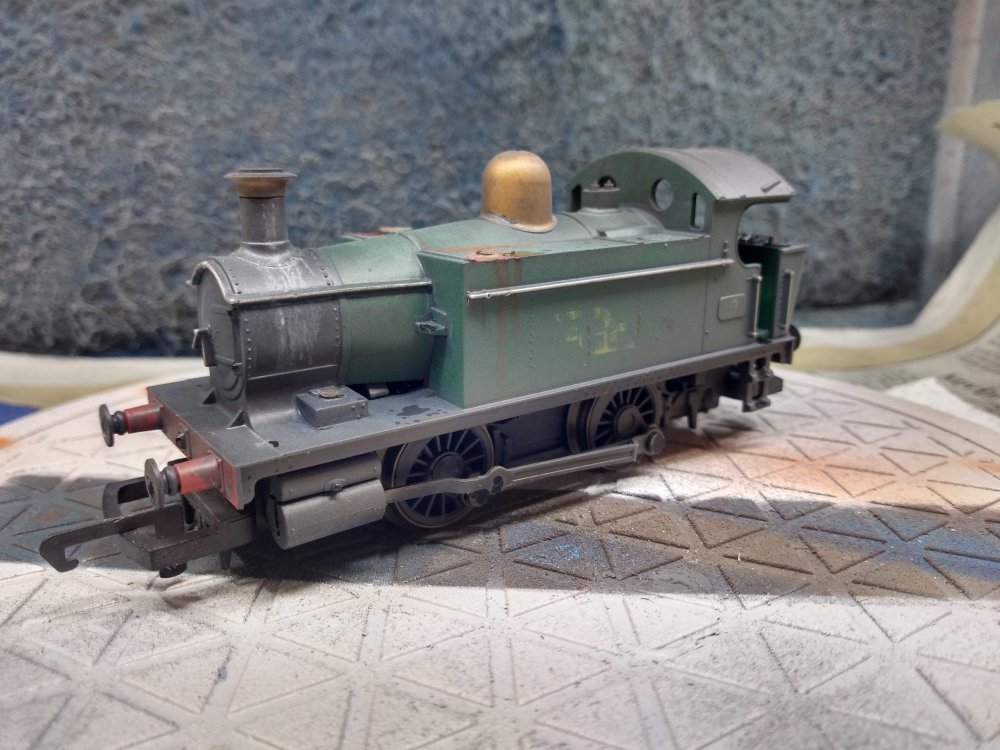

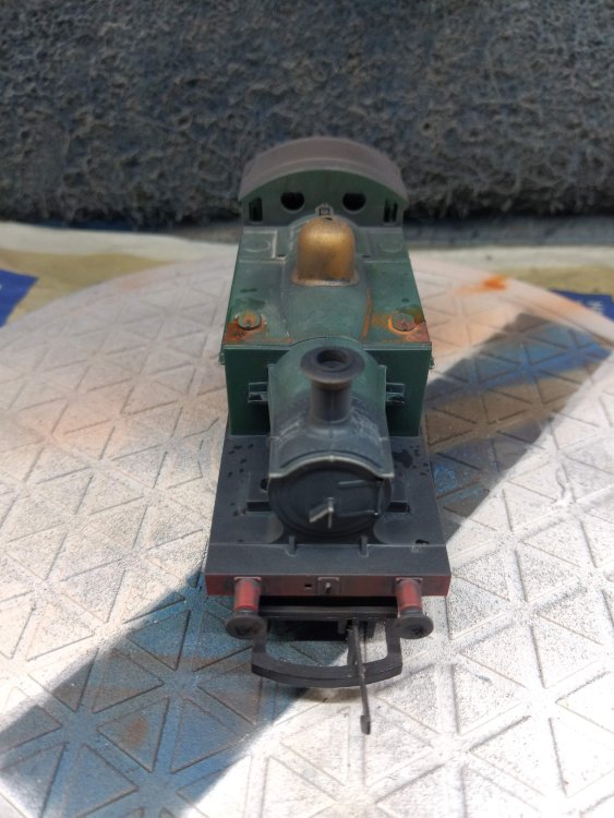

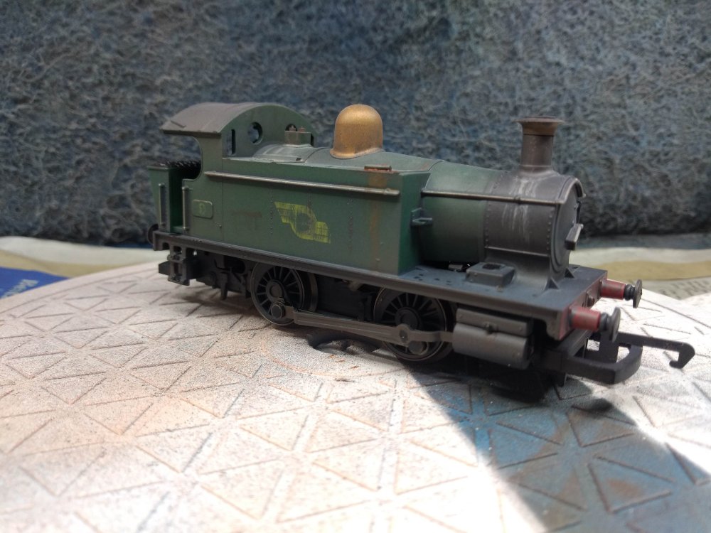

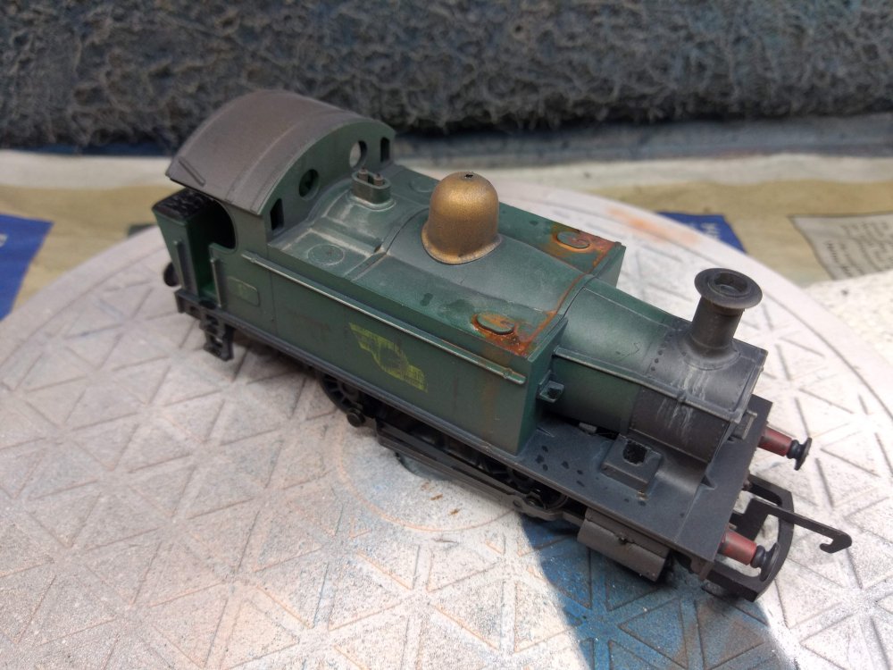

First attempt at weathering a steam loco (kindly donated to science by @DJ Dangerous). As this loco never actually existed in Ireland anyway I felt happy enough to just use some random tank engine pics for inspiration, mainly a couple of Southern ones that showed the water splashes after the loco had taken on water recently. Also the ash streaking or whatever it is that streaks down from the funnel was evident. Another loco had streaking from the whistle, presumably limescale deposits? I have no idea really. I am actually pretty satisfied with the result. It will someday be hauling Genesis coaches in sunnier climes 🙂
I have a full set for one of these, waiting for somone to want to get into modeling for the first time and then sell it to them…..not much use to many of us other then an experiment like yourself (which went extrodinarily well might I add)
Looks excellent.
White stuff is scaling from the water aye
Excellent weathering indeed! And yes, the whitish deposit often found was indeed limescale.

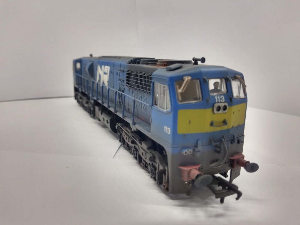

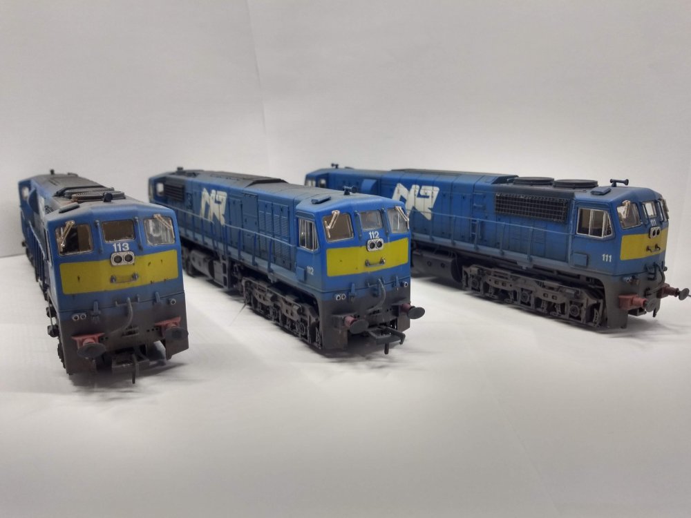

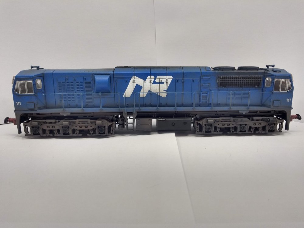

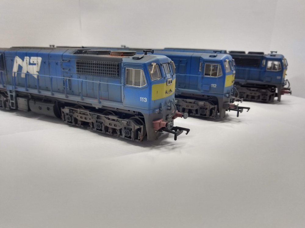

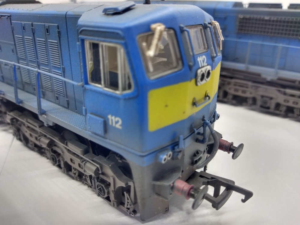

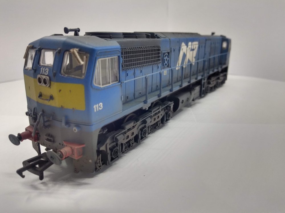

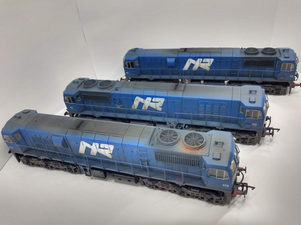

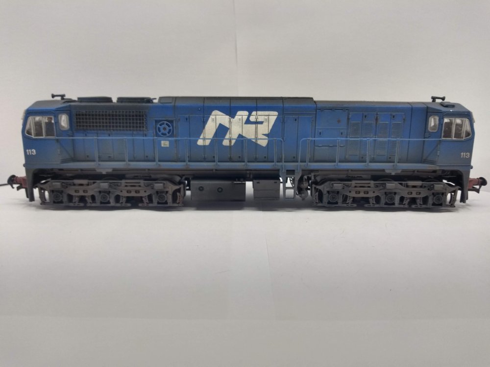

Right, this is the final update on these 111s. They are "finished" now after I applied the glossy touches to the oily/greasy bits like the wheel bearing journals, fuel tanks, exhaust ports etc. Nameplates will someday be applied whenever Steve at Railtec has made them available. Should be trivial to apply them and weather lightly then. I didn't want to leave them in a million pieces waiting for them to arrive. This has been my most ambitious respray with a number of false starts and dead ends. I probably stripped these locos back to plastic three times, including after having applied the transfers as I was so unsatisfied with the large logo as a transfer. That sent me down the path of laser cutting out masks and I learned a bit from that too. In the end though I am really pleased with how they've turned out. IMG_20230123_141011141_HDR.thumb.jpg.931b20a7888f6dbf57d1019e98dded57.jpg
Brilliant from start to finish
  • Agree 1
Well done Phillip, again, they look fantastic. You're a bit of a dark horse with the the oul weathering. 👍
